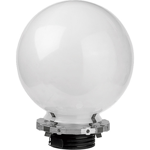

Canon Digital Photography Forums
P.O.T.N. SUPPORT SHOP IS OPEN, check it out now!
Go Back   Canon Digital Photography Forums > 'Equipment Talk' section > Small Flash and Studio Lighting
Register Rules FAQ Members List Search Today's Posts Mark Forums Read
Reply
Thread Tools Display Modes
Old 21st of May 2012 (Mon)   #1
CanonYouCan
Join Date: Oct 2010
Location: Belgium
Posts: 936
Default Flash Globe Diffusor : any good or ridiculous ?
http://www.benl.ebay.be/itm/Dorr-Go-...item3a5c165ebe
Saw it once on an event, it looked ridiculous, but is it any good?
__________________
5D MKII | 15 2.8 FE | 35 1.4L | 135 2L
Tokina 16-28 2.8 | Canon 24-70 2.8L I | 70-200 2.8L II
580 EXII | 270 EXII | ST-E2 | 16" Beautydish | 31" Octagon softbox umbrella | 9x36" Stripbox
CanonYouCan is offline   Reply With Quote
This ad block will go away when you log in as member
Old 21st of May 2012 (Mon)   #2
gonzogolf
Join Date: Dec 2006
Posts: 19,563
Default Re: Flash Globe Diffusor : any good or ridiculous ?
Ridiculous. Like the fong, and the stofen these do little but eat battery power. The limited circumstance where they might work is an a room with white ceilings or walls, but if you have those, then you dont need it to begin with.
gonzogolf is online now   Reply With Quote
Old 21st of May 2012 (Mon)   #3
mike_d
Join Date: Aug 2009
Posts: 2,966
Default Re: Flash Globe Diffusor : any good or ridiculous ?
That looks like it comes with built-in lens flare. At least the Stofen cup is small.
mike_d is offline   Reply With Quote
This ad block will go away when you log in as member
Old 21st of May 2012 (Mon)   #4
Foodguy
Foodguy's Avatar
Join Date: Mar 2012
Location: Having too much fun in the studio
Posts: 794
Default Re: Flash Globe Diffusor : any good or ridiculous ?
__________________
My answer for most photography questions: "it depends...'
Foodguy is offline   Reply With Quote
Old 21st of May 2012 (Mon)   #5
happy2010
happy2010's Avatar
Join Date: Feb 2011
Posts: 237
Default Re: Flash Globe Diffusor : any good or ridiculous ?
I haven’t found them useful (even for off camera mount; my Interfit Strobies Portrait Kit had one included)
http://www.bhphotovideo.com/c/produc...trait_Kit.html
So I think you would get more satisfaction by using the money on a nice restaurant dinner!
[Having said that, in fall 2010 (in my neighborhood about 10 houses away), I observed a film crew utilizing a large 3-4 ft/(1.2 meter) one in an off camera setting, for the making of a high-end car Christmas TV commercial/ad. Filmed in early evening, yet finished TV ad had a daytime look].
Mary
Last edited by happy2010 : 21st of May 2012 (Mon) at 17:34.
happy2010 is offline   Reply With Quote
Old 21st of May 2012 (Mon)   #6
Mark1
Mark1's Avatar
Join Date: Feb 2008
Location: Maryland
Posts: 6,659
Default Re: Flash Globe Diffusor : any good or ridiculous ?
On camera they are useless. As an off camera modifier they can do ok. Just look what David Hobby does with his paper "chinese lantern". This can do something kinda like that, but not as soft of light.
__________________
Keep in mind "Its not the camera, its the photographer" works just as well for bad pictures as it does for good ones.
www.the6by6frame.wordpress.com
Mark1 is offline   Reply With Quote
Old 21st of May 2012 (Mon)   #7
Quiexo
Join Date: Jun 2011
Location: Perth, Australia
Posts: 271
Default Re: Flash Globe Diffusor : any good or ridiculous ?
Got one in a kit (a China rip-off of the Interfit Strobies Kit) that was given to me as a Christmas gift (at my request...), managed to use it a couple of times on-camera, didn't think it was that bad, especially if you are bouncing it...thought the results was fairly decent. What was more difficult to get over is the amount of strange looks/ridicule you get from people...took some shots at a family gathering, and everyone just couldn't stop giving me crap about it...
__________________
1D MkIII, 5Dc, Samyang 14mm f/2.8, Sigma 24mm f1.8 + 35mm f1.4, Canon 40mm f2.8 pancake + 85mm f/1.8 + 100mm f/2.8 macro
Quiexo is offline   Reply With Quote
Old 22nd of May 2012 (Tue)   #8
digital paradise
digital paradise's Avatar
Join Date: Oct 2009
Posts: 4,736
Default Re: Flash Globe Diffusor : any good or ridiculous ?
Looks ridiculous to me.
__________________
Website ~ Buy/Sell Feedback
digital paradise is online now   Reply With Quote
Old 22nd of May 2012 (Tue)   #9
kokakaste2
kokakaste2's Avatar
Join Date: Jan 2008
Location: Luxembourg
Posts: 3,529
Default Re: Flash Globe Diffusor : any good or ridiculous ?
Profoto thinks it is a good idea.
Image from - http://www.bhphotovideo.com/c/produc..._and_Ring.html
__________________
Oskar (Oscar) - stuff I use - Flickr - My Facebook page
kokakaste2 is offline   Reply With Quote
Old 22nd of May 2012 (Tue)   #10
Village_Idiot
GREATEST POTN MEMBER EVER
Village_Idiot's Avatar
Join Date: Jan 2007
Location: Durt Burg, WV
Posts: 3,418
Default Re: Flash Globe Diffusor : any good or ridiculous ?
Quote:
Originally Posted by kokakaste2 View Post
Profoto thinks it is a good idea.
Image from - http://www.bhphotovideo.com/c/produc..._and_Ring.html
I get why this would be used for an OCF light that has a built in reflector. If you needed a bare bulb flash, it would provide that look. On camera? I don't see the need for it. To make it large enough to give a diffused light it would start to eat power and interfere with the lens unless you had it pointed up.
__________________
My village called. I was told that they missed me.
Speedotron users, untie!
Village_Idiot is offline   Reply With Quote
Old 22nd of May 2012 (Tue)   #11
kokakaste2
kokakaste2's Avatar
Join Date: Jan 2008
Location: Luxembourg
Posts: 3,529
Default Re: Flash Globe Diffusor : any good or ridiculous ?
I know. I don't think that modifier like that would be any good on small flash (e.g. with fresnel lens in front and not bare bulb).
__________________
Oskar (Oscar) - stuff I use - Flickr - My Facebook page
kokakaste2 is offline   Reply With Quote
Old 22nd of May 2012 (Tue)   #12
shankarhokie
shankarhokie's Avatar
Join Date: Apr 2010
Location: Saline, Michigan
Posts: 1,839
Default Re: Flash Globe Diffusor : any good or ridiculous ?
Peter Nguyen mad a clone from a light housing from HD and here is his image
https://www.facebook.com/#!/photo.ph...type=3&theater
https://www.facebook.com/#!/photo.ph...type=3&theater
He used these
http://www.ebay.com/sch/oeccamera/m.....c0.m270.l1313
__________________
Shankar
Perpetual learner.
FLICKR -- Gear-- Facebook
shankarhokie is offline   Reply With Quote
Old 22nd of May 2012 (Tue)   #13
bdillon
Join Date: Jun 2011
Posts: 660
Default Re: Flash Globe Diffusor : any good or ridiculous ?
Good or ridiculous is based upon what you can do with it. No mod is really ridiculous if you apply it in a manner that works for you and focuses on its strengths, even Sto-Fens or Fongs.
Ever done a portrait in a large room and wanted to kill all ambient but end up with a large black hole in the background? Pop one of those on your flash (the Fong is great for this, too) and either hang it from the ceiling out of frame, or get it up high on a stand out of frame. Fills that back area perfectly.
A Stofen on a strobe shoved into a lamp shade works great to mimic a light bulb, though lately the best use I've found for it is to spit my sunflower seed shells in it. You gotta think dual purpose here. That globe would make a great home for a betta when not in use.
bdillon is offline   Reply With Quote
Old 23rd of May 2012 (Wed)   #14
phuang3
Join Date: May 2012
Posts: 7
Default Re: Flash Globe Diffusor : any good or ridiculous ?
This globe is very useful when shooting in a room. Use it like a bouncing flash, it creates a smooth ambient light which makes the subject looks more natural.
phuang3 is offline   Reply With Quote
Old 23rd of May 2012 (Wed)   #15
watt100
Join Date: Jun 2008
Posts: 11,386
Default Re: Flash Globe Diffusor : any good or ridiculous ?
Quote:
Originally Posted by phuang3 View Post
This globe is very useful when shooting in a room. Use it like a bouncing flash, it creates a smooth ambient light which makes the subject looks more natural.
it that was true I would get one of those knock-off globe diffusers but I think it's like the rest of the plastic on-camera flash diffusers. Kinda like putting a plastic milk carton on your flash
watt100 is offline   Reply With Quote
Reply
Thread Tools
Display Modes
Posting Rules
You may not post new threads
You may not post replies
You may not post attachments
You may not edit your posts
vB code is On
Smilies are On
[IMG] code is On
HTML code is Off
Forum Jump
Similar Threads
Thread Thread Starter Forum Replies Last Post
What's the best ON CAMERA flash diffusor ? CanonYouCan Small Flash and Studio Lighting 35 20th of June 2012 (Wed) 05:17
What is a nice diffusor/ reflector that looks good on a camera? TiaS Accessories & Storage 11 18th of August 2011 (Thu) 20:47
Lowlight pictures with primes eg 35 1.4L : who rather uses a flash with diffusor ???? CanonYouCan Canon EF and EF-S Lenses 16 14th of January 2011 (Fri) 23:07
Flash Diffusor / Soften Light Tabby Small Flash and Studio Lighting 7 20th of May 2008 (Tue) 22:51
Diffusor slips off 580EX Flash dougsturgess Canon EOS Digital Cameras 5 3rd of July 2006 (Mon) 11:47
All times are GMT -5. The time now is 15:57.
Powered by vBulletin® Version 3.6.12
Copyright ©2000 - 2013, Jelsoft Enterprises Ltd.
This forum is not affiliated with Canon in any way and is run as a free user helpsite by Pekka Saarinen, Helsinki Finland. You will need to register in order to be able to post messages. Cookies are required for registering and posting. HTML in messages is not allowed, plain website addresses are automatically made active by the board.
