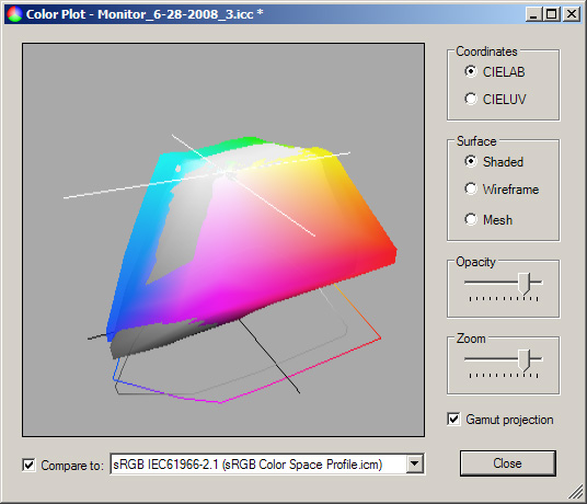

I recently purchased a 2408WFP in a Dell Days sale, and I'm also having colour calibration problems. I decided to buy this LCD because my laptop's screen is absolutely useless for photo editing. Uncalibrated, colours are dull and ugly, and calibrated, they're garish. However, the main issue that drove me to this is that the blue channel is far enough out of spec that my calibration software generates profiles that make pure blue (0,0,255) look purple. This drove me nuts over the Winter, having all my snow photos come out purple in Photoshop. I just gave up on a calibrated workflow and disabled colour management. I've since noticed this issue on pretty much all 6 bit TN panel LCDs.
I was really excited to see lots of reviews of the 2408WFP that show its wide colour gamut easily encompassing the sRGB standard. No more purple blues! Unfortunately, I've been unable to get my calibration software to generate a profile that covers the blues properly. Pure blue is BLUER than my laptop, but still very obviously purple. I'm using Firefox 3 with colour management enabled, and it's pretty obvious that blue text is somewhat purple. If I compare the profile with sRGB, some of the sRGB standard (blues) falls outside what the monitor can show.
I've tried various combinations of settings, but nothing gets me a nice profile that encompasses sRGB and gives pure blues in colour managed software. I have also noticed the lack of shadow detail noted in this thread, but I think I can live with it. Does anyone have any suggestions on what to do about this blue/purple issue? Can I see anyone else's profile examples?
I am using an original Eye One Display with the latest Eye One Match software.

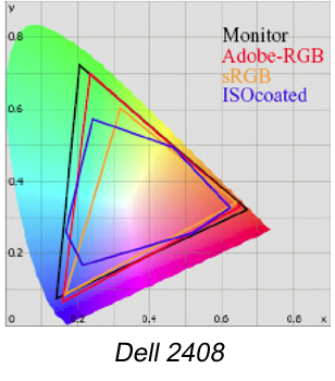

Posts: 195
Default Re: calibrating a Dell 2408WFP with the Spyder3 Pro
In this comparison from a review, the sRGB plot clearly falls within the range of colours the monitor can display:
When you make the same comparison with my monitor profile, sRGB falls outside what it can display, like Adobe RGB in the previous comparison:
