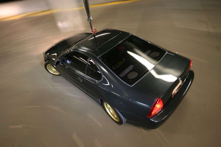

Here's my rig:

I actually really like that birds eye angle... Never thought about mounting the rig like that. Your rig seems to be pretty stable. What focal lengths are you shooting and how long is the pole?
CoreyAndrewPhoto is offline   Reply With Quote
This ad block will go away when you log in as member
Old 20th of October 2011 (Thu)   #6049
Interaktiv
Join Date: Oct 2011
Posts: 2
Default Re: Official Automotive Rigs - DIY Thread
The pole is about 4.5m long.
I'm shooting with a Sigma 10-20mm. Most of the time it's around 16mm.
Shots vary from 6/10 up to 1.5sec long.
It's nice and stable, I simply used 2 cheap suction cups from Bunnings (I'm in Australia). They're meant for holding glass.
I mounted them to the boom with some clamps and some long bolts. The boom is in 2 pieces and the joiner is a fence-post joiner.
All up rig cost was under AUD$100. I bought a cheap ebay Magic Arm for $60 to finish off the build.
Pretty happy with the outcome.
