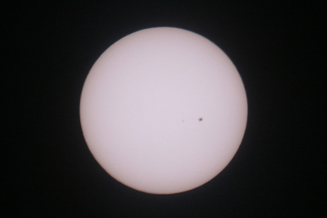

You can buy special solar filters that go IN FRONT of your lens. The silver type sheet that looks like aluminum foil lets you see the sun in it's natural color (white) and you will be able to see sunspots and the sharp limb of the sun.
Yup, Baader solarfilm is a pretty cheap way of getting shots of the Sun. I cut a piece to the right size and embedded it between two UV filters for getting shots of an eclipse and of sunspots.

Did you take this today Hollis ? What equip , a lens and camera ?

Quote:
Thesunspot pic was taken about three years ago. Canon 20D, 70-300mm DO + 1.4x TC, Baader Asrofilm filter, f/8, 1/400s.
