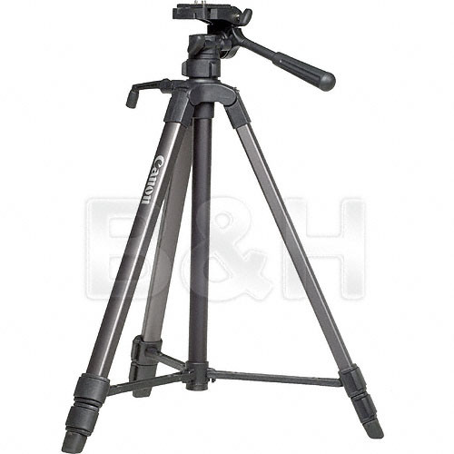

Canon Digital Photography Forums
P.O.T.N. SUPPORT SHOP IS OPEN, check it out now!
Go Back   Canon Digital Photography Forums > 'Sharing Knowhow' section > Talk About Photography > General Photography Talk
Register Rules FAQ Members List Search Today's Posts Mark Forums Read
Reply
Thread Tools Display Modes
Old 21st of December 2008 (Sun)   #1
Kit Cloudkicker
Kit Cloudkicker's Avatar
Join Date: Dec 2008
Location: Branford, CT
Posts: 215
Default New Guy here looking for some common advice
Hey guys, i've been parolling the sight for a while but finally managed to grab a username and start being active, I'm hoping to be picking up a rebel XSi with kit lens and a 50mm 1.4 lens within the next couple days, what would be the next thing everyone would recommend?
I was thinking about a grib because I've got decently large hands and dont want to be worried about dropping my XSi anywhere... for those of you with grips, how do you like them?
Kit Cloudkicker is offline   Reply With Quote
This ad block will go away when you log in as member
Old 22nd of December 2008 (Mon)   #2
JeffreyG
"my bits and pieces are all hard"
JeffreyG's Avatar
Join Date: Jan 2007
Location: Detroit, MI
Posts: 13,481
Default Re: New Guy here looking for some common advice
There are two pieces of gear that are nearly indispensible and which newcomers resist buying for some reason. These are:
1. A decent tripod with quickrelease.
2. A flash that can be bounced.
These two items will do more for the average persons photography than a case of expensive lenses.
As for grips, I don't care for them much but it has been a while since I used a Rebel.
__________________
My personal stuff:http://www.flickr.com/photos/jngirbach/
Commercial sports:http://girbach.zenfolio.com/
I use a Canon 5D and 1DIV and a Panasonic GF-1 Gear List: http://photography-on-the.net/forum/...postcount=1550
JeffreyG is offline   Reply With Quote
Old 22nd of December 2008 (Mon)   #3
Andrushka
"all warm and fuzzy"
Andrushka's Avatar
Join Date: Oct 2007
Location: OC, CA
Posts: 3,378
Default Re: New Guy here looking for some common advice
i'm all for a grip - it honestly helps me frame my portrait shots better... and on the rebels it gives you somewhere to put your ring and little finger!
Andrushka is offline   Reply With Quote
This ad block will go away when you log in as member
Old 22nd of December 2008 (Mon)   #4
DStanic
Join Date: Oct 2007
Location: Canada
Posts: 6,117
Default Re: New Guy here looking for some common advice
I think grips make the Rebel cameras feel much, much better. I haven't taken mine off since the day I bought it! As you mentioned they are great for several reasons:
1. Makes the camera easier/more comfortable to hold, doesn't feel like you are going to drop it.
2. You can attach a E-1 handstrap
3. Vertical shutter button
4. Extra battery power.
__________________
5D, 30D, Powershot S100
Sigma 24-60 f/2.8-SOLD.. Sigma 50mm f/1.4 . Canon 85mm f/1.8
http://dstanic.zenfolio.com
twitter.com/DStanicPhoto
DStanic is offline   Reply With Quote
Old 22nd of December 2008 (Mon)   #5
SoundsGood
SoundsGood's Avatar
Join Date: Nov 2006
Posts: 1,968
Default Re: New Guy here looking for some common advice
Quote:
Originally Posted by JeffreyG View Post
There are two pieces of gear that are nearly indispensible and which newcomers resist buying for some reason. These are:
1. A decent tripod with quickrelease.
2. A flash that can be bounced.
These two items will do more for the average persons photography than a case of expensive lenses.
Count me in on the "resist buying" list for the tripod.
Can you explain why and when you use the tripod? Perhaps you'll convince some of us resisters.
__________________
40D and a whole bunch of lenses
Canon 430EX, Kenko 1.4x, Domke F-3X, F-5XB, Zeikos grip
Zenfolio Discount Code: YGK-8U7-1GG
SoundsGood is offline   Reply With Quote
Old 22nd of December 2008 (Mon)   #6
Kit Cloudkicker
Kit Cloudkicker's Avatar
Join Date: Dec 2008
Location: Branford, CT
Posts: 215
Default Re: New Guy here looking for some common advice
Quote:
Originally Posted by JeffreyG View Post
There are two pieces of gear that are nearly indispensible and which newcomers resist buying for some reason. These are:
1. A decent tripod with quickrelease.
2. A flash that can be bounced.
These two items will do more for the average persons photography than a case of expensive lenses.
As for grips, I don't care for them much but it has been a while since I used a Rebel.
i already have a decent tripod and will be buying a new one in the near future but as for the flash i was going to wait until i figured out the general settings and ins and outs of my camera before i had to learn all the functions of the flash
Kit Cloudkicker is offline   Reply With Quote
Old 22nd of December 2008 (Mon)   #7
PhotosGuy
Moderator
PhotosGuy's Avatar
Join Date: Feb 2004
Location: S. E. Michigan
Posts: 64,303
Default Re: New Guy here looking for some common advice
Quote:
Can you explain why and when you use the tripod? Perhaps you'll convince some of us resisters.
Most of the time it stays in my trunk. But when I need it, I really NEED it. Your time will come, too.
__________________
www.FrankCizek.com
PhotosGuy is offline   Reply With Quote
Old 22nd of December 2008 (Mon)   #8
lungdoc
lungdoc's Avatar
Join Date: May 2006
Location: St. Catharines, Ontario Canada
Posts: 2,051
Default Re: New Guy here looking for some common advice
Quote:
Originally Posted by SoundsGood View Post
Count me in on the "resist buying" list for the tripod.
Can you explain why and when you use the tripod? Perhaps you'll convince some of us resisters.
Several reasons I can think of
1) Long exposures - think night cityscapes, sunsets etc.
1a) Long lenses - even 1/250 is long if you've got a 500mm lens!
2) Making you stop and think - forces you to consider composition.
3) Group pictures where you want to be in it - think family pictures with self timer
4) Stitching/Multiple exposures/HDR - very hard to do without fixed camera position.
5) Lens or body testing...not very common but handy when you need it.
6) When you need ultimate sharpness..the 1/focal length rule is just an approximation for 8x10 prints, for true sharpness may need tripod or really fast speeds.
I'm sure there's more.
__________________
Mark
My Smugmug Eos 7D, Canon 15-85 IS, Canon 17-85 IS, Sigma 100-300 EX IF HSM, Canon 50mm 1.8, Canon 85mm 1.8, Canon 100mm 2.8 Macro, Sigma 50-150 2.8, Sigma 1.4 EX DG , Sigma 24-70 F2.8 DG Macro, Canon EF-S 10-22, Canon 430EX,
Last edited by lungdoc : 22nd of December 2008 (Mon) at 13:49.
lungdoc is offline   Reply With Quote
Old 22nd of December 2008 (Mon)   #9
sapearl
emailed Tim some prozac
sapearl's Avatar
Join Date: Dec 2005
Location: Cleveland, Ohio
Posts: 14,272
Default Re: New Guy here looking for some common advice
I would have to agree with Jeff on this. An external flash will teach you a good deal about light, how to modify it, and use it creatively in a variety of different situations. It's amazing how bouncing it can give very pleasing, natural looking lighting when done properly.
As for tripods, I've lost track of how many I've purchased over the years. - I don't use grips either, but seem to be in the minority here. Stu.
Quote:
Originally Posted by JeffreyG View Post
There are two pieces of gear that are nearly indispensible and which newcomers resist buying for some reason. These are:
1. A decent tripod with quickrelease.
2. A flash that can be bounced.
These two items will do more for the average persons photography than a case of expensive lenses.
As for grips, I don't care for them much but it has been a while since I used a Rebel.
sapearl is offline   Reply With Quote
Old 22nd of December 2008 (Mon)   #10
polarbare
polarbare's Avatar
Join Date: Jul 2008
Location: Natick, MA
Posts: 575
Default Re: New Guy here looking for some common advice
Kit,
I have big hands and I never go anywhere without my grip attached. As a matter of fact, I don't think it's ever been off the camera since the day I bought it. If you don't mind the added weight it certainly helps people with larger hands IMO.
__________________
Brad Moore
My Sportshooter Page
Polarbare Photo Blog
Photojournalist for Bostonist.com
polarbare is offline   Reply With Quote
Old 22nd of December 2008 (Mon)   #11
sapearl
emailed Tim some prozac
sapearl's Avatar
Join Date: Dec 2005
Location: Cleveland, Ohio
Posts: 14,272
Default Re: New Guy here looking for some common advice
I understand - makes sense in your case. I have midsize hands. I try to minimize the total weight since over the the course of an 8 - 12 hour wedding day things can get a little bit heavy.
Quote:
Originally Posted by polarbare View Post
Kit,
I have big hands and I never go anywhere without my grip attached. As a matter of fact, I don't think it's ever been off the camera since the day I bought it. If you don't mind the added weight it certainly helps people with larger hands IMO.
sapearl is offline   Reply With Quote
Old 22nd of December 2008 (Mon)   #12
Kit Cloudkicker
Kit Cloudkicker's Avatar
Join Date: Dec 2008
Location: Branford, CT
Posts: 215
Default Re: New Guy here looking for some common advice
all good stuff, i guess im wondering if there are any retail places that would let you test fit a grip to see how it feels, just seems like a big jump in money for something im not sure i would be completely happy with, money could be well spent other places
Kit Cloudkicker is offline   Reply With Quote
Old 22nd of December 2008 (Mon)   #13
JeffreyG
"my bits and pieces are all hard"
JeffreyG's Avatar
Join Date: Jan 2007
Location: Detroit, MI
Posts: 13,481
Default Re: New Guy here looking for some common advice
Quote:
Originally Posted by SoundsGood View Post
Count me in on the "resist buying" list for the tripod.
Can you explain why and when you use the tripod? Perhaps you'll convince some of us resisters.
1. Macro, because rigging my flashes to work for macro actually takes more effort than using the tripod.
2. Quite a bit of formal portrait work. I have a tough space to work in and so I kind of need to keep the camera in one place relative to subject, lights, background and stuff to make the shots work. Tripod and re-checking is part of the process there.
3. Landscape stuff. I'm not much of a landscape shooter, but I make vacation books each year for both extended families from our trips together. I include a lot of scene shots in those books because they are places we all experienced together. Anyway, about half of this stuff needs a tripod to be shot.
4. Along with (3), I usually include a group shot of the whole extended family and they kind of want me to be in it too.
I don't use a tripod all the time (and probably not as often as I should) but when you need one there isn't really any other way around it.
If you can stand the weight something like the Manfrotto 055 or 190 plus a 486RC2 head won't break the bank and it stable enough.
__________________
My personal stuff:http://www.flickr.com/photos/jngirbach/
Commercial sports:http://girbach.zenfolio.com/
I use a Canon 5D and 1DIV and a Panasonic GF-1 Gear List: http://photography-on-the.net/forum/...postcount=1550
JeffreyG is offline   Reply With Quote
Old 22nd of December 2008 (Mon)   #14
neilwood32
neilwood32's Avatar
Join Date: Sep 2007
Location: Sitting atop the castle, Edinburgh, Scotland
Posts: 6,111
Default Re: New Guy here looking for some common advice
I would resist buying the 50mm f1.4 for the moment unless you have a dying need for low light photography that requires it.
I would agree with buying the flash. It is invaluable and useable in all kinds of photography.
If you have big hands then a grip is unbelievably useful. Mine never comes off!
__________________
Having a camera makes you no more a photographer than having a hammer and some nails makes you a carpenter - Claude Adams
Keep calm and carry a camera!
neilwood32 is offline   Reply With Quote
Old 22nd of December 2008 (Mon)   #15
Kit Cloudkicker
Kit Cloudkicker's Avatar
Join Date: Dec 2008
Location: Branford, CT
Posts: 215
Default Re: New Guy here looking for some common advice
that seems to be a little steep for my price range right now, im newer to this photography stuff and dont want to spend way too much and eventually fall out... does anyone know anything about this canon tripod? its relatively cheap and it's canon so i was just assuming it was decent, not the professional grade everyone here is used to but thats just not what i need yet.
Kit Cloudkicker is offline   Reply With Quote
Reply
Thread Tools
Display Modes
Posting Rules
You may not post new threads
You may not post replies
You may not post attachments
You may not edit your posts
vB code is On
Smilies are On
[IMG] code is On
HTML code is Off
Forum Jump
Similar Threads
Thread Thread Starter Forum Replies Last Post
My sidearm guy - thanks for advice... pigtailpat Sports 4 10th of May 2008 (Sat) 22:01
Advice for the new guy thexrickx General Photography Talk 11 5th of April 2008 (Sat) 21:52
Advice on people for a sports guy... namasste People 10 20th of November 2007 (Tue) 11:52
new guy looking for advice. lancerlance83 Canon EOS Digital Cameras 14 27th of August 2007 (Mon) 16:01
New Guy needs advice on Camera!! Cornellian Canon EOS Digital Cameras 8 8th of April 2007 (Sun) 19:39
All times are GMT -5. The time now is 03:28.
Powered by vBulletin® Version 3.6.12
Copyright ©2000 - 2013, Jelsoft Enterprises Ltd.
This forum is not affiliated with Canon in any way and is run as a free user helpsite by Pekka Saarinen, Helsinki Finland. You will need to register in order to be able to post messages. Cookies are required for registering and posting. HTML in messages is not allowed, plain website addresses are automatically made active by the board.
