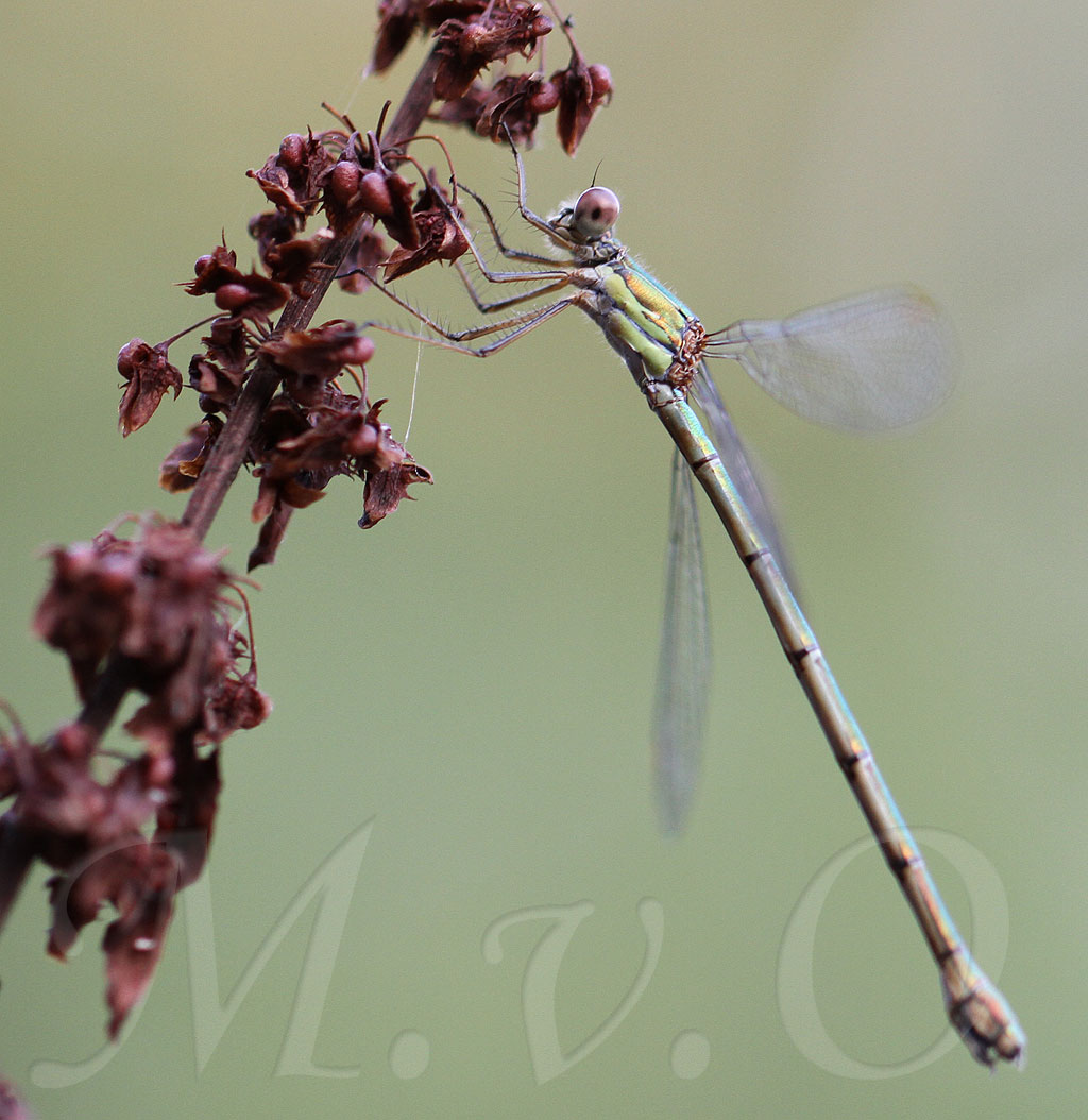

P.s. Here is one of my first (handheld) macro images: I know it could probably have been much better when i would have been aware of all settings i should implement in my 7D, but still..
i'm kind of proud this was one of my first macro images. And no, the camera was not on auto setting Critisism is welcome ofcourse
