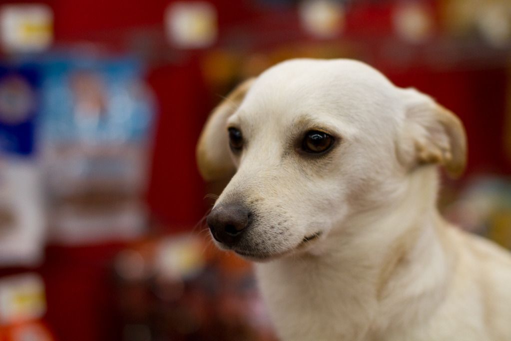

First off, Lets go over a few things, Had this lens for a while now, Its always had a slightly iffy problem with focusing in good light, or with light colored subjects.. Oddly enough it works great in low light, Just if i try to use it in daylight the focus tends to not work correctly
It also never is consistent, Some images show front focus, Some show backfocus, Distance and etc dont seem to make any difference
Anytime I try the old "Test chart" crap it tests out perfectly fine...
I have no problems with any other lenses, Either lenses I've owned, or lenses I currently own I'm confident enough to say its not my technique and its not my 7D
I was just reviewing a few shots I did from today, and im pretty sure (To my eyes at least) it appears the lens is both front focusing and backfocusing) I also went back through some others... In general i am also just going to post up a bunch to show that the issue is inconsistent...not a simple MA is going to fix it...
Also I've shot thousands of images with the lens, Multiple subjects, and its cropped up on more subjects than just these... I just tend to not keep ones that are not "Right"
No adjustments on these, except for a slight output sharpen from LR3, No exposure adjustments (Yes they need that, I'm well aware guys) Only one seems to show the weird simultaneous front/back focus issue...but its the only image i have thats taken in such a situation to make such a thing easily evident

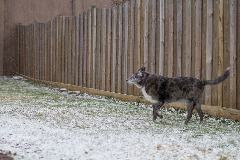

Lets start here:
IMAGE: http://img.photobucket.com/albums/v170/scifiguy1012/Photography/IMG_6146.jpg

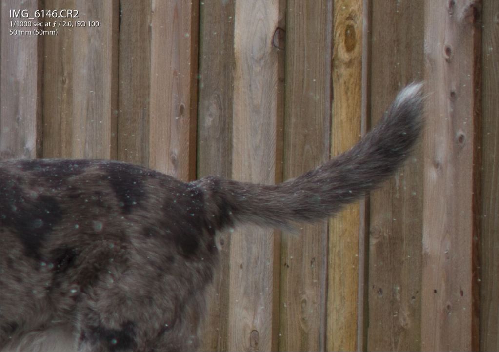

Crop 1 showing where the focus point was (Her face, Obviously)
IMAGE: http://img.photobucket.com/albums/v170/scifiguy1012/Photography/6146crop1.jpg
Crop 2 showing what ended up in focus
IMAGE: http://img.photobucket.com/albums/v170/scifiguy1012/Photography/6146Crop2.jpg
Obvious backfocus....

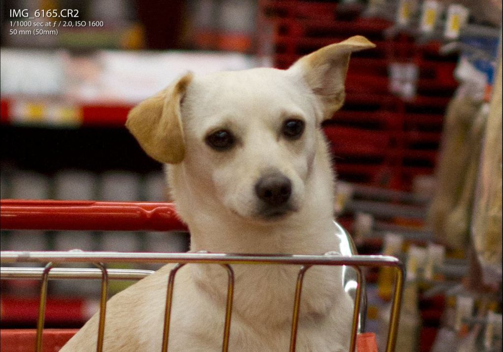

Heres the one that made me make the thread...
IMAGE: http://img.photobucket.com/albums/v170/scifiguy1012/Photography/IMG_6165.jpg
Focus was on the dog's face...
IMAGE: http://img.photobucket.com/albums/v170/scifiguy1012/Photography/Centering1.jpg

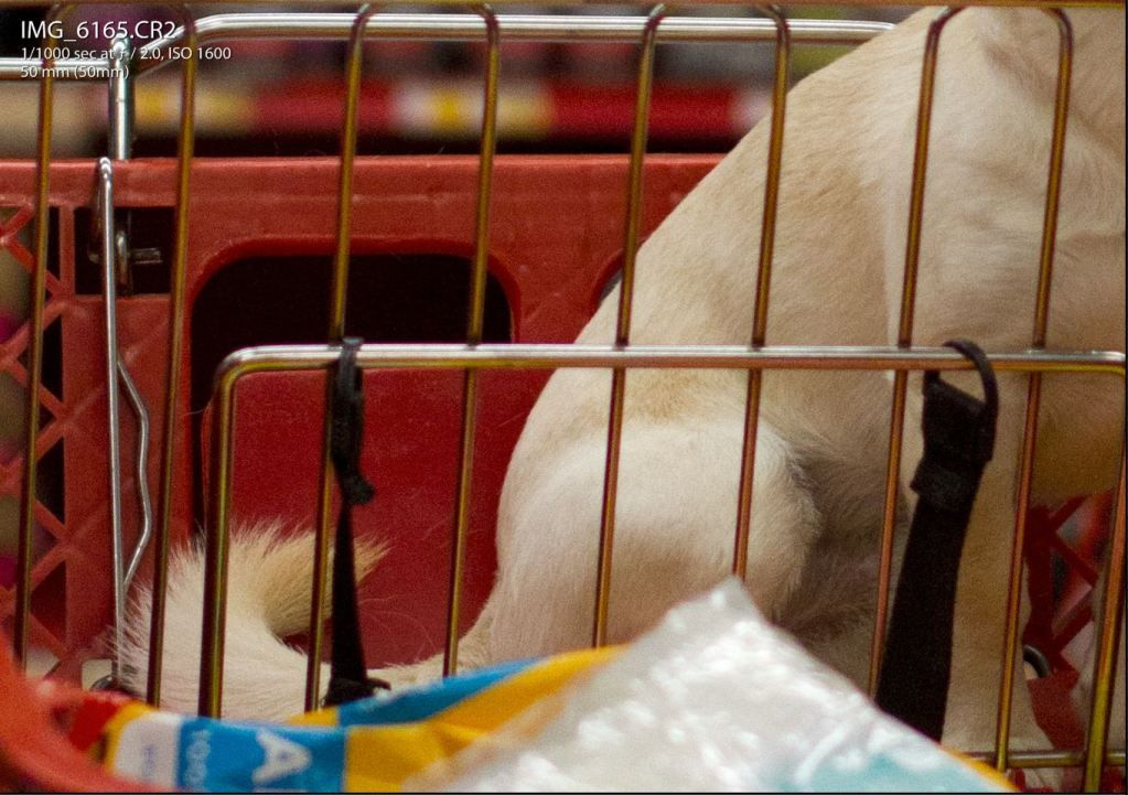

But yet... Heres his butt..
IMAGE: http://img.photobucket.com/albums/v170/scifiguy1012/Photography/Centering2.jpg
His butt is definitely more in focus than his face from what i can see... But wait...

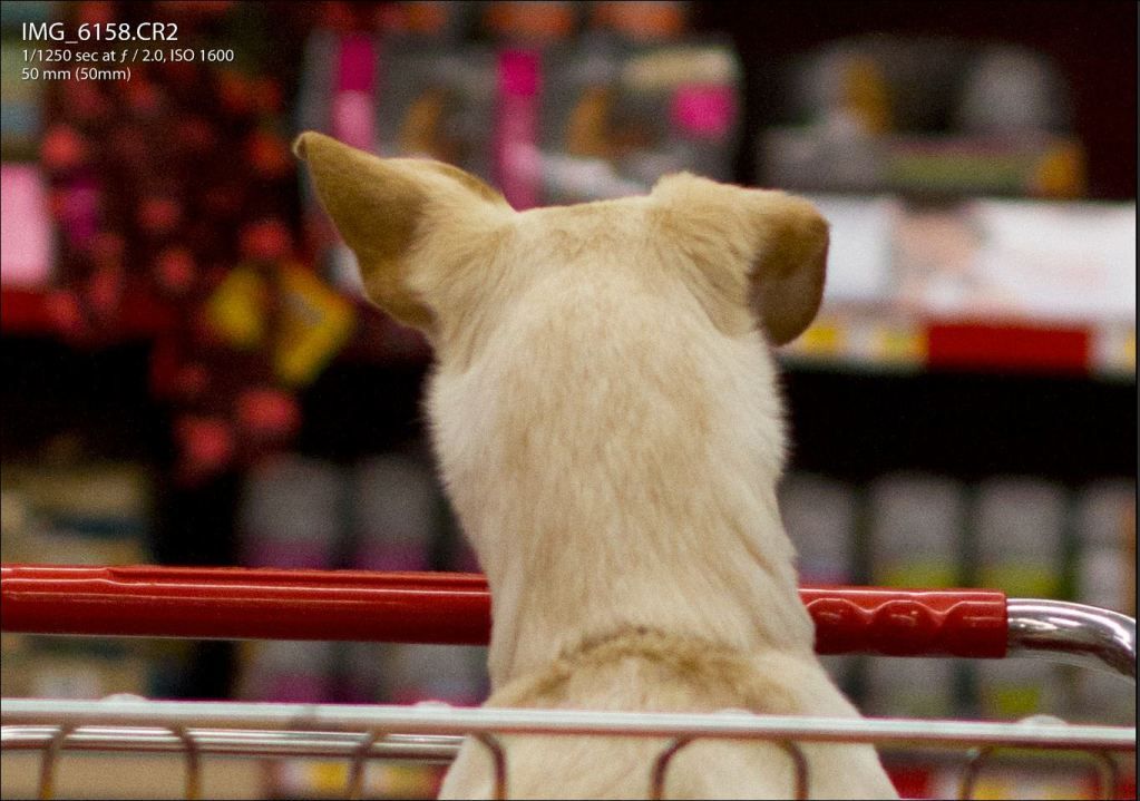

Heres another from the series showing the same thing:
IMAGE: http://img.photobucket.com/albums/v170/scifiguy1012/Photography/IMG_6158.jpg
Back of the dog's head showing where i focused..and showing the handle of the cart is clearly in better focus

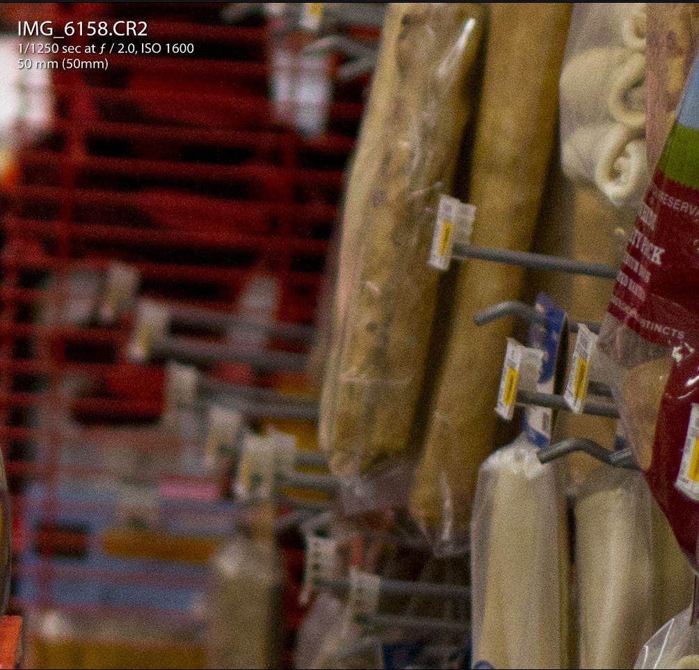

But again, Right side of the image, same package
http://img.photobucket​.com …Photography/615​8Crop2.jpg (external link)

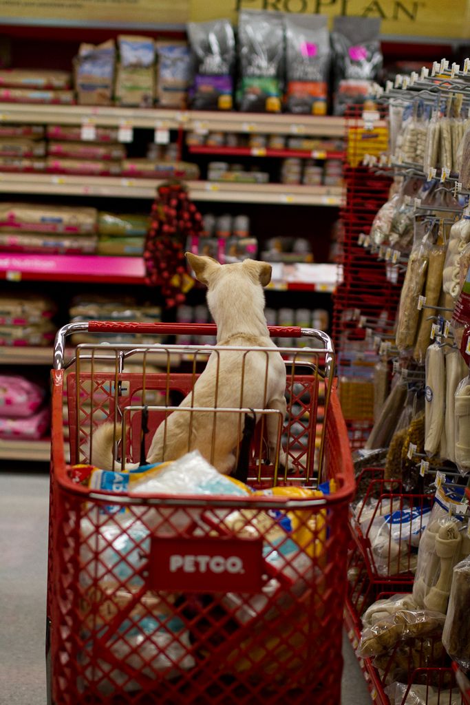

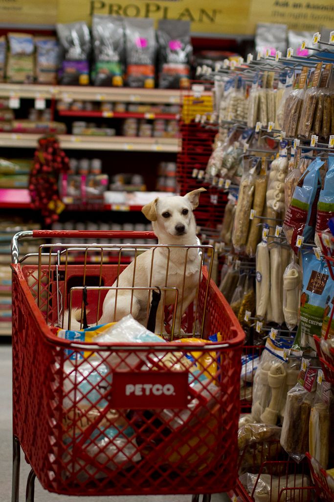

My take on your simultaneous front/back focused photo:
You didn't take this photo completely perpendicular to the aisle. You may have been standing in the center of the aisle, but you're still shooting at an angle, which allows you to capture the right side of the aisle (with the products hanging), but we don't see the left side of the aisle. In other words, see attached image.
Your plane of focus (while backfocusing in relation to the dog's head/face) fell on the dog's butt and the treats on the right side.

I think Julian almost has it correct. I think your perspective is off. Actually, the treats you think are in front of the dog appear to be slightly behind him in the photo. If you look at the full picture (dog facing towards you) the "Rawhide Chips bag" appears to be the most in focus. If you draw a line from that bag down to the bottom shelf the red vertical rail (second from front) appears to be the one in focus and slightly behind the rawhide bag. And, it appears to be almost even with the back leg of the cart. Thus, your dog's rear which is closer to the back of the cart is the point of focus.
