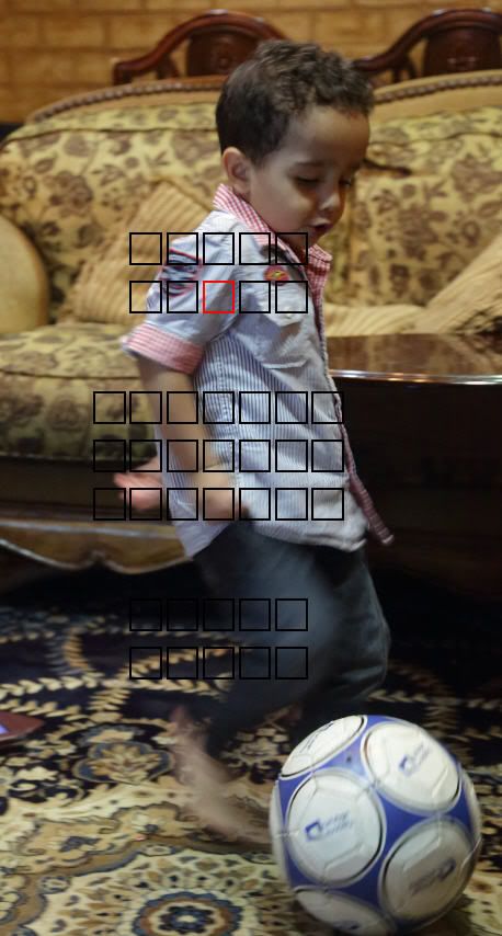

When I got the camera I tested it for stills and wow, the pictures were sharp compared to my 500D. But when using AI Servo to photograph my boy who happens to move around alot especially if he sees the camera I don't get sharp pictures as the many I'm seeing on the net.
I tried all cases with all kinds of AF point selections, but did not get one sharp photo when he is on the move. Now I know this has nothing to do with camera, so I'm sure it is somehow my fault.

Sniper258
133 posts
Apr 09, 2012 12:39 |  #7
The issue is, if increase the shutter I have to increase the ISO which is already high. In addition to this I have to increase the exposure by one stop.
Here is a sample photo that I just took of him making just small movements since I deleted all that was taken before.
IMAGE: http://i233.photobucket.com/albums/ee226/sniper258_album/DPP_0001.jpg
and again showing the AF point
IMAGE: http://i233.photobucket.com/albums/ee226/sniper258_album/2.jpg
I used Ai servo for that photo of course.
This one shows all the settings used.
IMAGE: http://i233.photobucket.com/albums/ee226/sniper258_album/3.jpg
You can see if I increase the shutter or aperture, then I have to increase the ISO which I tried already but never liked the photos. they were very noisy.

Apr 09, 2012 12:45 |  #8
Yeah that's way to high of aperture for shots inside of a room like that. I would suggest getting a flashEX430 or 580 or the 600 if you can afford it :)

Apr 09, 2012 13:22 |  #12
Sniper258 wrote in post #14236124 (external link)
I do have a 430 and I use it for stills indoors and outdoors, but I don't know how it will help with shutter increase.
Well, you will have more light, so can use a faster shutter speed. Besides that, the flash duration is very short and will itself freeze the motion. You can also bring your ISO way back down again and get rid of the noise.
1/50th is way too slow a shutter speed for a kid with a football.

Apr 09, 2012 13:22 |  #13
It won't increase your shutter speed (up to 1/200 anyways), but without going into the details, it doesn't matter. Your flash speed becomes your new effective shutter speed.
1. Go into manual.
2. Set your SS to 1/200
3. Set your aperture to f4
4. Set your ISO to 400-800 (should be relatively noise free on the 5D3)
5. Put on your flash, and bounce off ceiling or wall.

Apr 09, 2012 13:24 |  #14
The shutter speed is way to low. At 1/50, you'll get motion blur at any rate. Some suggested using flash which can help with freezing the action but it'll not help increase the shutter speed.
Another thing is add more lights :)
Short of getting a real fast lens for this type of photographs, you have to either increase lights or use flash.

Apr 09, 2012 13:37 |  #15
You don't need a faster shutter speed if you use a flash
The flash will freeze the action
