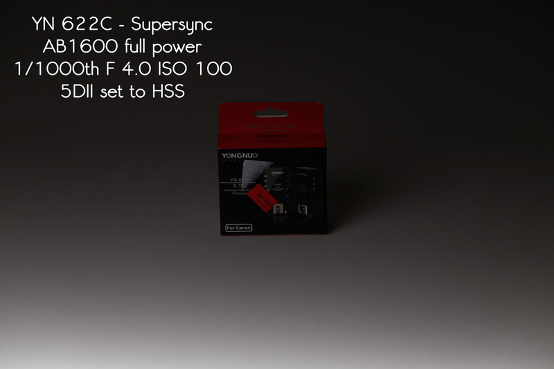

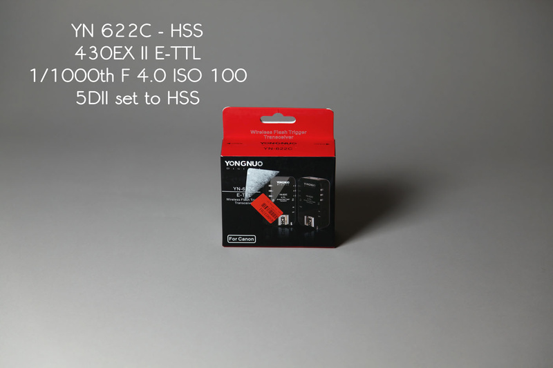

OK - finally had time to test the SuperSync with my AB1600. A primary attraction for me of the 622C's (been using 602's, then 603's for years) was the possibility of getting higher shutter speeds on my AB's when shooting outdoors. Here are my results (the difference between the two properly exposed shots is due to the different softboxes but you get the idea.
IMAGE: http://photos.imageevent.com/24peter/uploads/postuploads4/large/IMG_2749t.jpg
IMAGE: http://photos.imageevent.com/24peter/uploads/postuploads4/large/IMG_2751t.jpg
IMAGE: http://photos.imageevent.com/24peter/uploads/postuploads4/large/IMG_2753t.jpg
I used a 1/1000th shutter to be generous here. 1/8000th was completely black.
Conclusion: no supersync advantage with AB1600.
Only good news on the 622C's is I get clean frames at 1/200th on my 5DII with AB strobes and 622C's. With 602's & 603's, I had to shoot at 1/160th or even 1/125th to get clean frames.
While I am disappointed in the results I get with my AB, I am interested in being able to use HSS off-camera with Speedlites, though my 430EX II ain't enough to overpower sun (I also have a 430EX but it is a PITA to have to adjust settings on the flash itself rather than via the camera menu.)
I will say the SuperSync images looked a little better when shot with my 60D, but still not useable at all IMO. So, am I missing something here? Some people seem to be claiming different results. Got pics?

Peter,
Where you are going wrong is, for each stop of increased shutter speed, you need to compensate by either opening up a stop of aperture or increase your ISO a stop. this will level out your expsosure.
Hypersync wont magically increase your flash power/expsoure, it will just allow you to use the Tail of the flash once you go over your max sync speed, but if you increase your shutter speed (which is your objective) you'll be using less of the 'Tail' of the flash, so again you'll need to compensate by Fstop or ISO.
So...for outside use as you mentioned, if your exspoure is 1/200th at F16, if you increase to 1/800th you need to open up to F8, 1/1600th to F5.6, 1/3200th to F4....the primary obejective of hypersync outdoors is to allow you to use wider apertures F2.8/F4 it will not increase the efficieny of the flash or alter the Flash ambient ratio.
Hope this helps.:)

Doh! , just realised you did increase flash power from 1/32 to full power....Sorry..:) this must be because of the quicker Flash duration of the AB1600.
Yeah, that's what kind of disappointing and why I see no advantage here. Perhaps other strobes will faire better in this regard.
Just to be clear: I'm not trying to dis' the 622C. I am pleased to have full E-TTL w/ HSS off camera for my Canon Speedlites for $82. But just want to get the record straight on SuperSync with AB studio strobes.
