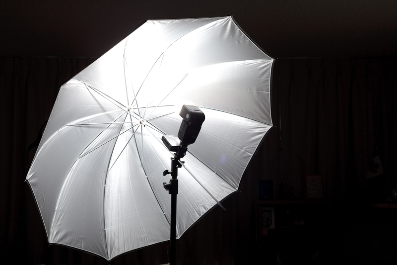

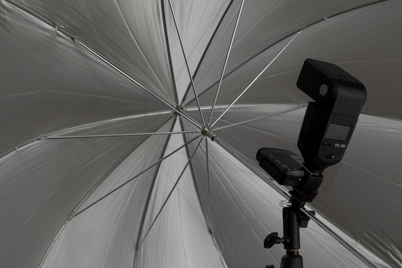

Looking at this one (external link) you have there, I'm suddenly reminded of what triggered this question in the first place: my flash head is not dead centre.
IMAGE: http://www.diamantstudios.ca/Ablage/Bild/Examples/FG_straight_on.jpg
It can be tilted, but only by -7 degrees, and you can see that the beam doesn't hit right in the centre even then:
IMAGE: http://www.diamantstudios.ca/Ablage/Bild/Examples/FG_tilted_105.jpg
Side question: what if you use diffusers to simulate bare bulb with brollies? It seems to me that the light fills the umbrella more with it than without it:
IMAGE: http://www.diamantstudios.ca/Ablage/Bild/Examples/FG_tilted_stofen.jpg
But, of course, you'd lose intensity.

Referring back to http://www.flickr.com …in/set-72157630310760782/ (external link) and relating this to your images, it appears that you have the flash positioned at point C. Try backing the umbrella surface further away from the flash head and you will find that the spread of light can actually be controlled with the zoom reflector to more or less fill the umbrella surface. Basically, try the umbrella shaft only just inserted into the flash holder so that it's as far away as possible.
The problem with using a diffuser cap (Stofen or similar) is, as you say, the loss of intensity. You would also find that you lose control of the beam from the umbrella because the diffuser just spews light uncontrollably in all directions. You'll get completely different quality of lighting because a lot of the output would be reflected from areas outside the umbrella canopy. If you were to use this arrangement outdoors, you'd rapidly run out of power because of the wasted light

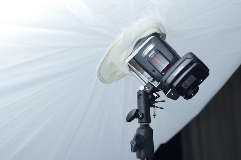

The offset can be cured by a simple bracket like this (external link). Doesn't need to be pretty and you may like to put a strap of some sort round flash head and bracket (a hair band or 'scrunchy' works fine) to make it even steadier. Flash fits on like this (external link) (please ignore the DIY honeycomb, again this image was taken for a totally different topic) and places the flash tube as close to the axis as you can get. This easily gets round the triangle formation you have at present. Just a bent piece of aluminium bolted to a cheap 'E'-type umbrella flash mount in place of the cold shoe - a couple of 4mm stainless bolts in place of the original countersunk ones did the job. The other bent bit is simply somewhere to bolt a Pixel TD-381 power pack on those occasions when my Godox PB960 is in use elsewhere.

Well, it definitely wasn't pretty, LOL. I'll see if I can get a better piece of aluminium.
IMAGE: http://www.diamantstudios.ca/Ablage/Bild/Examples/HM_bracket.jpg

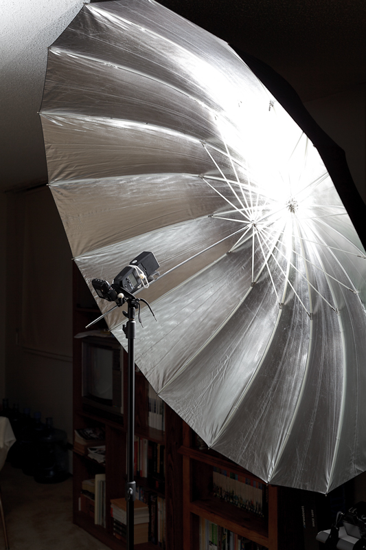

It seems that when using the cover, I don't have much choice in terms of placement along the shaft, especially if I want to remove the bottom part of it. But, when using it coverless... which brings up a side question: what about parabollic brollies? Can they be really efficiently used with speed lights? I bought mine to use for group shots, but it seems that the beam is even more collimated with these big things than with the normal umbrellas. Maybe it's time I really bought a monolight.
IMAGE: http://www.diamantstudios.ca/Ablage/Bild/Examples/Parabollic.jpg
I was trying to set it at 'Position A' in the pic above.
