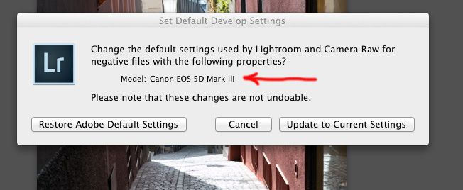

The answer is in this link for LR. Preferences - presets. There are the two check boxes you can either select or deselect based on if you want to default to the camera serial number or not and iso.
I just set my clarity and vibrance to my default settings, my masking slider to 80, enabled my lens and CA corrections. Both the check boxes in preferences were disabled. LR 5 is a bit different than 4. The instructions say choose default from photo but it is actually in Develop - Set default settings.
All the files I import now default to those custom settings and now the lens correction enables automatically.
I did that with my 5D3. Even though I did not enable the two check boxes in the preferences I'm not sure why it would not work with my 7D. I had to do repeat the process with a 7D file which was no big deal. I noticed it does specify the camera when you are following the process.
IMAGE: http://i33.photobucket.com/albums/d74/Zenon1/Lightroom/rrrr_zpsa3b2336e.jpg~original
Read tip #1 under the screenshot of the LR preferences. This also applies to ACR. You can click the link for an example.
http://www.computer-darkroom.com …a/lr2-camera-defaults.htm (external link)

"I'm not sure why it would not work with my 7D". Duhhh. It was right under my nose. One check box is for the cameras serial number.

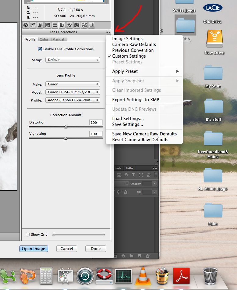

Basically you can open preferences when you are looking at an image in LR. I can't find a way to do this when I open a RAW file in PS. Since I set my camera defaults in LR and ACR automatically picked up my new camera I have not gone through this process n ACR.
1. Open PS and then click on Photoshop - Preferences - Camera Raw.
In the Default Image Settings dialogue box you can select if you want your new defaults ISO and your cameras serial number specific. If you select ISO then it will apply only to the ISO of the RAW file you will be working with. If the RAW file is 100 it will only to ISO 100 shots. For your purposes I would not check that box tight now. For the camera serial number. If you check it then it will only apply to that specific camera. If you have 2 x 5D3's then it will only apply to 1. If you don't check it then it will apply to both your 5D3's.
2. Close the preferences.
3. Open a RAW file. Make sure it is not an old processed one because ACR will remember the settings and will apply them to your new Camera Defaults. If it is an file you have already processed reset everything back to Adobes defaults.
4. After you open the file go to the Lens Correction tab. Check whatever you want to be enabled each time you open a raw file.
5. This next part is up to you. If you want anything like a your own base sharpening, noise reduction, colour adjustments that you automatically adjust or have in a preset - you can make those changes as well. This way every time you open a file your lens correction and other adjustments will apply as well. If not you can add them later. Also you can always reset them if does not work out.
6. Then you click on that icon and Save New Camera Raw defaults. Now all the raw files will now open and the Lens Correction will be enabled for that camera model for each type of lens you have used. If you have 7D, etc you have to repeat the process for each camera type.

Here's some more screen shots for you as well, to add to (or compliment) what Digital Paradise posted. Plus I needed the practice as well!
@ DP: I think you have to set the "Enable Lens Profile Corrections (Setup Dropdown)" to "Auto", but "Default" may work as well ?

Step 1.
Open a RAW image to work on in ACR that has had no prior adjustments. Open the "Preferences" dialog:
IMAGE: http://i396.photobucket.com/albums/pp49/dougle/POTN/RAW%20Converter/Step_01.jpg
Step 2.
Click appropriate boxes for "Auto Tone, Serial Number, and ISO" if you want. Click OK to close the dialog.
IMAGE: http://i396.photobucket.com/albums/pp49/dougle/POTN/RAW%20Converter/Step_02.jpg
Step 3.
Click on the "Lens Corrections" tab to open the dialog.
IMAGE: http://i396.photobucket.com/albums/pp49/dougle/POTN/RAW%20Converter/Step_03.jpg
Step 4.
Click on the "Profile Tab" and put a check in the "Enable Lens Profile Corrections" box. Click on the drop-down arrow for "Setup" and pick "Auto".
IMAGE: http://i396.photobucket.com/albums/pp49/dougle/POTN/RAW%20Converter/Step_04.jpg
Step 5. (optional)
Click on the "Camera Calibration" tab and set a 'starting point' profile for your workflow.
IMAGE: http://i396.photobucket.com/albums/pp49/dougle/POTN/RAW%20Converter/Step_05.jpg
Step 6.
Click on the little "Menu" icon circled in the screenshot to open a list of options. Click "Save New Camera Raw Defaults" and that's it!
Close the RAW converter and the next time you open an image in the RAW converter your new defaults will be in effect.
IMAGE: http://i396.photobucket.com/albums/pp49/dougle/POTN/RAW%20Converter/Step_06.jpg

Oh that is where you open the preferences dialogue. I quickly scanned through those icons and missed it. I did this via LR so that was new to me. Thanks Dennis.
I left all my settings at Default and it picks up all lenses for both my cameras in both LR and ACR.
Note: As I was goofing around in ACR I clicked on Reset Camera Raw Defaults and it reset both ACR and LR. A quick fix but good to know. My guess is if I make a change in ACR and click on Save New Camera Raw Defaults it will apply them to LR as well.
It appears you can add changes later. When I opened a file in ACR the Save New Camera Raw Defaults is greyed out however if you make any new adjustments it activates. I'll go through NR for ISO as I go. Still on the fence as I find NR a personal touch type of thing but I guess if you have lots of files and need to be down and dirty it would be helpful. Sorta feels like I spent years learning how to not use auto when it comes to camera, flash and PP and now I'm going back to auto :) At least I'm controlling it.
