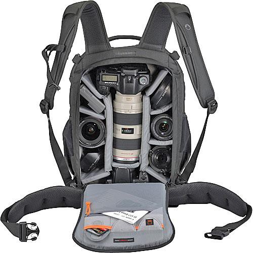

Thread started 30 Mar 2015 (Monday) 22:20
Sigma 150-600mm f/5-6.3 DG OS HSM Contemporary
Immaculens
creeped by the TF....
13,579 posts
Gallery: 88 photos
Likes: 3789
Location: Southern Canada
Sep 07, 2016 17:34 |  #1696
EricaC wrote in post #18120250 (external link)
I have this bag and use it with a Sigma 150-600 attached to my camera. There is still room for extra lenses/flash. I'm not sure what/how much extra equipment you want to carry, but you'd be surprised how much the front "organizing pocket" can hold. The pocket goes the full length of the bag. I've used it to carry a 580II and 430 flashes and accessories before, but usually I load it up with notebook, pen, any smaller accessories like filters and batteries and a lot of snacks. You can fit a light sweater or jacket in the front pocket if you don't overstuffed it with other things. (I've done this by carrying some snacks in one of the side mesh holders instead.) If carrying a heavy sweater or thicker coat, I have to roll it and attach to the top or sides with the built in straps.
Thanks for your input!
anything you do not like about it?
7Dmk II gripped | 5Dc | 100-400L IS II | 55-250 IS STM | 100L f/2.8 IS Macro | 15-85 IS | 50 f/1.8 STM |
Learn to love to do well, and you shall.
~ C. Poseidon
EricaC
38 posts
Sep 07, 2016 21:21 |  #1697
Immaculens wrote in post #18120258 (external link)
Thanks for your input!
anything you do not like about it?
The only thing that I sometimes find annoying is that the camera compartment flap doesn't stay open on its own when unzipped, so you need to use a hand to keep it flipped opened while unloading and loading various equipment. This is only an annoyance at home or indoors though because the reason for it is the flip side function of being able to access your gear without taking the pack off, which I obviously like if I want to change lenses when hiking outside especially if the ground is wet or muddy. I don't really have any complaints as far as what and how it holds equipment.
Gungnir
694 posts
Gallery: 37 photos
Likes: 256
Location: Suffolk, England
Post edited over 7 years ago by Gungnir.
Sep 08, 2016 01:19 |  #1698
Immaculens wrote in post #18120238 (external link)
This Lowepro looks like a contender: Flipside 400AW Backpack
https://static.bhphoto​.com …31962789000_IMG​_33368.jpg (external link)
https://www.bhphotovid​eo.com …_400AW_Backpack​_Pine.html (external link)
but does not appear to have a top compartment to cold extra stuff...
May have to go with my current backpack's big brother - the Lowepro Video Fastpack 350
Not yet clear if I can have the body attached or if I would put the body in the upper compartment
https://www.bhphotovid​eo.com …R_Video_Fastpac​k_350.html (external link)
I have the Flipside 400 and the 300. Capacity is similar. 400 is shorter and wider whilst 300 is tall and slim.
The 300 has more space in the main compartment when configured for the Sigma but the 400 has a much bigger accessory section on the back, big enough for rolled-up waterproofs or a light fleece jacket. Straps to tie bulkier items to top of bag also.
The compartment flap on both requires 'encouragement' to stay open when new due to thick padding but persistent opening and closing develops memory effect in the foam after a while.
The chest straps on both bags are fragile though. Clip on with friction rather than permanently attached.
300
IMAGE: https://photography-on-the.net/forum/images/hostedphotos_lq/2016/09/2/LQ_812320.jpg
Image hosted by forum (812320) © Gungnir [SHARE LINK]
400
IMAGE: https://photography-on-the.net/forum/images/hostedphotos_lq/2016/09/2/LQ_812321.jpg
Image hosted by forum (812321) © Gungnir [SHARE LINK]
Steve
'Be the person your dog thinks you are'
#freetommy
METAL1
934 posts
Gallery: 98 photos
Likes: 366
Joined Feb 2013
Sep 08, 2016 04:58 as a reply to  @ post 18118267 |  #1699
Little bit noisy. Maybe u did an huge crop?
FLiCKR (external link) 400D gripped. 1DMK4. PELENG 8MM Fisheye. 10-22 EF-S. ELLO (external link) Σ 12-24 ii. 20-35. 40MM. 24-105. 300 2.8. 100-400. Sammy 800. TUMBLR (external link)
filam
601 posts
Gallery: 338 photos
Likes: 4929
Joined Jun 2011
Location: uk
Sep 10, 2016 04:06 |  #1700
Robin
IMAGE: https://photography-on-the.net/forum/images/hostedphotos_lq/2016/09/2/LQ_812774.jpg
Image hosted by forum (812774) © filam [SHARE LINK]
Canon 1DX 5Dmk3 Canon 600mm f4L IS
Canon 70-200mm f4L IS Canon 50mm f1.8II
Canon 16-35mm f4L IS
Gitzo GT5532S Tripod - Wimberly WH-200 mkII
https://www.instagram.​com/hongleungphotograp​hy/ (external link)
https://www.instagram.​com/hongleungwildlifep​hotography/ (external link)
filam
601 posts
Gallery: 338 photos
Likes: 4929
Joined Jun 2011
Location: uk
Sep 10, 2016 04:19 |  #1701
Sigma Dock update available version 1.3.1
Canon 1DX 5Dmk3 Canon 600mm f4L IS
Canon 70-200mm f4L IS Canon 50mm f1.8II
Canon 16-35mm f4L IS
Gitzo GT5532S Tripod - Wimberly WH-200 mkII
https://www.instagram.​com/hongleungphotograp​hy/ (external link)
https://www.instagram.​com/hongleungwildlifep​hotography/ (external link)
Immaculens
creeped by the TF....
13,579 posts
Gallery: 88 photos
Likes: 3789
Location: Southern Canada
Sep 10, 2016 11:58 |  #1702
filam wrote in post #18123084 (external link)
Sigma Dock update available version 1.3.1
pasted:
Benefit of SIGMA Optimization Pro 1.3.1:
SIGMA Optimization Pro 1.3.1 for Windows
・It has corrected the phenomenon where it occasionally does not recognize FLASH USB DOCK FD-11 and ELECTRONIC FLASH EF-630 SA-STTL when they are attached.
SIGMA Optimization Pro 1.3.1 for Macintosh
・It has corrected the phenomenon where it occasionally does not recognize FLASH USB DOCK FD-11 and ELECTRONIC FLASH EF-630 SA-STTL when they are attached.
7Dmk II gripped | 5Dc | 100-400L IS II | 55-250 IS STM | 100L f/2.8 IS Macro | 15-85 IS | 50 f/1.8 STM |
Learn to love to do well, and you shall.
~ C. Poseidon
Perfectly ­ Frank
I'm too sexy for my lens
6,232 posts
Gallery: 146 photos
Likes: 5004
Sep 10, 2016 19:18 |  #1703
Uh-oh, my Contemporary just failed today at an air show.
When I press the shutter half way down for AF, the vf image jumps around pretty bad.
At the same time the distance scale on the lens quickly moves back and forth. I can't obtain AF.
When I turn off OS the problem goes away. Looks like a trip to Sigma repair is in order.
When you see my camera gear you'll think I'm a pro.
When you see my photos you'll know that I'm not.
My best aviation photos (external link)
My flickr albums (external link)
05Xrunner
Goldmember, Flipflopper.
5,758 posts
Gallery: 52 photos
Likes: 505
Location: Pittsburgh PA
Sep 10, 2016 20:29 |  #1704
well good thing for that extra long 3year warranty.
My gear
Fuji X-T2, Fringer Pro EF-X, 14 f2.8, 18-55 2.8-4 OIS, 35 f2, 50 f2, 90 f2, 55-200 3.5-4.8 OIS, Tamron 150-600 G2 VC
Sony RX100 II
cogs ­ v
1,676 posts
Gallery: 154 photos
Likes: 5998
Joined Jun 2010
Location: Portsmouth UK
Sep 11, 2016 12:55 |  #1705
IMAGE: https://c8.staticflickr.com/9/8202/29611906615_3c58f19ce8_b.jpg
IMAGE LINK: https://flic.kr/p/M7GL​b4  (external link) Fox (external link) by Colin Vanner (external link), on Flickr
The quickest way to make money at photography is to sell your camera
http://www.flickr.com/​photos/59471898@N04/ (external link)
Immaculens
creeped by the TF....
13,579 posts
Gallery: 88 photos
Likes: 3789
Location: Southern Canada
Sep 11, 2016 13:50 |  #1706
Perfectly Frank wrote in post #18123704 (external link)
Uh-oh, my Contemporary just failed today at an air show.
When I press the shutter half way down for AF, the vf image jumps around pretty bad.
At the same time the distance scale on the lens quickly moves back and forth. I can't obtain AF.
When I turn off OS the problem goes away. Looks like a trip to Sigma repair is in order.
Do you have the Sigma Dock? Did you recently update the FW or update settings? Maybe you can reset to Factory Default and update again...
7Dmk II gripped | 5Dc | 100-400L IS II | 55-250 IS STM | 100L f/2.8 IS Macro | 15-85 IS | 50 f/1.8 STM |
Learn to love to do well, and you shall.
~ C. Poseidon
Orogeny
1,168 posts
Gallery: 90 photos
Likes: 1741
Joined Aug 2003
Location: Houston, Texas
Sep 11, 2016 18:05 |  #1707
Dragonfly.
IMAGE: https://c4.staticflickr.com/9/8178/29618150995_b0c3fdd355_b.jpg
IMAGE LINK: https://flic.kr/p/M8fL​pM  (external link) Dragonfly (external link) by Tim Herbert (external link), on Flickr
Tim
There's someone in my head, but it's not me! - Roger Waters
https://www.flickr.com​/photos/orogeny/ (external link)
Jeff ­ Hanson
1,740 posts
Gallery: 67 photos
Likes: 1163
Joined Oct 2013
Sep 11, 2016 19:17 as a reply to  @ Orogeny's post |  #1708
Wonderfully unique dragonfly perspective.
Fuji X....BAAAAM! Renders way different than Sony.
Fuji X....BAAAAM! Renders way different than Sony.
genesimmons
1,984 posts
Likes: 1181
Joined Aug 2013
Location: bc canada
Sep 11, 2016 19:23 |  #1709
Orogeny wrote in post #18124643 (external link)
Dragonfly.
IMAGE LINK: https://flic.kr/p/M8fL​pM  (external link) Dragonfly (external link) by Tim Herbert (external link), on Flickr
Tim
wow incredible detail for 600mm great image
OLYMPUS EM1 M2. 12-100 F4 PRO.75mm f1.8,fisheye f1.8 pro. SONY A7 various manual lenses. FUJI X100
https://www.flickr.com​/photos/100085318@N08/ (external link)
NebrGuy
376 posts
Gallery: 165 photos
Likes: 1054
Joined Nov 2010
Location: Nebraska
Sep 11, 2016 19:50 |  #1710
Orogeny wrote in post #18124643 (external link)
Dragonfly.
IMAGE LINK: https://flic.kr/p/M8fL​pM  (external link) Dragonfly (external link) by Tim Herbert (external link), on Flickr
Tim
Wow!
That's the only word I have for this one.
Flickr (external link) | Gear | Facebook (external link) | Instagram (external link)
- Graflex Speed Graphic w/ Zeiss 15cm, Kodak 100mm & Schneider 210mm
- Argus C3 w/ Argus 35mm, Argus 50mm, and Argus 100mm
- Yashica TL Electro X w/ Accura Diametrica 28mm, Yashinon 50mm, and Pentax Asahi 135mm
- Canon EOS Rebel G II w/EOS mounting lenses used in digital work
2,230,770 views & 13,445 likes for this thread, 246 members have posted to it and it is followed by 180 members.
Sigma 150-600mm f/5-6.3 DG OS HSM Contemporary
524 guests, 123 members online
