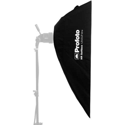

Thread started 01 Jul 2017 (Saturday) 00:34
Help with stripbox modifier purchase
Silver-Halide
839 posts
Likes: 253
Joined Jan 2015
Jul 01, 2017 00:34 |  #1
Hi gang,
I'm thinking about my first stripbox to emulate window light inside homes when a window isn't practical. I have my eye on this one on Amzn. https://www.amazon.com …l&keywords=stri​p+softbgox (external link)
It has a double diffusion element, which is new to me, so I'm wondering if I'll really need my strobe inside or if I can/should buy the speedlite adapter and if a speedlite such as YN560IV is enough power for a key light on say 1/2 power.
Other recommendations welcome. I'm really curious why some cost $250. :oops:
Thanks!
Silver-Halide
839 posts
Likes: 253
Joined Jan 2015
Jul 01, 2017 00:36 |  #2
something like thishttps://www.amazon.com …l&keywords=stri​p+softbgox (external link)
MalVeauX
"Looks rough and well used"
14,250 posts
Gallery: 2135 photos
Likes: 13370
Joined Feb 2013
Location: Florida
Jul 01, 2017 04:43 |  #3
Heya,
The difficult thing with a large/long modifier and a speedlite is the spread of light, even at 24mm on the speedlite, will produce a hot spot and have a gradient down towards the edges. A strobe is configured to have a lot more spread and will fill it better.
That said, if you want to try it with a speedlite, I would look for a version where the light bounces on a silver reflective surface, rather than firing into the box from the back. You will get a more even spread that way.
Very best,
sincity
213 posts
Likes: 50
Joined Nov 2014
Jul 01, 2017 05:03 |  #4
I probably wouldn't get such a large box especially for small speedlites. I have a 18x36 asymmetrical strip soft box for my big strobe for jewelry advertising and fashion. I think a 10x24 size is appropriate for speedlite since it won't fill that 14x63 even on the widest setting because of the fresnel section of the speedlite.
I even looked at what Westcott company does for their speedlite strip boxes, and they put in a deflector plate for speedlite to help light up the edges of the boxes they sell. See LINK~~ https://www.fjwestcott​.com/the-rapid-box-deflector-plate (external link)
As for the prices these boxes cost... Well, only the end user can answer if it is worth it. I have an asymmetrical strip that works wonders for fashion since I don't have to waste half the box on the ceiling, and on top of it I have a wonderful falloff/ feather for the dress. This is what it looks like~~
IMAGE: https://static.bhphoto.com/images/images500x500/profoto_100490_hr_1_5_x_3_0_1343996395000_884886.jpg
So it may vary on what you are looking for. Yes, you can use that 14x63 strip on Amazon with the YN560, but I believe the light will be similar to a point of light instead of a window.
mmmfotografie
hanging up-side-down in a cave
2,114 posts
Likes: 492
Joined Jul 2013
Location: Helsinki Airport
Post edited over 6 years ago by mmmfotografie. (2 edits in all)
Jul 01, 2017 05:33 as a reply to  @ sincity's post |  #5
I angle the top of the strip closer to the face and so the bottom is moving back and so you a bit the same result.
The special box above is better and I might get one.
....tinking of making it myself. Get a strip light box and a normal or square one of which is the width measures back+sides is the same as of the strip light box in the middle. Cut both in the middle and in the back of the square one I also cut out a V shape with the pointy bit towards the speed ring hole. Saw it together or use awesome tape and I think you have to shorten the rods from the square box a bit.
The leggs of the V can to be straight because the bent rod was there before so that is already present in size of the box itself.
Nick5
3,384 posts
Likes: 408
Location: Philadelphia Suburbs
Jul 01, 2017 08:16 |  #6
Silver-Halide wrote in post #18391430 (external link)
Hi gang,
I'm thinking about my first stripbox to emulate window light inside homes when a window isn't practical. I have my eye on this one on Amzn. https://www.amazon.com …l&keywords=stri​p+softbgox (external link)
It has a double diffusion element, which is new to me, so I'm wondering if I'll really need my strobe inside or if I can/should buy the speedlite adapter and if a speedlite such as YN560IV is enough power for a key light on say 1/2 power.
Other recommendations welcome. I'm really curious why some cost $250. :oops:
Thanks!
Silver.
If you want a modifier for both strobes and Speedlites without the additional need for other brackets is the Westcott Apollo. A 16x30"Strip with optional Grid. Also in the Apollo line is the 28" Medium, 43" Orb and a 50" Box as well. Opens like an umbrella. Fire the light source into the back with its silver lining and the light bounces through the front soft diffusion panel creating nice soft light.
Canon 5D Mark III (x2), BG-E11 Grips, 7D (x2) BG-E7 Grips, Canon Lenses 16-35 f/4 L IS, 17-40 f/4 L, 24-70 f/4 L IS, 70-200 f/2.8 L IS II, 70-200 f/4 L IS, 70-200 f/4 L IS Version II, 100-400 f/4.5-5.6 L IS Version II, TS-E 24 f/3.5 L II, 100 f/2.8 L Macro IS, 10-22 f3.5-4.5, 17-55 f/2.8 L IS, 85 f/1.8, Canon 1.4 Extender III, 5 Canon 600 EX-RT, 2 Canon ST-E3 Transmitters, Canon PRO-300 Printer
bobbyz
20,506 posts
Likes: 3479
Location: Bay Area, CA
Jul 01, 2017 08:24 |  #7
Cost wise, most here will never blink on $$$ on camera/lens. Good modifiers are worth it and very cheap IMHO compared to any lens purchase. I get light is light but if something makes a life little easier, it saves money. On better modifiers, fit and finish is better, grids are so much better. You can use with high wattage lights, they don't yellow that fast or change WB. I suggest spend money if you can on lighting gear.
Fuji XT-1, 18-55mm
Silver-Halide
839 posts
Likes: 253
Joined Jan 2015
Jul 01, 2017 11:28 |  #8
thank you all, keep the comments coming.
I have a bowens mount strobe, but I'd rather use a speedlite indoors if possible, since I'm lazy and all that high hanging weight of a strobe whilst moving around in confined space makes me nervous. Strip box would be for people (models) photography so I don't think 36" length would be enough to be wroth the investment and learning curve. So I guess its strobe or bust. No pun intended. Just not sure if I need one for my next shoot later this month :rolleyes:
Wilt
46,416 posts
Likes: 4503
Location: Belmont, CA
Post edited over 6 years ago by Wilt. (2 edits in all)
Jul 01, 2017 13:16 |  #9
Stripboxes aren't meant to emulate windows...how many windows have you seen that that 3-4' tall and 1' wide?!
Stripboxes are used to provide long light sources but with much less lateral spreading (that would be obtained with more squarish overall shape like 2'x3', 3'x4' that do emulate windows) which is often useful in product lighting sets
Just because a box is 3' wide does not mean that it has really hard cutoffs that make it ill suited to illuminating something 5-6' tall. I quantified to falloff from a very small softbox in this post...
https://photography-on-the.net …showthread.php?​p=17847815
Silver-Halide
839 posts
Likes: 253
Joined Jan 2015
Jul 02, 2017 03:56 |  #10
It will be for my first boudoir shoot. Are you saying that 3' is more practical than a 5-6' strip box? I assume a grid is appropriate to control light spill since we're shooting indoors.
Wilt
46,416 posts
Likes: 4503
Location: Belmont, CA
Jul 02, 2017 13:16 |  #11
Silver-Halide wrote in post #18392318 (external link)
It will be for my first boudoir shoot. Are you saying that 3' is more practical than a 5-6' strip box? I assume a grid is appropriate to control light spill since we're shooting indoors.
I am saying
  1. a stripbox is for 'more selective' dispersal of light, where you need a LONG source -- but which is not wide (so that you can more easily be selective in where light is cast)
  2. a softbox which is any particular dimension does NOT necessarily have a hard cutoff which only illiminates an area of 'same' dimension...(see how my linked test illuminated a 5' tall area with a 2' tall softbox!)
Left ­ Handed ­ Brisket
Combating camera shame since 1977...
9,925 posts
Gallery: 15 photos
Likes: 2398
Joined Jun 2011
Location: The Uwharrie Mts, NC
Jul 02, 2017 14:47 |  #12
SH, take a look at mmm's post 5. The point of the first two paragraphs is that you can achieve various looks with just one softbox. Given a decent quality box, there is no saying whether one is more or less practical than the other, rather, if it serves your purpose, it is practical FOR YOUR PURPOSE.
I tend to agree that a speedlight is not going to "fill up" a large strip box, but maybe that doesn't matter? Maybe you put the hotspot on the model's face and the part above helps provide a little more wrap around her head? Maybe that isn't what you want? Maybe grids help kill the spill inside? Maybe you want more spill?
PSA: The above post may contain sarcasm, reply at your own risk | Not in gear database: Auto Sears 50mm 2.0 / 3x CL-360, Nikon SB-28, SunPak auto 322 D, Minolta 20
windpig
Chopped liver
15,914 posts
Likes: 2255
Post edited over 6 years ago by windpig.
Jul 02, 2017 14:57 |  #13
You're not gonna fill that with a speed light, you need a bare bulb. What I like about the Fotodiox EzPro boxes is they have a deflector that redirects the light back into the reflective surface of the box (still need a bare bulb). Also, the Fotodiox are umbrella style so they are easy to deploy.
Also, a softbox isn't going to emulate window light because of fall off.
Go ahead, spin the wheel.
Silver-Halide
839 posts
Likes: 253
Joined Jan 2015
Jul 02, 2017 17:53 |  #14
Ok consensus received: no being lazy. Strobe or don't bother. No speedlites. Thanks
Silver-Halide
839 posts
Likes: 253
Joined Jan 2015
Jul 02, 2017 17:55 |  #15
Left Handed Brisket wrote in post #18392648 (external link)
SH, take a look at mmm's post 5. The point of the first two paragraphs is that you can achieve various looks with just one softbox. Given a decent quality box, there is no saying whether one is more or less practical than the other, rather, if it serves your purpose, it is practical FOR YOUR PURPOSE.
I tend to agree that a speedlight is not going to "fill up" a large strip box, but maybe that doesn't matter? Maybe you put the hotspot on the model's face and the part above helps provide a little more wrap around her head? Maybe that isn't what you want? Maybe grids help kill the spill inside? Maybe you want more spill?
I mainly have in mind where a model has a strip of even light on the side of her body/limbs that is even and has some fall off across the body part. That's actually the main developmental practice goal I have from the shoot: Feathering light across the curved surface of mostly unclothed body parts.
8,417 views & 10 likes for this thread, 10 members have posted to it and it is followed by 4 members.
Help with stripbox modifier purchase
1320 guests, 135 members online
