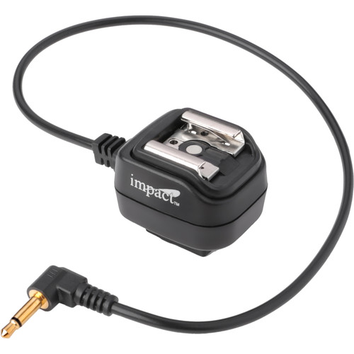

Thread started 20 Aug 2018 (Monday) 11:44
Thoughts on using a 580EX II or a 550EX with a 600-EX?
stanwelks
201 posts
Aug 20, 2018 11:44 |  #1
I'm pretty new to flash lighting, and I am using a 5DM3 and a 600-EX for portraits, along with PocketWizards to wirelessly trigger the flash. Someone wants to sell me real cheap a 580EX II and a 550EX.
1. Can either of these flash units be put into slave mode to act as a second light? If not, is there a way to trigger them as a second light?
2. Any thoughts in general on using either of these two flashes along with my 600-EX as a second light?
3. Will PocketWizards work with either of the two lights to trigger them?
Thanks.
CyberDyneSystems
Admin (type T-2000)
52,908 posts
Gallery: 193 photos
Likes: 10101
Joined Apr 2003
Location: Rhode Island USA
Post edited over 5 years ago by CyberDyneSystems.
Aug 20, 2018 13:15 |  #2
Both can be used if your 600 is set to optical master (vs. radio)
The 580EXII will add a number of features and groupings that the 550 lacks, and the interface will be more like the 600, but you should still be able to use the 550 as slave no problem.
No need for PWs.
GEAR LIST
CDS' HOT LINKS
stanwelks
201 posts
Aug 20, 2018 14:10 as a reply to  @ CyberDyneSystems's post |  #3
Sorry, got a bit confused...
1. I use Pocket Wizards with my 5DM3 and the 600-EX. Are you saying I do not need to use PocketWizards to wirelessly trigger the 600-EX?
2. Can both be used at the same time with the 600-EX?
Thanks.
Phil ­ V
1,977 posts
Likes: 75
Joined Jan 2005
Location: S Yorks UK
Aug 20, 2018 16:56 |  #4
The short answer is that if you’re used to using the pocket wizards, just put the new flash on one and extend your options.
The more complicated answer is around the 600ex having its own receiver built in, you just need a compatible transmitter for it, you can sell the pocketwizards and extend your options.
website: South Yorkshire Wedding photographer in Doncaster (external link)
Twitter (external link)Facebook (external link)
Nick5
3,384 posts
Likes: 408
Location: Philadelphia Suburbs
Aug 20, 2018 18:07 |  #5
Do you have the 600 EX-RT? If so, Invest in the Canon ST-E3 RT Transmitter. Don't buy the other non radio based flashes like the 580 EX-RT or 550 EX. Why not take advantage of the Radio Based 600 EX-RT?
Canon 5D Mark III (x2), BG-E11 Grips, 7D (x2) BG-E7 Grips, Canon Lenses 16-35 f/4 L IS, 17-40 f/4 L, 24-70 f/4 L IS, 70-200 f/2.8 L IS II, 70-200 f/4 L IS, 70-200 f/4 L IS Version II, 100-400 f/4.5-5.6 L IS Version II, TS-E 24 f/3.5 L II, 100 f/2.8 L Macro IS, 10-22 f3.5-4.5, 17-55 f/2.8 L IS, 85 f/1.8, Canon 1.4 Extender III, 5 Canon 600 EX-RT, 2 Canon ST-E3 Transmitters, Canon PRO-300 Printer
inkista
700 posts
Likes: 95
Location: San Diego, CA, USA
Aug 20, 2018 19:11 |  #6
Just feel I should mention that the 550EX doesn't have a PC sync port. If your PW triggers require cabling to a sync port, you'll need to add a sync adapter to the foot of the 550EX.
I'm a woman. I shoot with a Fuji X100T, Panasonic GX-7, Canon 5DmkII, and 50D. flickr stream (external link)
RicoTudor
676 posts
Likes: 386
Joined Jul 2014
Location: Chicago, IL
Post edited over 5 years ago by RicoTudor.
Aug 20, 2018 19:25 as a reply to  @ inkista's post |  #7
True, and here's the adapter I use:
IMAGE: https://static.bhphoto.com/images/images500x500/1440680709000_1130419.jpg
I have a 550EX and 430EX fully integrated with my PW-triggered Profoto packs. The Impact adapter is well made, and has a metal 1/4"-screw receiver for grip gear.
Ref:
https://www.bhphotovid​eo.com …scs_m18_sync_co​rd_12.html (external link)
Canon, Nikon, Contax, Leica, Sony, Profoto.
ra40
2,089 posts
Gallery: 887 photos
Likes: 3557
Joined Jan 2013
Location: So. Cal
Post edited over 5 years ago by ra40.
Aug 24, 2018 17:24 |  #8
The 600RT has an optical mode to trigger the non RT type flashes. They work well for line of sight but may not reliably trigger if there is some blockage. Have to make sure the transmitter is going to be able to be seen by the receiving units receptor. The 600RT will be able to control those flash units to so that is a really nice aspect in multi flash instances and grouping them.
I use a 600RT-II with a 580EX frequently but with a radio trigger system. My other suggestion may be to pick up and 430 EX RT unit at ~$200 (refurbished) to expand on your 600RT and have a compatible Canon RT system. The optical works well just that it is aging tech and the radio trigger is easier IMO.
1,994 views & 7 likes for this thread, 7 members have posted to it and it is followed by 4 members.
Thoughts on using a 580EX II or a 550EX with a 600-EX?
1322 guests, 135 members online
