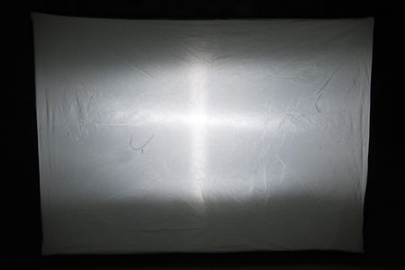

Apr 04, 2021 11:49 |  #5
Dave,
Quick summary
Monolights
  • Requires AC, unless battery back powered
  • Modelling light allows the photographer to SEE how the lighting complements the sitter's face to be advantage, not accentuating features that might detract
  • Softboxes provide softer illumination, white reflector heads provide harder lighting
  • Bare tube best used with softbox
  • Fan heads allow modelling lights and frequent high power flashes, without fear of overheating
  • not as transportable as speedlights
  • generally not xTTL compatible; manual power control
In short, if you want to best flatter the sitter with light optimized for their face, you can best use studio lights
Speedlights
  • Portable, requires no AC
  • Lightweight and compact...multiple heads minimal space to store/transport
  • generally xTTL compatible; manual power control
  • more limited softbox size )than studiio flash) for attachment flash head
  • forward facing flash head creates 'hot spots' in larger softboxes (see illustration)
  • 'modelling light' (flashtube) feature not as beneficial as modelling lights on studio flash...
  • 'modelling light' (flashtube) consumes battery power, and can overheat flash head
  • no fan cooling to remove heat buildup in head from rapid shooting
In short, if you merely want to ILLUMINATE a scene, speedlights will do the job more portably than studio lights.
Multiple speedlights radio controlled and ratio'd remotely can very well mimic what you do with studio lights to 'illuminate', especially for group shots in which no ONE person is being photographed for a formal portrait. But it is typically more challenging to 'light' for optimized subject flattery without true modelling lights, especially when the flash tube itself is used for 'modelling light' function, and an experienced and knowledgeable person is not using them.
UPDATE: There are emerging some speedlights (very expensive, from Canon) which use LED sources (not flash tube) for the modelling light function, which can be left on for minutes without overheating the head and draining your batteries.
IMAGE: https://hosting.photobucket.com/albums/i63/wiltonw/IMG_7606.jpg?width=590&height=370&fit=bounds
IMAGE LINK: https://app.photobucke​t.com …b5-944146080a2b?mode=zoom  (external link) st

i have since tweaked the lights to fill the umbrella a bit more. this was right after setting it up and evaluating the angle of zoom and if there was any "tilt" needed on the heads...
this is 3 600ex rts on a mount that has the umbrella shaft right through the middle of them all...
the speedlites were at 1/4 power and i was shooting at 1/200, f4, ISO 200 and getting good results. i dont think im giving up anything shooting like this so i think something along the lines of a 300ws strobe would be fine...
ive since seen a 3x godox kit with stands and umbrellas and transport case for a pretty good (I think) price. about $600-ish. that would give me a lot of lighting (i could have 3 lights going in a session) for a reasonable cost...
i just need to crap or get off the pot, i guess....
