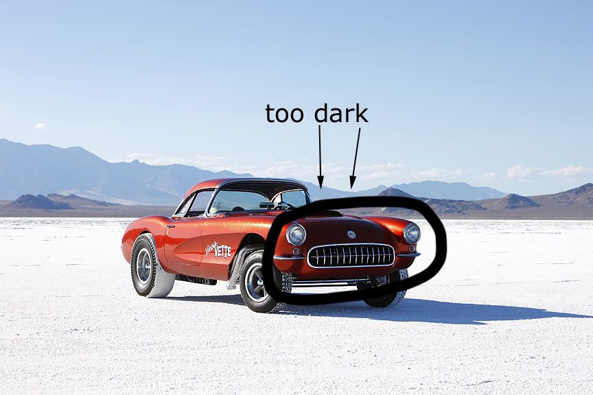

The strobe on the truck was to the side and the back of the truck. You can notice a slight shadow on the salt in front of the truck.
Here are a couple of examples, hope they help.
IMAGE: http://i519.photobucket.com/albums/u354/RG-Photography/light-1.jpg
Bracketed shots with reflectors lighting up grill. All I focused on was getting the grill lit up in this frame.

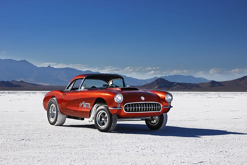

IMAGE: http://i519.photobucket.com/albums/u354/RG-Photography/light-2.jpg
Final photo. After a couple of bracketed shots and working in layers in photoshop. Shoot a few frames with different areas of the vehicle lit up. (keep your camera registered on a tripod) You can get great results with only $100 dollars worth of reflectors.
