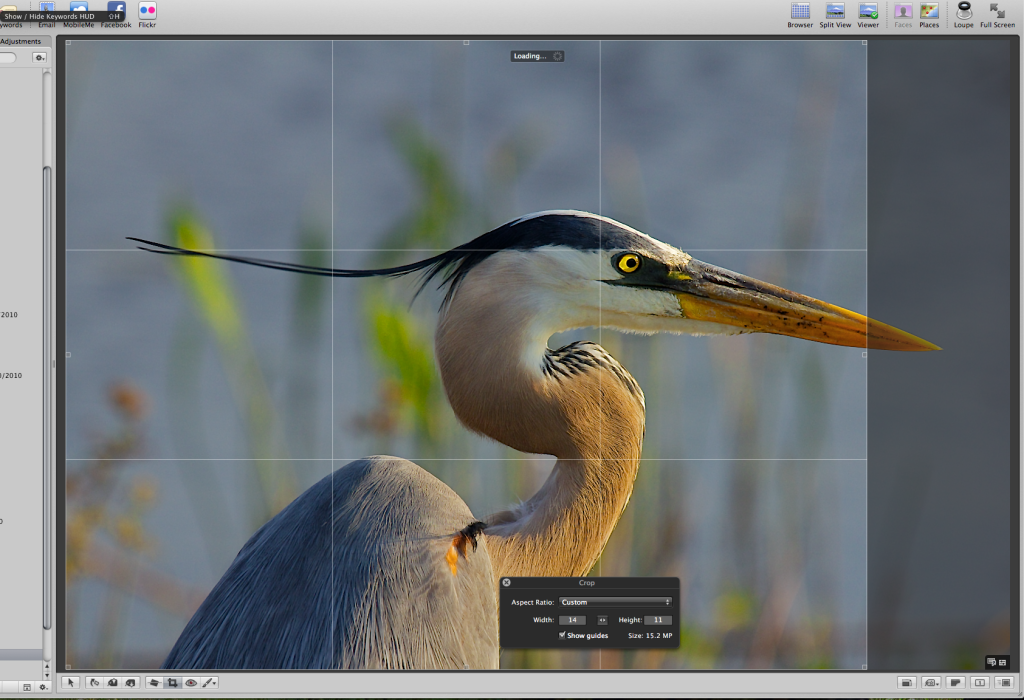

Ok great, but onto another problem. The two pictures that had the cropping issues, can a picture be to large to print on 11x14?
I cannot figure out on Aperture 3 how to crop it in 11x14 and the crop boxes go around the entire bird. Any ideas?

add some space to the top and bottom of the image? or print 11x17 :D
