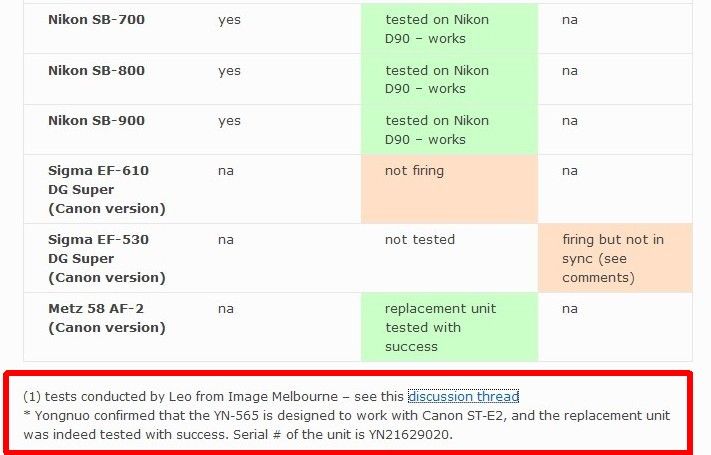

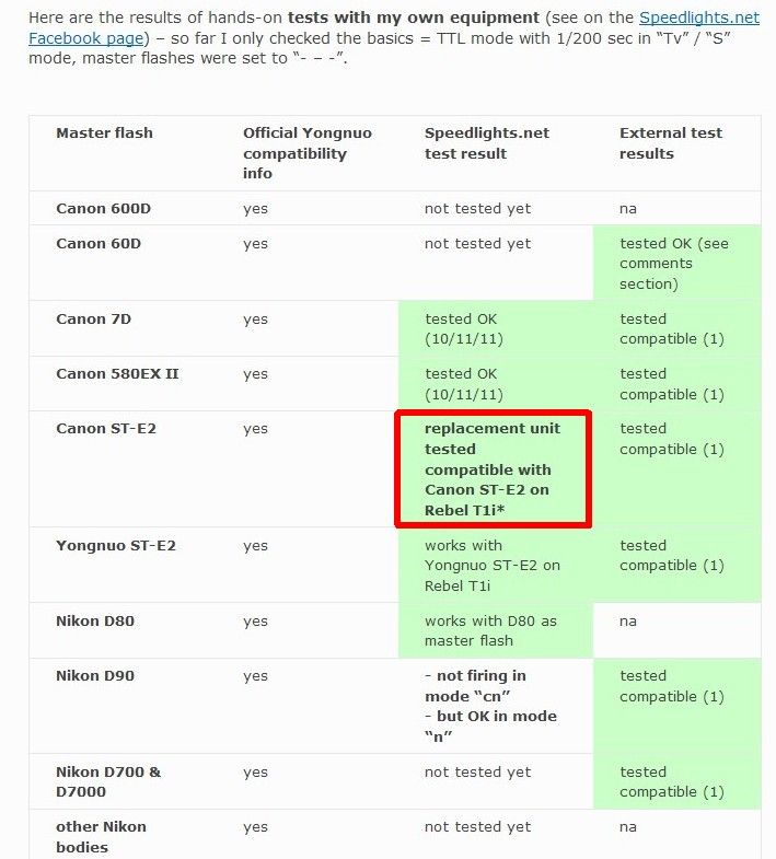

FrancoisM wrote in post #13385098 (external link)
Fransener from speedlights.net says the contrary.
Read this page (external link)
Under the "Master Flashes – Compatibility List" paragraph
I tend to trust more Fransener than the Amazon self proclaimed "reviewers"
F.
In the fine print he confirms that his first copy did NOT work with the ST-E2 and only the sceond one did work.
http://speedlights.net …eview/#Compatib​le-Masters (external link)
IMAGE: http://i2.photobucket.com/albums/y17/msowsun/photo%20stuff/Photo7/_1-41.jpg
IMAGE: http://i2.photobucket.com/albums/y17/msowsun/photo%20stuff/Photo7/_1a-15.jpg

Nov 11, 2011 11:49 |  #267
Thanks for the links. I haven't totally ruled out user error but I don't think there's much else to try at this point. I can use my st-e2 with the canon flash still so the controller isn't the issue.
It's interesting that the tester from your last link got the 2nd one to work but not the 1st. I wonder if it could have been a bug that they fixed but didn't want to acknowledge? I kind of doubt it, but it crossed my mind... I was one of the guinea pigs for the flash, I ordered it back on 8/10 right after it came out.
I tried "S1" and "S2" optical modes as well to see what it did. "S1" does the same thing as "SL" (slave), it triggers at a preflash or something and doesn't show in the shot. "S2" triggering in manual does work using either the st-e2 or another flash on camera.
