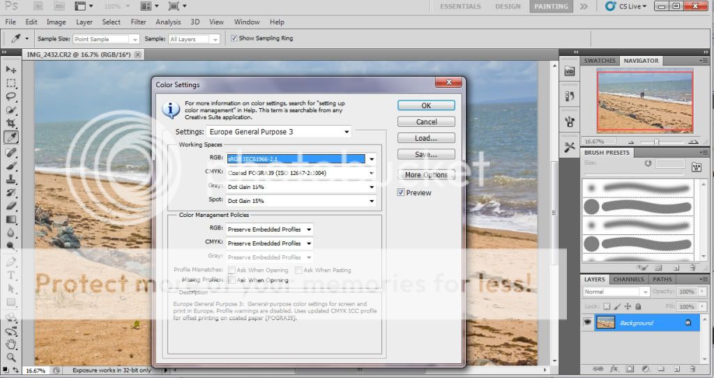

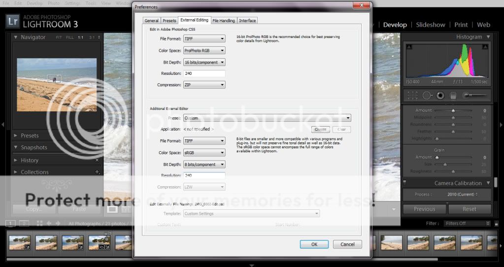

Ok mate i searched long and hard to find these settings, please tell me if these are the ones you speak of and please tell me what i should change these settings too to get the best colour , i want my pics to be able to be viewed exactly how i have edited them

To start with, let's get "safe". In Lightroom, change that Color Space setting to sRGB. In Photoshop, you are set up to be working in sRGB "sorta", but when you get a ProPhotoRGB file from Lightroom Photoshop does not convert it. So, unless you specifically convert it (this can be done through Save for Web but you need to know what you are doing) then your colors will be off (as you've seen).
So make the change in Lightroom Preferences (and do this the next time you do an Export) and things should improve, but in the Photoshop Color settings you want to do things thoughtful -- you can either automatically convert to sRGB or you can have Photoshop prompt you, but the way you have things is like "blah who cares?" and an image can go through your setup in a bad color space.
Glad you found those dialogs and got them up, it clears things up!
Now, if you want a bit more "control", sure you can keep Lightroom sending things to Photoshop in ProPhotoRGB but you will always have to convert the image yourself through the Edit/Convert function to sRGB. So, for now, why bother until you have a reason!
