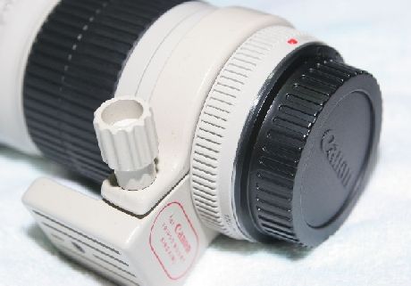

Do you have the tripod ring on backwards? The foot should face towards the front of the lens. I know the grip is rather large, but in the photos I have seen it doesn't stick out any farther than the lens mount. I don't see how the foot could interfere if it is facing the right way. Can you show us a side picture?

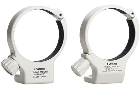

If you do have it on the right way, You might need to get the newer version of the triod mount ring with the sloping back. See review here: http://www.the-digital-picture.com …unt-Ring-A-II-Review.aspx (external link)
A(W) vs A II (W)

I guess depending the the tripod head, it could interfere. Especially if there is a large Quick Release plate or bulky older head. Could be time for a new tripod head.
I wonder if the newer A II (W) Tripod Ring with the sloping back would change the position enough to clear the grip. Maybe that's why they updated the old one. :confused:

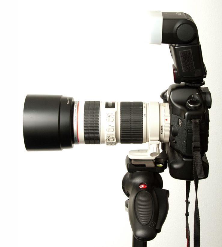

Here is a guy with a similar problem: http://www.flickr.com/​photos/victormk1/48219​69148/ (external link)
During my testing of the Manfrotto 327rc2 and 324rc2, I noticed a design flaw: when mounting a camera with a batterygrip and a lens with a tripod collar, the quickrelease locking handle hits the battery grip. Manfrotto's solution is to rotate the quick release plate on the collar 180 degrees. The problem with that is that the joystick grip has to be rotated 180 degrees too. Switching the grip from left to right (or vice versa)
I found a better solution. First rotate the tripod collar to the portrait position. Mount the camera with lens to the ballhead. Rotate the camera to landscape orientation.
With a 5D there is a couple of milimeters clearance between the locking lever and the batterygrip.

If the problem is similar to the picture above, couldnt you just mount the plate 'backwards' so that the release lever is under the lens?

Yes, spin the clamp around so the lever is facing forward.

I had the same problem when using the Manfrotto QR plates and just turned the plates around. Problem has disappeared with my new head and Arca type plate
