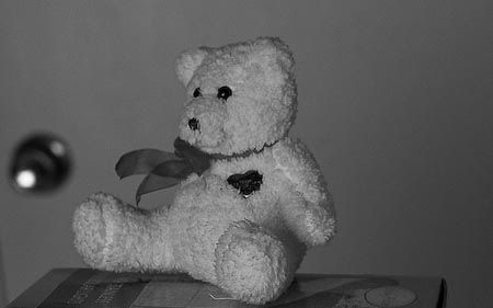

I think I am seeing an issue created entirely by semantics, about 'directional'. On one hand a specular light is hard and directional in nature, while a large source is soft and 'not directional' ' -- that is, not 'directional' in the sense that for every one of the countless points on the surface of a softbox, light is emering from that point in all directions in a hemisphere of light, so that array of points makes for a very non-directional source (compared to the single specular source).
OTOH, even a large source can impart a 'sense of direction' of the source (or not). Here are two examples with a single, very large source. The sense of directionality of light source's position is more apparent on one shot, even though it is very soft (that is, no shadow penumbra), whereas the second shot has a much reduced sense of directionality about the source position. In this example pair, the directionality of the source's position is related to the contrast between highlight and shadow regions, which is entirely due to source-to-subject distance and the Inverse Square falloff.
IMAGE: http://i69.photobucket.com/albums/i63/wiltonw/Lightdistance-2.jpg
IMAGE: http://i69.photobucket.com/albums/i63/wiltonw/Lightdistance-1.jpg
