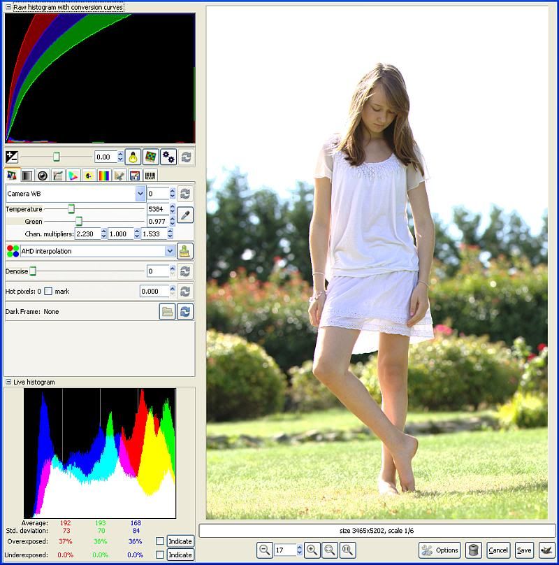

Wow, I've just installed the latest version of GIMP, 2.6.11 for Windows, with the Help install, and then finally UFRaw. I didn't expect it to work with my 60D RAW files, but it does.
I have no idea what all this means, but is certainly looks interesting:
IMAGE: http://i801.photobucket.com/albums/yy298/captivatedbybeauty/technical/UFRaw1.jpg
That's just opening the CR2 file with UFRaw. I picked this image because I forgot I was in manual mode when we switched location, didn't change the settings, and the 1st couple of shots were rather bright. But luckily this one was recoverable from the RAW file.
I thought you guys would like to see my very first experience with UFRaw. Now to investigate.....I may be gone some time :)

OK, I've only got DPP to compare with. UFRaw seems to have a lot more in it. I can just drag a CR2 file into GIMP and UFRaw just opens. Then when I'm done, I can click a button and GIMP opens with the image with no intermediate file needing to be saved.
Here's a quick list of what I've found:
Exposure compensation +/-6 EV - DPP only has +/-2 EV.
Exposure options: Restore details for negative EV, Clip highlights for positive EV, Auto adjust - not sure how well these work or quite what they do.
White balance:
- Camera WB displays temperature used - I've not found how to do that in DPP.
- It shows channel multipliers - I think this could be handy too.
- Denoise - I'll probably leave this at 0 and do the noise/sharpening in GIMP.
Greyscale mode
Lens Correction
Base Curve:
- Linear curve & Manual curve (curves tool)
- Colour Management
- Gamma
- Linearity
- Output intent
- Display intent
Current luminosity and Saturation
- Auto adjust black and white points
Lightness adjustment
Crop and rotate
Send image to GIMP
I suspect I'm not going to be using DPP much more.
