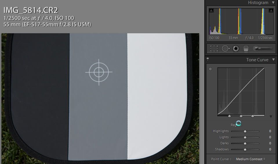

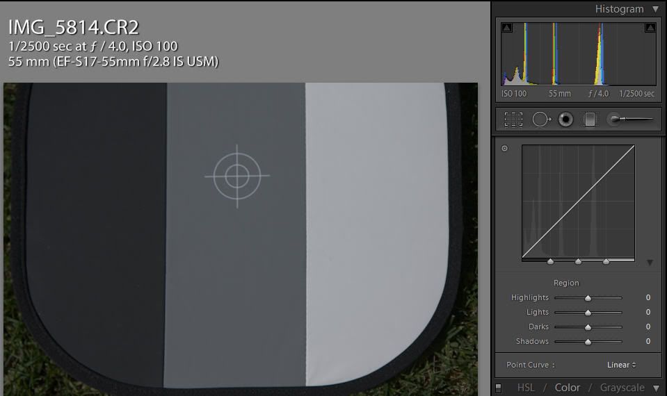

Working in M, I just move a wheel 9 clicks. Below are two versions of a white cloth with +3 exposure. I shot it with the 5D2 in UniWB for the purpose of this illustration so that DPP's RAW histogram would more closely reflect the RAW data and the second version is after click WB. As you can see, in the first version there is lots of headroom before clipping (when I move the Brightness slider to the right, the clipping warning starts to appear at +0.67 - gotta love that 5D2) and even after WB it is still just short of clipping.
Warning to jpg shooters: When the camera processes a jpg it routinely clips about a stop off the top of the capture data, thus a jpg will blow at roughly 2.5 stops above medium grey.

In further investigation into the thread topic, I decided to photograph the PhotoVision target, to see where the 18% area falls within the histogram, compared to the white area and the black area. Shooting with the 18% area metered with the spot meter, and zeroing all the values in Lightroom, this is the result...18% area spike is just to the left of the center.
IMAGE: http://i69.photobucket.com/albums/i63/wiltonw/Meter18sun5025.jpg
But wait...for that result, the Brightness was at 50 and Contrast was at 25. If we change the Brightness and Contrast controls to 0, 0 (rather than 50, 25), here is what results...
IMAGE: http://i69.photobucket.com/albums/i63/wiltonw/Meter18sun00.jpg
What this seems to point to is the principle which WayneF was trying to make...that the midtone value's position on the histogram is a very arbitrary tonality! And relative to the 'meter 18% vs. meter 12%' question which started this thread, there is no real conclusive answer!
