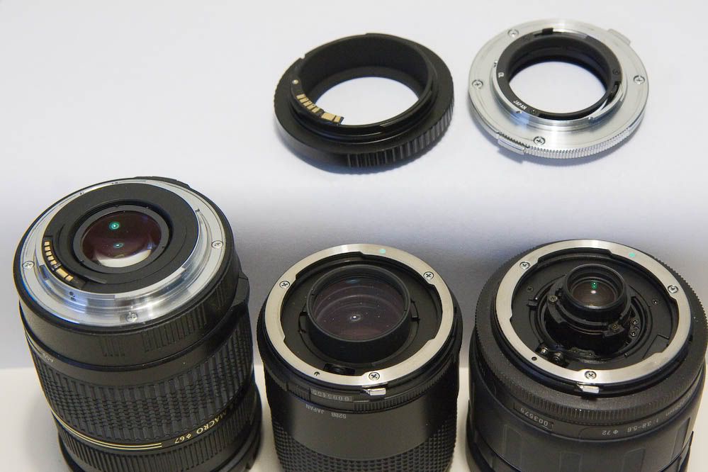

boguz wrote in post #12136016 (external link)
hmmm, sorry :oops: but what does that mean?
Here is a photo of three Tamron lenses.
IMAGE: http://i69.photobucket.com/albums/i63/wiltonw/Equipment/Tamronmount-1.jpg
  1. The left Tamron has a permanent EF mount which is not removeable from the lens. The Canon electrical contacts permit full operation of f/stop and focus electronically controlled by the camera.
  2. The middle one is a Tamron Adaptall 2 lens, and the mechnical linkage within the lens is visible at about the 6:30 position. But the Adaptall 2 EF mount adapter is located removed from the lens. It has electrical contacts, so that AF confirmation works, and also the adapter can report one FL and the max aperture of this lens, but no AF and no aperture control is available, since there is no communication between the electrical contacts of the adapter and the mechanical controls of the lens.
  3. The right lens is a Tamron Adaptall 2 lens and the mechnical linkage within the lens is visible at about the 6:30 position. Again, the Adaptall 2 OM mount adapter is located removed from the lens, and you can see it has levers visible (mechanical linkage to similar levers in the camera body (Olympus in this case), and this couples the body's automatic lens diaphram controls to the lens' linkage mechanism.
