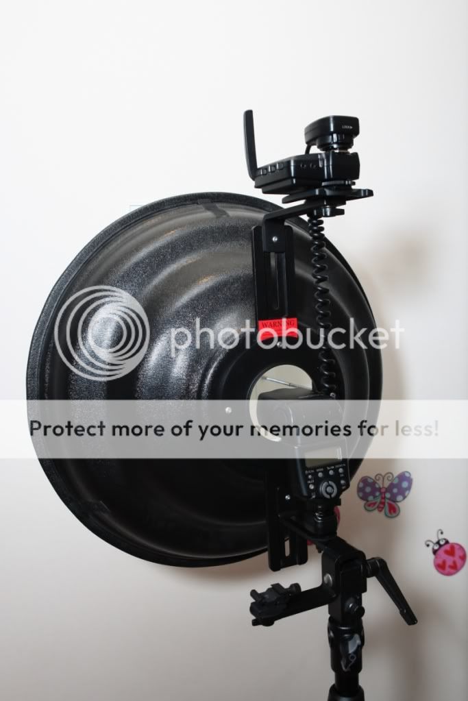

Here's a horrible photo but this setup with no RF sock I can get a good 350ft range. With a sock I can get similar results with my 580exii. I love this double bracket he offers.
Kacey's dish is great. I sandwich the metal disk can acrylic mirror together. Depending on what I shoot I can swap them around no problems.

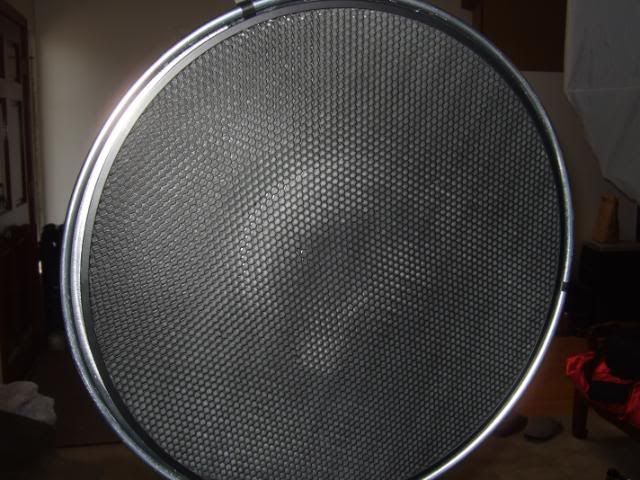

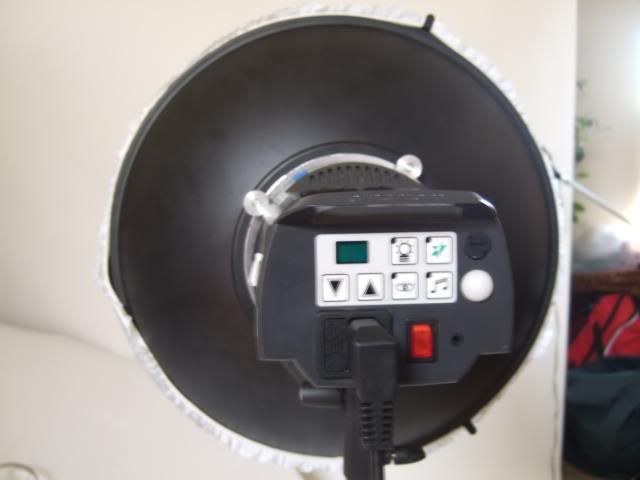

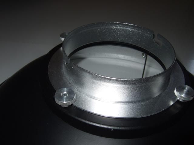

IMAGE: http://i62.photobucket.com/albums/h120/c2thew/DSCF1642.jpg
IMAGE: http://i62.photobucket.com/albums/h120/c2thew/DSCF1644.jpg
IMAGE: http://i62.photobucket.com/albums/h120/c2thew/DSCF1645.jpg
Flickr (external link) |Gear|The-Digital-Picture (external link)|The $6 mic | MAGIC LANTERN (external link) | Welding Filter

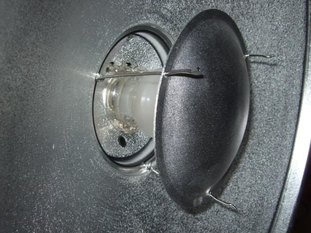

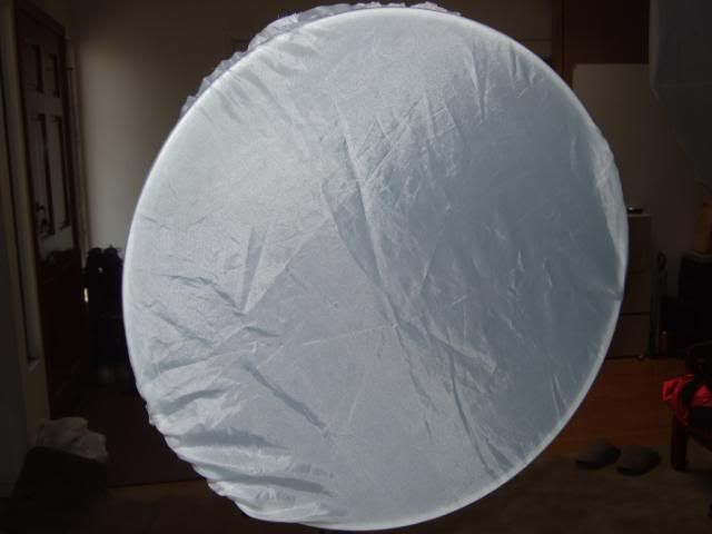

IMAGE: http://i62.photobucket.com/albums/h120/c2thew/DSCF1647.jpg
IMAGE: http://i62.photobucket.com/albums/h120/c2thew/DSCF1648.jpg
pictures of the ebay beauty dish. This is actually a very solid piece of equipment even though the three wires might make the beauty dish seem less durable. what you should be more interested in is the size of the beauty dish as in many cases size matters in relation to the quality/softness of the light.

That flash tube in these shots looks recessed, is that the case?

looks recessed to me, though not by much. doesn't affect light behavior too much except perhaps at the side.

The position of the flash tube absolutely affects light behavior. Whether or not it's visible or noticeable is another issue but there is certainly a good argument for wanting the flash tube to be in the optimal position.

The placement of the flash tube is a function of the insert used, not the beauty dish. The insert with the shortest neck gets the flash tube further inside and the very deep inserts place the tube inside too far back, shielded by the insert.
I don't know the optimal placement but I'm fairly sure that you want as much of the flash tube to be in front of the insert as possible. If you look at an Elinchrom lightbox mounted you can gauge and/or measure to see where Elinchrom has placed the flash tube. That's a good place to start. :)
