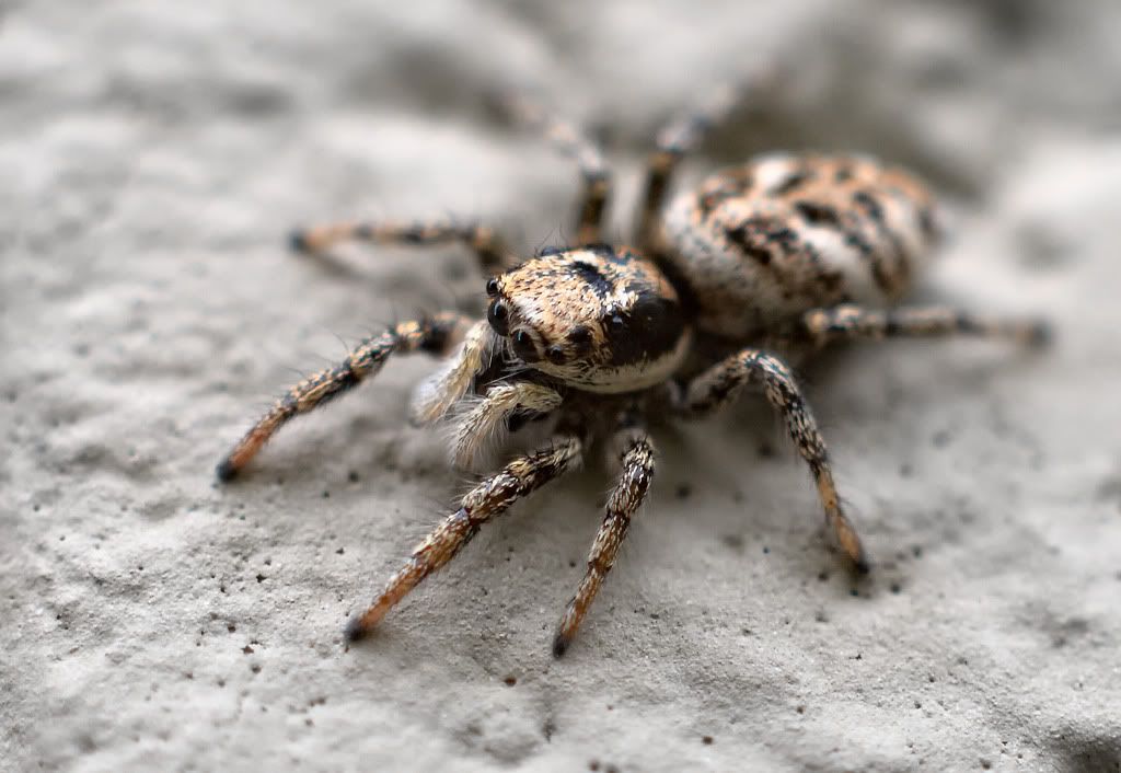

Apr 21, 2011 01:52 |  #11
Well, here's an image that people have said is noisy...
IMAGE: http://farm6.static.flickr.com/5267/5595059989_331e015513_b.jpg
IMAGE LINK: http://www.flickr.com …end_the_light/5​595059989/  (external link)
jumping spider 1 (external link) by http://bendthelight.me​.uk (external link), on Flickr
And the RAW is hosted here...
http://www.mediafire.c​om …4epov9sb449y/_M​G_8811.CR2 (external link)
If anyone wants to have a go and process this anyway they like, THEY CAN. Any help in my processing would be appreciated. :)

Apr 21, 2011 04:53 |  #12
From looking at your CR2 file I could see several things you did that increased the noise. I am not saying they were wrong things to do, only that you should understand that they carry the price tag of increased noise.
1. You cropped the original 2592x3888 pixel image down to 1520 x 1900, which would have been 1520x2280 before it became 4:5 in aspect ratio. In other words you went from 10 MP to 3.5 MP. This makes the noise more visible even in the web version because it is downsized less.
2. You greatly increased contrast and saturation.
3. You did some extreme sharpening to try to compensate for the softness of the original.
Incidentally, the posted image is in the Adobe RGB space. This means that people using a non-color managed browser will see it as flatter and less saturated than it really is, which will hide some of the noise.

René ­ Damkot
39,856 posts
Apr 21, 2011 05:18 |  #13
Edit: Elie was posting, while I was editing ;)
Edit2: My image is closer to your DPP edit. (Probably since I used "Camera Neutral" in LR.) Your DPP edit is pretty good.
Few "problems" with the image: First, it's in AdobeRGB, so it will display wrong in any browser that isn't colormanaged.
Second: It's a fairly heavy crop, with *very* drastic contrast alterations. That brings out the noise.
Also: The sharpening settings used in ACR could be optimised: Maybe something like this: (This is LR, but you get the point)
IMAGE: https://img.skitch.com/20110421-1xq6mw2t5kndqb3w69wnnrifjx.jpg
Different settings, no editing in PS, just LR:
Exif with LR settings is in the image. If you don't have an exif reader, try this link:
http://regex.info …fer%2FPOTN%2F_M​G_8811.jpg (external link)

Apr 21, 2011 05:25 as a reply to  @ Bend The Light's post |  #14
Well, the image above was captured with a 400D @ ISO400 after all, and from my experience with that camera, I can say it doesn't take too well to increases in ISO.
In any case, here's a version I processed, I had do a bit of black magic on this one, so not a hint of noise anywhere.
IMAGE: http://i418.photobucket.com/albums/pp263/ThisIsHey/spider.jpg
And the processed tiff: http://www.mediafire.c​om/?x4tj25izt52vtl5 (external link)
Nothing he could have done about cropping, alas, as the spider is rather small in the frame. I managed to get around the noise by turning off all NR and sharpening in the converter (Capture One can do this), and out putting a flat-ish image that I ran through Nik Dfine in PS as the first step, image was inherently soft, so I didn't lose anything by doing so. The rest was careful contrast and sharpness enhancement with masks and blends so as not to aggravate the noise.

Apr 21, 2011 08:54 |  #15
I had to go out for several hours but I'm back now and here's my take. I think the RAW is overexposed so I reduced Exposure by 1 stop, which, of course, gave a leg up on the noise. I lifted only the yellow by using HSL and brushed in a little negative Clarity on the OOF background.
