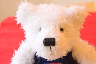

There is definitely a limit to what can be done even with exposure corrections done in RAW conversion!
First, a series of shots, shot as metered with incident light meter and others overexposed up to +3EV...
0EV
IMAGE: http://i69.photobucket.com/albums/i63/wiltonw/Asshot-1-2.jpg
;1EV
IMAGE: http://i69.photobucket.com/albums/i63/wiltonw/Asshot-2-2.jpg
2EV
IMAGE: http://i69.photobucket.com/albums/i63/wiltonw/Asshot-3-1.jpg
; 3EV
IMAGE: http://i69.photobucket.com/albums/i63/wiltonw/Asshot-4-1.jpg
All shots treated identically for RAW conversion parameters (no adjustments at all)

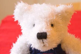

Apr 11, 2011 11:51 |  #11
Now, above four shots, as corrected during RAW conversion...
0EV
IMAGE: http://i69.photobucket.com/albums/i63/wiltonw/Ascorrected-1.jpg
; -1EV
IMAGE: http://i69.photobucket.com/albums/i63/wiltonw/Ascorrected-2.jpg
-2EV
IMAGE: http://i69.photobucket.com/albums/i63/wiltonw/Ascorrected-3.jpg
; -3EV
IMAGE: http://i69.photobucket.com/albums/i63/wiltonw/Ascorrected-4.jpg
