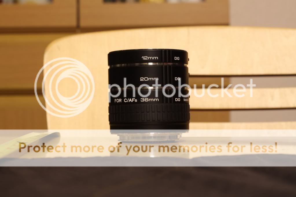

Kenko Extension Tubes 12mm, 20mm, 36mm

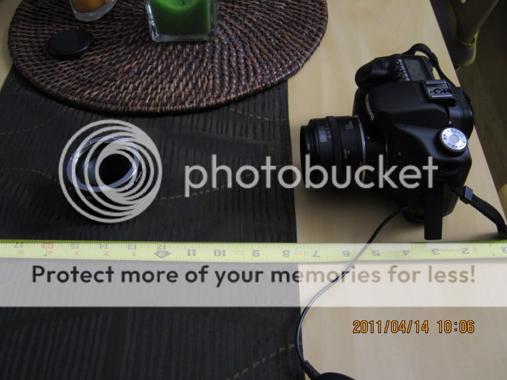

Now we use a 12mm Extension Tube. Notice the subject has to be closer now.
IMAGE: http://i536.photobucket.com/albums/ff321/looneymoogle/Extension%20Tubes/12mmIQ.jpg
IMAGE: http://i536.photobucket.com/albums/ff321/looneymoogle/Extension%20Tubes/12mm.jpg
And now the 20mm Extension Tube. Notice the distance is shorter and also the subject fills-up more of the frame.
IMAGE: http://i536.photobucket.com/albums/ff321/looneymoogle/Extension%20Tubes/20mmIQ.jpg
IMAGE: http://i536.photobucket.com/albums/ff321/looneymoogle/Extension%20Tubes/20mm.jpg

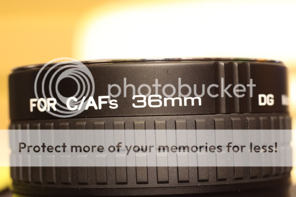

And lastly the 36mm Extension tube. It was real hard trying to get a focus because with extension tubes you lose infinity and it was real short between MFD and infinity. Shot @ f/8 ISO 800 exposure time 25sec
IMAGE: http://i536.photobucket.com/albums/ff321/looneymoogle/Extension%20Tubes/36mmIQ.jpg
IMAGE: http://i536.photobucket.com/albums/ff321/looneymoogle/Extension%20Tubes/36mm.jpg

Now the tubes are stackable so thats what i did. a 20mm and 36mm stacked together for a total of 56mm extension. Now i had to shoot this f/8 ISO 1000 to avoid exceeding 30sec exposure time.
IMAGE: http://i536.photobucket.com/albums/ff321/looneymoogle/Extension%20Tubes/2036mmIQ.jpg
IMAGE: http://i536.photobucket.com/albums/ff321/looneymoogle/Extension%20Tubes/2036mm.jpg
So what have we learned?
1)The higher the amount of extension tubes you use, the closer you have to be to the subject.
2)As you add on more tubes, your depth of field shortens (because you lose infinity)
3)By adding extension tubes, it does NOT affect your aperature unlike tele-converter/extenders
4) Extension tubes are fun! (if your into macro at least)
