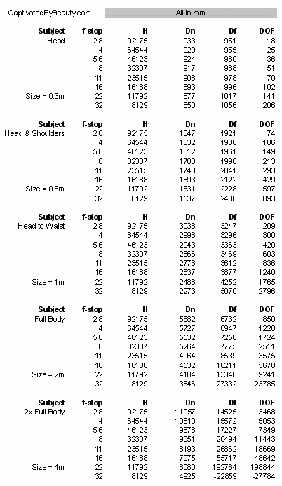

So far I have only seen a few people mention that DOF is NOT changed by changing the focal length of the lens. Yes, really. I know some people already know that, and won't be surprised. Yes, the range of distances that will be considered "in focus" does not change with focal length. A longer focal length decreases the Angle of View (AOV), and also "enlarges" the background, making the out of focus regions look more out of focus.
So to get a certain image, one will choose a focal length for AOV and the background.
And, given a certain framing of the subject, one will pick the aperture for the DOF of the subject wanted.
Most people get directed towards the well-known online DOF tables. Enter focal length and distance from camera to subject, CoC, and get the DOF out.
But why is focal length requested when it doesn't affect the DOF? Because the tables combine focal length and distance. All they really need is the framing size. The size of the subject that will fill the frame.
I wanted a quick reference table for DOF, so used the online DOF table, and created one for a 200mm lens. Then I created another one for a 70mm lens.
And then went duhhhhh, look they are the same, why didn't I remember that focal length doesn't change the DOF?!
I wouldn't have noticed they were the same is I hadn't used distances from camera to subject calculated for the same framing of people. But I did, so I did :)
And that is why I created this table:
IMAGE: http://i801.photobucket.com/albums/yy298/captivatedbybeauty/technical/DOF_Table.gif
It is for portrait photographers, because it only works for people size subjects. It's for 1.6x cameras with the standard CoC used.
This is how you can use it:
1. Pick your framing. Want a head and shoulders? Pick the head&shoulders sub-table.
2. Pick your aperture. Say f/4.
3. Go across to the DOF column, and read 106mm. That's the DOF.
If you are taking pictures of people, and can remember what the body parts are called (head, shoulder, waist LOL), then this one table is all you need, and you don't need a tape measure and you don't need to check how much you've zoomed. If you zoom with your feet and zoom with the lens to get the same framing, you'll know it makes no difference. Just look at the framing you've got, pick the sub-table, aperture, and read the DOF.
Hopefully some will find that useful.

Note that I did not mention focal length as influencing depth of field. Even though telephoto lenses appear to create a much shallower depth of field, this is mainly because they are often used to magnify the subject when one is unable to get closer. If the subject occupies the same fraction of the image (constant magnification) for both a telephoto and a wide angle lens, the total depth of field is virtually* constant with focal length!

I agree, I don't look at my table much now! But I think for people new to photography with narrow DOF (not point and shoots), hopefully, my table will make the learning experience easier and quicker.
And when asked a question, I can point to this article rather than having to write the explanation out again :)

I would say that instead of stating "focal length doesn't matter" when discussing DOF, wouldn't it be more accurate to phrase it "changing your focal length and changing your distance to the subject will have the same affect on your depth of field"? Yeah, you can talk about the framing, but you change the framing by either changing your focal length or your distance to the subject. I don't want to bicker about this, it just seems like you can point out both factors. Like you said, your approach may work well for portraits, but one thing that is important, and that is that your choice between changing your focal length or your distance can make a big difference in the perspective, which you want to consider, and still retain your DOF considerations. Just my thoughts.

I have to admit to making oversimplified statements about 'DOF does not change when the subject size stays the same in the frame, as FL changes." I just used the Cambridge Color flexible DOF calculator to calculate DOF at a series of FL (15mm, 30mm, 60mm, 120mm), and at different subject distances (calculated where subject distance: FL = n, where n= 50<300). Here is a plot
IMAGE: http://i69.photobucket.com/albums/i63/wiltonw/DOFchangeFLratio.jpg
The vertical axis shows DOF change in inches, where the shorter FL:longer FL is 2x (60mm:120mm), 4x (30mm:120mm) or 8x (15mm:120mm).
The horizontal axis is the ratio Subject Distance : FL (e.g. 2m:20mm is 100, 4m:20mm is 200)
Notice that the DOF largely is the same regardless of FL used, only when Subject Distance:FL is about 100:1.
And as the subject distance:FL ratio increases, the DOF change increases most visibly when FL change is greater (e.g. 8:1)
Here is the source data for the above chart
IMAGE: http://i69.photobucket.com/albums/i63/wiltonw/DOFchangechart.jpg
