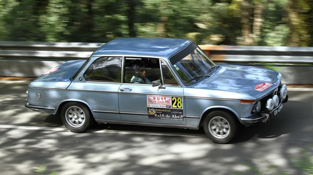

I've posted this same question on the 70-200mm f/4 L IS thread, but as I got no feedback, and really in need of some help, here it goes:
Going to car racing events with my 70-200mm f/4 non -IS - and beeing used to take some "good" panning shots with my old EOS450D + EF 55-250mm IS combo - really has become a disappointment.
I just can't get the same sharp shots I used to (panning shots, that is), despite the fact that I now use a 7D.
Higher shutter speed shots are awesome, but panning isn't that great.
Would you agree? I mean, is IS really important on panning shots!?
Here are a couple of examples:
The new combo (7D + 70-200 L non-IS)
Shot at 1/200
IMAGE: http://i238.photobucket.com/albums/ff56/minijag/IMG_7097.jpg
The old combo (EOS450D + EF 55-250mm IS)
Shot at 1/100 !!
IMAGE: http://farm3.static.flickr.com/2525/4037339906_a1ca1d6fc6_b.jpg
IMAGE LINK: http://www.flickr.com/​photos/minijag/4037339​906/  (external link)
Bobby Rahal – Lola T290 - 1972 (external link) por Nuno Castelhano (external link), no Flickr
I can always get back to my old 55-250 for panning, but it doesn't get any close to "L" quality does it?
Any comments/opinions would be much appreciated!
Thanks

BMW EXIF shows 70mm, while I predict the second image is at a longer focal length (no exif available on flickr or in image).
The red lola is also travelling directly left-to-right, so at a further distance away from you your downward angle is not as steep as in the BMW shot.
The BMW is also not travelling perfectly left-to-right and looks like the wheels are turned a little in preparation for a right hand turn.
The majority of unpleasant blur is on the front BMW grille and foglights, but the perspective on the Lola is more from behind and there's no detail on the rear end (in fact there really isn't any rear end to speak of) which would be subject to obvious blurring.
For all of that discussion, the reality is they're not exactly comparable shots. The BMW image is the more difficult to achieve because you'd need to be moving a little down while panning left-right.
IS is not strictly necessary for panning, but following the subject is essential and you've just missed it on the BMW. Good job getting so close though. I think that was a much harder shot, probably panning at a greater speed.

IS may make panning easier but it certainly isn't necessary. Panning technique has been around for a lot longer than IS so it just takes practice and perfecting a shooting style that works for you.
That being said... I see nothing wrong with your 55-250mm IS shot. No problem with the image quality of the image you posted.
Use what works for you to get the shot you want.

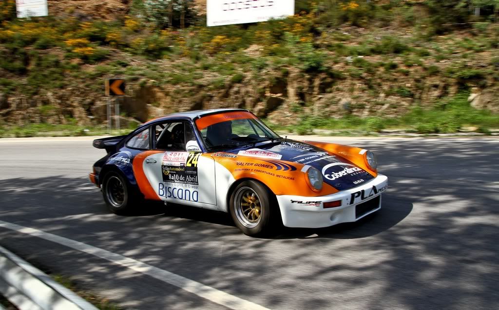

Maybe my main issue is the same that worries me when panning right close to cars, I mean, one or two meters away, inside the curves. And that is the fact that, as the car runs through, it passes right close to you and, a fraction of a second later, it is further away from / or closer to (it depends on where you stand) your viewpoint.
So this takes me to my second question (I promise I’ll practice a lot more on those first panning shots I mentioned, before selling my 70-200mm…:D).
How do you get better panning shots, when standing right close to cars? How do you solve the problem of having the car going through the corner and get it all focused?
Here’s an example of a poor shot (haven’t got any good one to post…yet :oops:) to illustrate my doubts.
IMAGE: http://i238.photobucket.com/albums/ff56/minijag/911.jpg
The more 'from the front' you are, the less panning you'll need to do, so less motion blur in background.
With a supercomputer you could possibly have control of the zoom ring, but that's not a reality.
At some point, there isn't enough blur to convey drama, speed and movement so you end up with a static shot.
I think this is why the panning shots are side-on to the car travelling at high speeds, while in-corner shots are low and wide, trying to illustrate the car with one wheel up over a kerb, or the race-leader with a group of 3 cars on his tail.
Close means pics with no blur but you can get tyre tread on your face and engine roar thumping your chest.
Far means pics with no in-your-face drama, in exchange for the serenity of the world passing by at 300km/h like an eagle dive bombing a rabbit on the prairie.
To sum it up, closer means faster shutter. Faster shutter means no blur and panning is less critical. (I'm particularly talking about when the car's direction of travel is substantially towards or away from you like close up in the corner situations you describe)

minijag wrote in post #12297892 (external link)
You don't (and the Porsche isn't a poor shot)
If you want to show any sort of blurred background, it's impossible.
It's the laws of physics at work and essentially you've worked out the answer but don't understand the problem.
The problem is that you have different parts of the car/bike moving (rotating) at different rates through different planes in relation to your film plane (in digital terms, your sensor) during the exposure.
A far better explanation (with diagrams) of it is here https://photography-on-the.net …=487139&highlig​ht=how+can
Your shot of the Zytec is taken with the car moving through the same plane as the sensor.
No part of the car changes distance from the sensor, hence no rotational blur.
