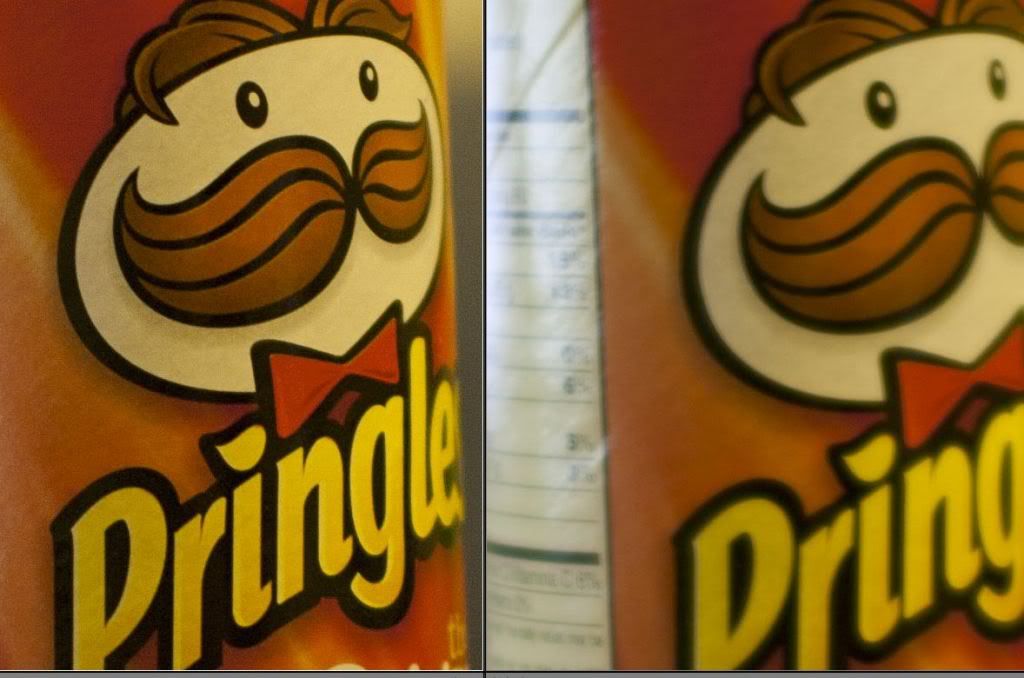

I honestly thought this lens was just soft at 1.4. spent hours setting MA on a 5d2. was never quite right. still my fav lens tho.
sold the 5d2 for a 5dc and was not happy with it at all. and like I said I didnt want to ship the lens and cam off, and I always rather do things my self.
here is a simple before and after after I did the calibration myself.
===============AFTER==​=============BEFORE===​=======
IMAGE: http://img.photobucket.com/albums/v727/xb8slim/omg.jpg
here is a 100% crop from a random test shot.
IMAGE: http://img.photobucket.com/albums/v727/xb8slim/IMG_0036.jpg

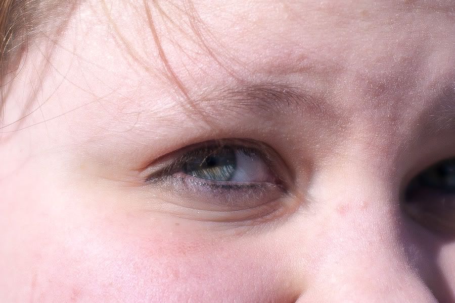

and from first session in a real situation
IMAGE: http://img.photobucket.com/albums/v727/xb8slim/amber%20and%20brent/PeoriaIlweddingPhotographersLuthyglenoakparkengagementphotos-0085.jpg
IMAGE: http://img.photobucket.com/albums/v727/xb8slim/amber%20and%20brent/PeoriaIlweddingPhotographersLuthyglenoakparkengagementphotos-0218.jpg
IMAGE: http://img.photobucket.com/albums/v727/xb8slim/amber%20and%20brent/PeoriaIlweddingPhotographersLuthyglenoakparkengagementphotos-0223.jpg
Peoria IL Wedding Photographer (external link) Chicago Wedding Photographers (external link)

How did you calibrate it yourself?

May 01, 2011 08:16 |  #23
you shim the mount on the lens. if it front focuses then you have to "add" shims, or take some out if it back focuses.

May 01, 2011 08:24 |  #25
I made my own shims, but you can buy them form sigma.

May 01, 2011 18:32 |  #27
kinda similar to this... http://sigmauserforum.​com/forum/showthread.p​hp?t=494 (external link)
take 4 screws out of silver mount
lift out mount SLOWLY as there is a ribbon connected at the location of the contacts and its short and fragile.
I cant find a link to the sigma parts catalog thingy... was a pack of like 3 diff shim thicknesses.
