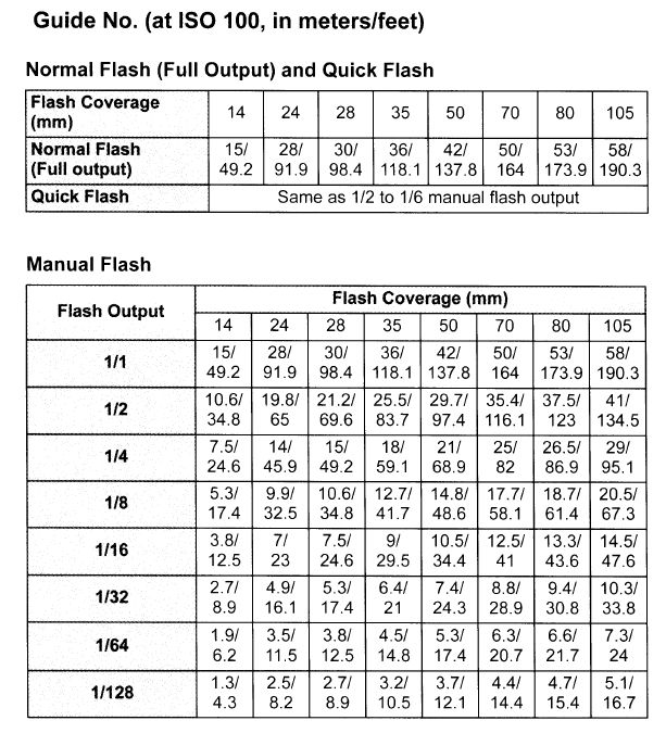

May 27, 2011 11:34 |  #9
There is a chart near the back of the manual that shows GN at various manual power settings.
IMAGE: http://i2.photobucket.com/albums/y17/msowsun/photo%20stuff/Photo6/_1-3.jpg
