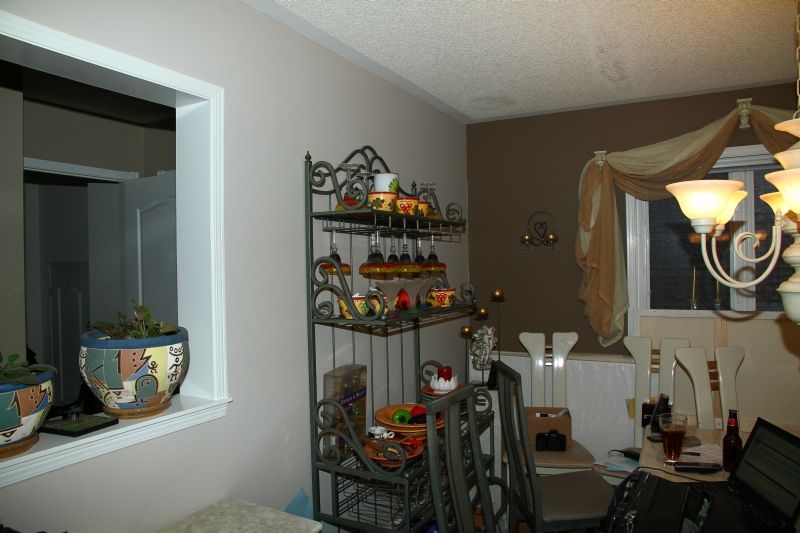

Here are some examples: All shot with a 7D and 15-85mm. ISO400 Manual mode 1/160 f/5.6 and direct flash 580EX II ETTL mode "0" FEC
Average metering NO diffuser
IMAGE: http://i2.photobucket.com/albums/y17/msowsun/photo%20stuff/Photo6/IMG_3158.jpg
Average metering WITH diffuser
IMAGE: http://i2.photobucket.com/albums/y17/msowsun/photo%20stuff/Photo6/IMG_3159.jpg
IMAGE: http://i2.photobucket.com/albums/y17/msowsun/photo%20stuff/Photo6/IMG_3160.jpg
IMAGE: http://i2.photobucket.com/albums/y17/msowsun/photo%20stuff/Photo6/IMG_3161.jpg
IMAGE: http://i2.photobucket.com/albums/y17/msowsun/photo%20stuff/Photo6/IMG_3164.jpg
IMAGE: http://i2.photobucket.com/albums/y17/msowsun/photo%20stuff/Photo6/IMG_3165.jpg
IMAGE: http://i2.photobucket.com/albums/y17/msowsun/photo%20stuff/Photo6/IMG_3166.jpg
IMAGE: http://i2.photobucket.com/albums/y17/msowsun/photo%20stuff/Photo6/IMG_3167.jpg
msowsun
"approx 8mm"
9,317 posts
Gallery: 18 photos
Likes: 416
Jun 02, 2011 20:58 |  #15
I must have bumped the wheel because the rest are at f/8
average without
IMAGE: http://i2.photobucket.com/albums/y17/msowsun/photo%20stuff/Photo6/IMG_3168.jpg
average with diffuser
IMAGE: http://i2.photobucket.com/albums/y17/msowsun/photo%20stuff/Photo6/IMG_3169.jpg
average without
IMAGE: http://i2.photobucket.com/albums/y17/msowsun/photo%20stuff/Photo6/IMG_3170.jpg
IMAGE: http://i2.photobucket.com/albums/y17/msowsun/photo%20stuff/Photo6/IMG_3171.jpg
average without
IMAGE: http://i2.photobucket.com/albums/y17/msowsun/photo%20stuff/Photo6/IMG_3172.jpg
IMAGE: http://i2.photobucket.com/albums/y17/msowsun/photo%20stuff/Photo6/IMG_3173.jpg
