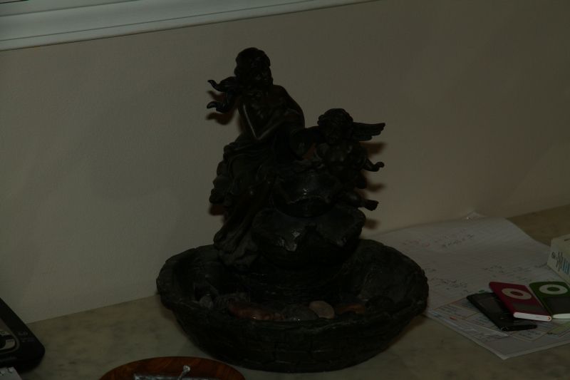

Jun 02, 2011 21:03 |  #17
Evaluative without
IMAGE: http://i2.photobucket.com/albums/y17/msowsun/photo%20stuff/Photo6/IMG_3175.jpg
Evaluative with diffuser
IMAGE: http://i2.photobucket.com/albums/y17/msowsun/photo%20stuff/Photo6/IMG_3176.jpg
Evaluative without
IMAGE: http://i2.photobucket.com/albums/y17/msowsun/photo%20stuff/Photo6/IMG_3178.jpg
IMAGE: http://i2.photobucket.com/albums/y17/msowsun/photo%20stuff/Photo6/IMG_3179.jpg
Evaluative without
IMAGE: http://i2.photobucket.com/albums/y17/msowsun/photo%20stuff/Photo6/IMG_3181.jpg
IMAGE: http://i2.photobucket.com/albums/y17/msowsun/photo%20stuff/Photo6/IMG_3182.jpg

Jun 02, 2011 21:05 |  #18
Evaluative without
IMAGE: http://i2.photobucket.com/albums/y17/msowsun/photo%20stuff/Photo6/IMG_3183.jpg
IMAGE: http://i2.photobucket.com/albums/y17/msowsun/photo%20stuff/Photo6/IMG_3184.jpg
Evaluative without
IMAGE: http://i2.photobucket.com/albums/y17/msowsun/photo%20stuff/Photo6/IMG_3185.jpg
IMAGE: http://i2.photobucket.com/albums/y17/msowsun/photo%20stuff/Photo6/IMG_3186-1.jpg

Jun 02, 2011 21:59 |  #19
Hmm. I re-read that forum thread and several people had confirmed the under exposure. I am going to have to try this myself.

Jun 02, 2011 22:06 |  #20
digital paradise wrote in post #12526155 (external link)
Using the Stofen type diffuser, I got underexposure with Evaluative ETTL, but got similar or slightly brighter results with Average ETTL metering.
