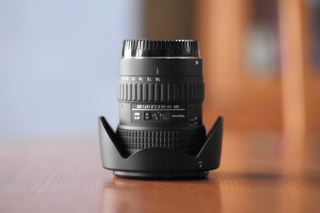

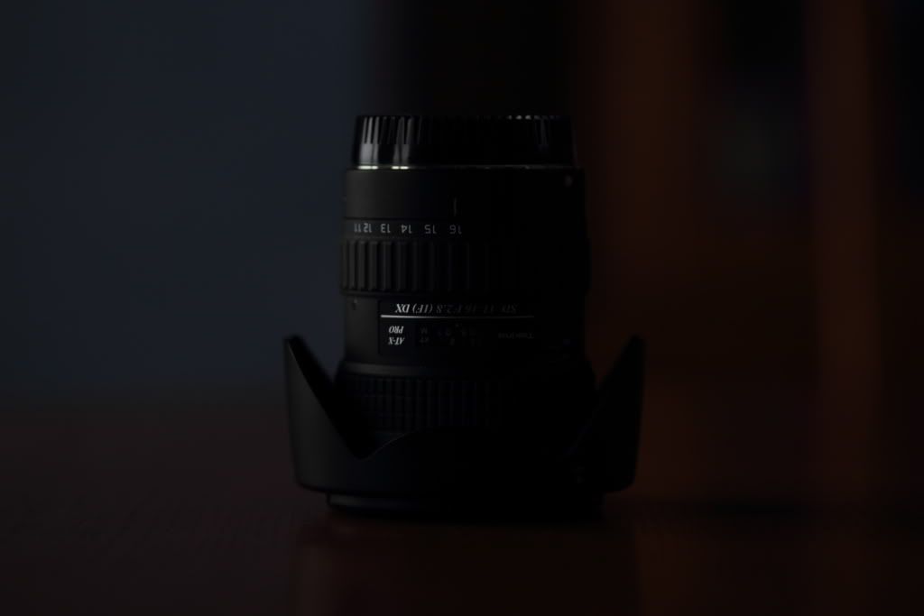

I have redone the test this time using Av mode with negative exposure dialled down to -5 stops, as it turned out, this is one stop less exposure than the previous example.
Also to get the exposure, the meter was set to evaluate the whole scene (basically the opposite of spot metre) to minimise the meter getting confused by dark colours.
Shadows were lifted in lightroom by increasing the fill light and exposure, and by increasing the curve slider for the 'darks' and 'shadows'.
This time however the lightroom dials limited me, and the picture was still slightly under exposed, so I exported the image as a 16 bit Tiff, saved the image, so that the dials went back to zero in lightroom, then I was able to increase the fill light some more to get the right exposure. I also moved the colour noise reduction slider all the way to 100, but the luminance slider remained at zero.
White balance was tricky to correct as I didn't use a grey card, so I used 'auto colour' in photoshop before saving the image for web.
Exposure settings were:
1/200
F2
ISO100
Below is what I started out with.
Below is the result after lifting the shadows.
Below is a 100% crop.

I think there is some inevitable variation in exposure, and subjectively I'd say you example was closer to my previous example of about -4 Stops, would you agree with that?
Crop looks pretty clean imo, although cross-hatching is more visible on the non-crop, although I'd say you increased the exposure about half a stop more than you needed to.
Below I arranged the images closer together for easier comparison?
(-4 Stops version)
(-5 Stops version)
