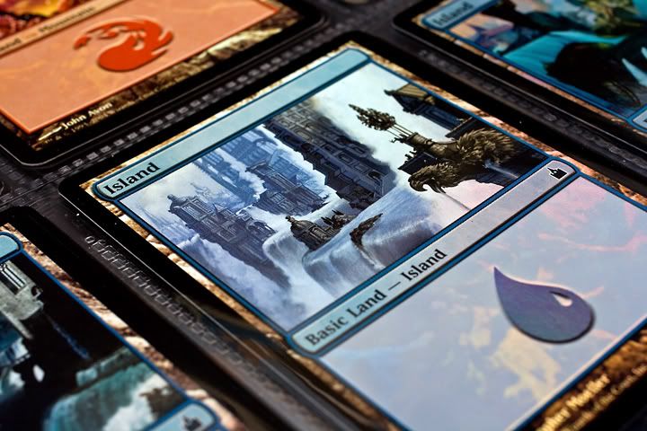

I'd think a scanner would be easier to, but if you want to use the camera it should be pretty simple to setup a shoot. You won't need much either.
1) Mount the camera on a tripod (really makes it a lot faster) and aim it downward. If you have focusing rails this will make focusing easier, but even without you should be able to setup most things without too much trouble. I'd the 60mm macro without question for this kind of work - an ideal tool
2) Off camera flash with a softbox over the flash itself ( a smallish one is all that is needed - lumiquest softbox size is more than enough)
3) f8 or so for sharpness; ISO 100 and 1/200sec and you're good to go
IMAGE: http://i170.photobucket.com/albums/u275/overmind_2000/theshiny.jpg
