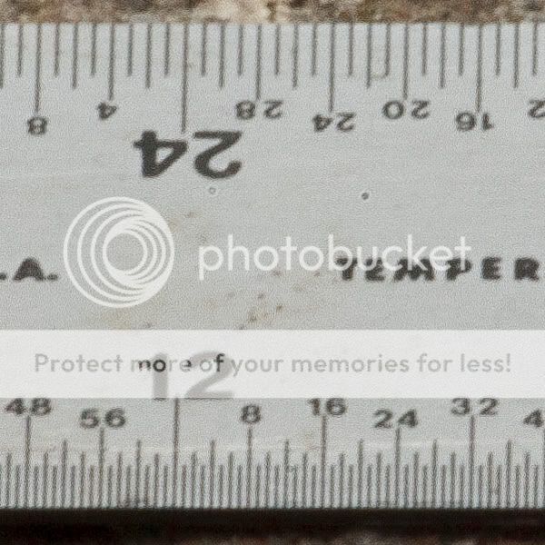

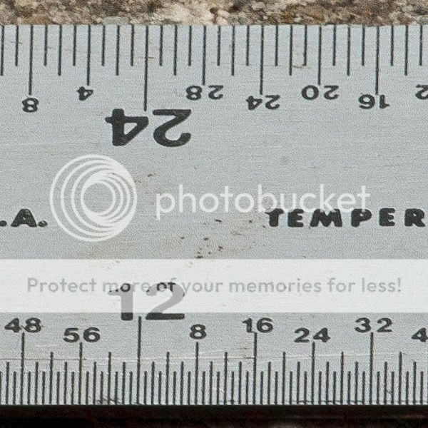

I might suggest that by using a MF camera, the images aren't closely comparable to what one would expect from a DSLR which has diffraction beginning to set-in at about f/10-12. Here are some that I took when I was testing a 180 macro on a DsMkIII.
starting with f/10
IMAGE: http://i329.photobucket.com/albums/l383/chauncey43/f10.jpg
then f/20
IMAGE: http://i329.photobucket.com/albums/l383/chauncey43/f20.jpg
followed by f/40
IMAGE: http://i329.photobucket.com/albums/l383/chauncey43/f40.jpg
and lastly f/51
IMAGE: http://i329.photobucket.com/albums/l383/chauncey43/f51.jpg
Stopping down to soften a waterfall would soften the entire image and not just the water. Softening water is best achieved using SS.
