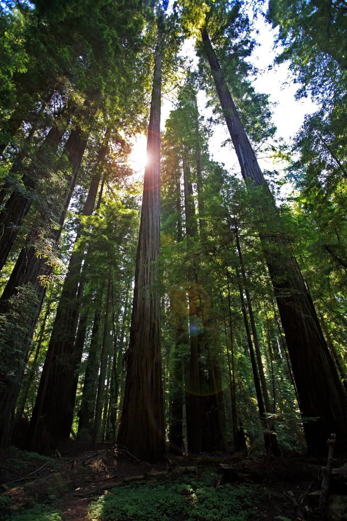

Jun 28, 2011 18:44 as a reply to  @ LarryD's post |  #38
this was taken with a 17mm on a 5d (which shows more distortion than a crop camera since it uses the lens edge-to-edge) from about the same distance away as you were....
The tops were pulled out to straighten the trees and look "normal", but still give them height.
IMAGE: http://i1044.photobucket.com/albums/b446/LarrysPhotos/Pacific%20Coast/RedwoodWhimsy.jpg
