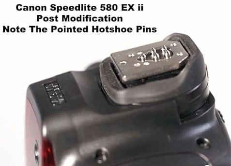

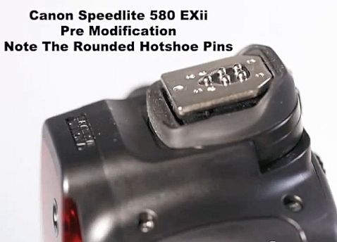

Canon knows about the contact issuses and has re-designed the contacts points from "rounded" to "pointy".
https://photography-on-the.net …p?p=12697656&po​stcount=23
IMAGE: http://i2.photobucket.com/albums/y17/msowsun/photo%20stuff/Photo6/_1c-7.jpg
IMAGE: http://i2.photobucket.com/albums/y17/msowsun/photo%20stuff/Photo6/_1cc-1.jpg

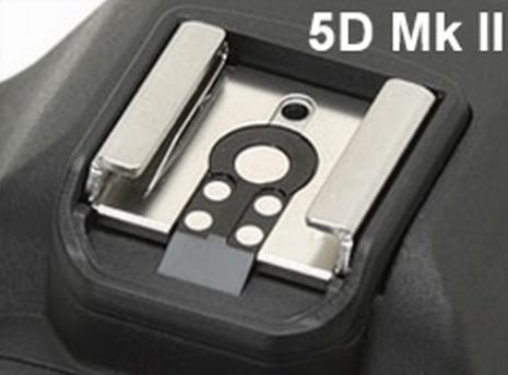

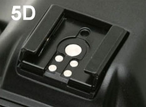

The camera hot shoe mount was re-designed on newer Canon cameras to fit the 580EX II's weather sealing. I wonder if part of the problem is the rubber boot that forms the seal. Maybe it doesn't fit the older cameras well.
IMAGE: http://i2.photobucket.com/albums/y17/msowsun/photo%20stuff/Photo6/_1a-19.jpg
IMAGE: http://i2.photobucket.com/albums/y17/msowsun/photo%20stuff/Photo6/_1aa-7.jpg
kenwood33
2,616 posts
Likes: 26
Jul 31, 2011 18:48 |  #10
I don't think the rubber boot is an issue because this problem occurs on my 7d (as well as on the 40d and xsi).
