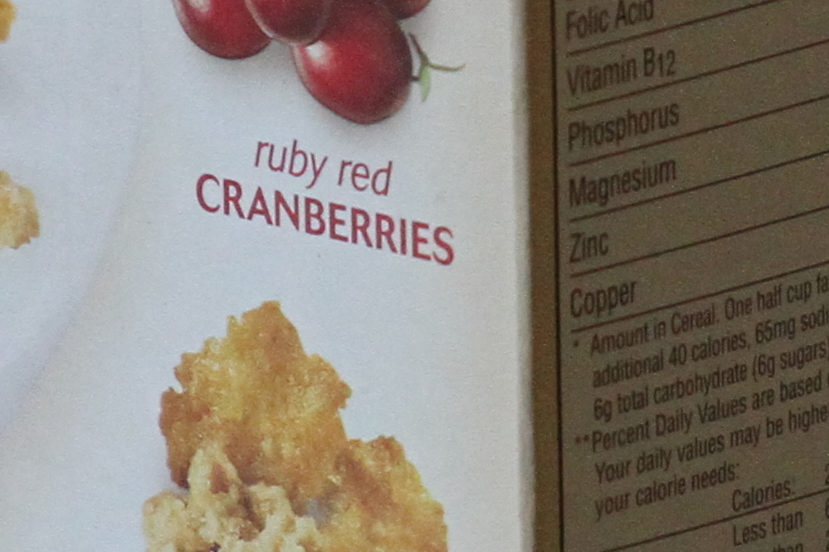

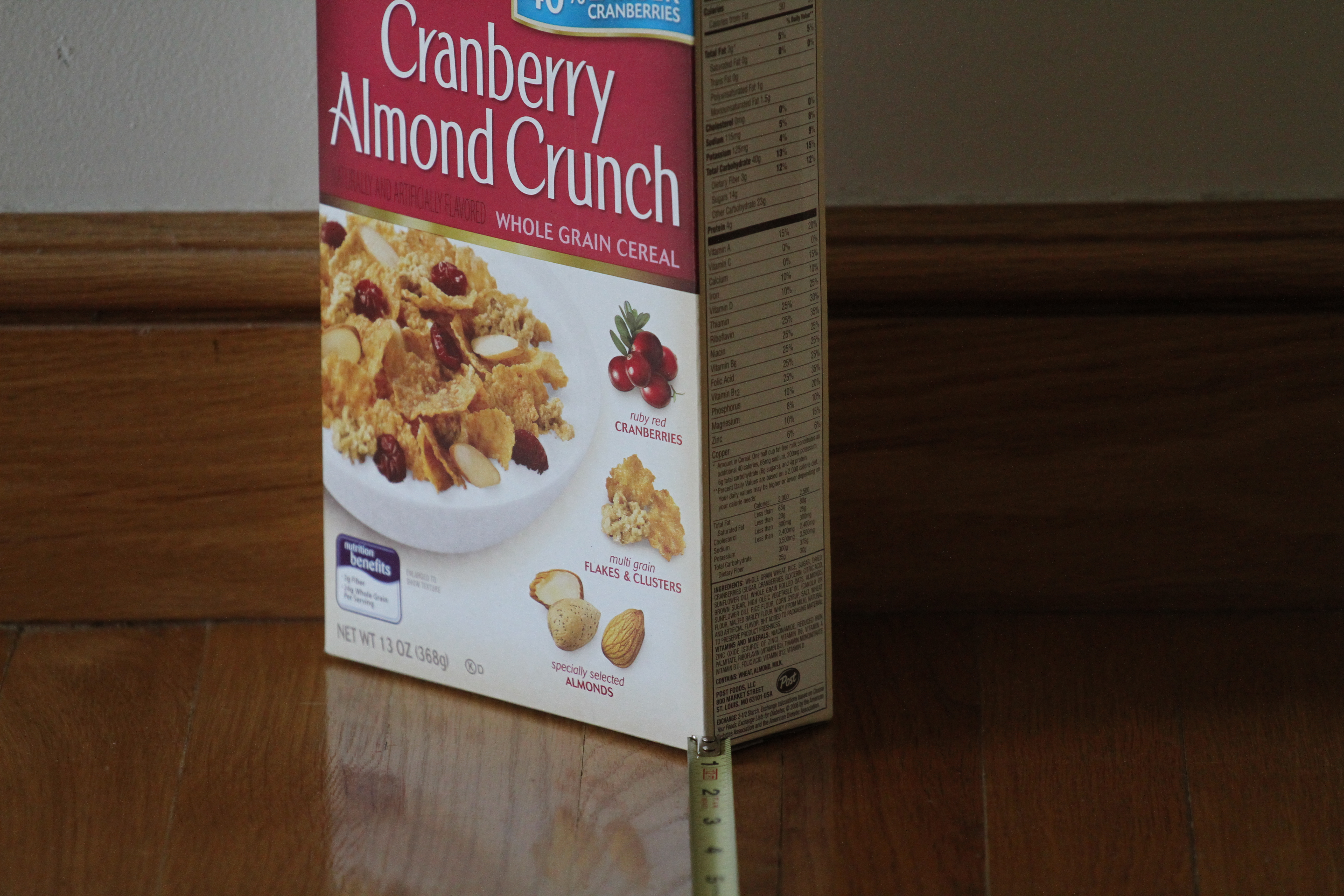

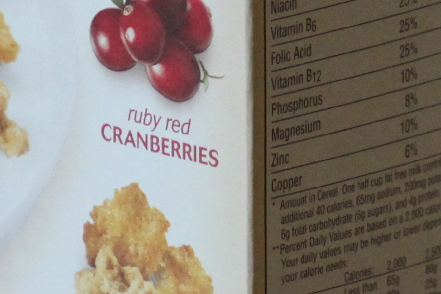

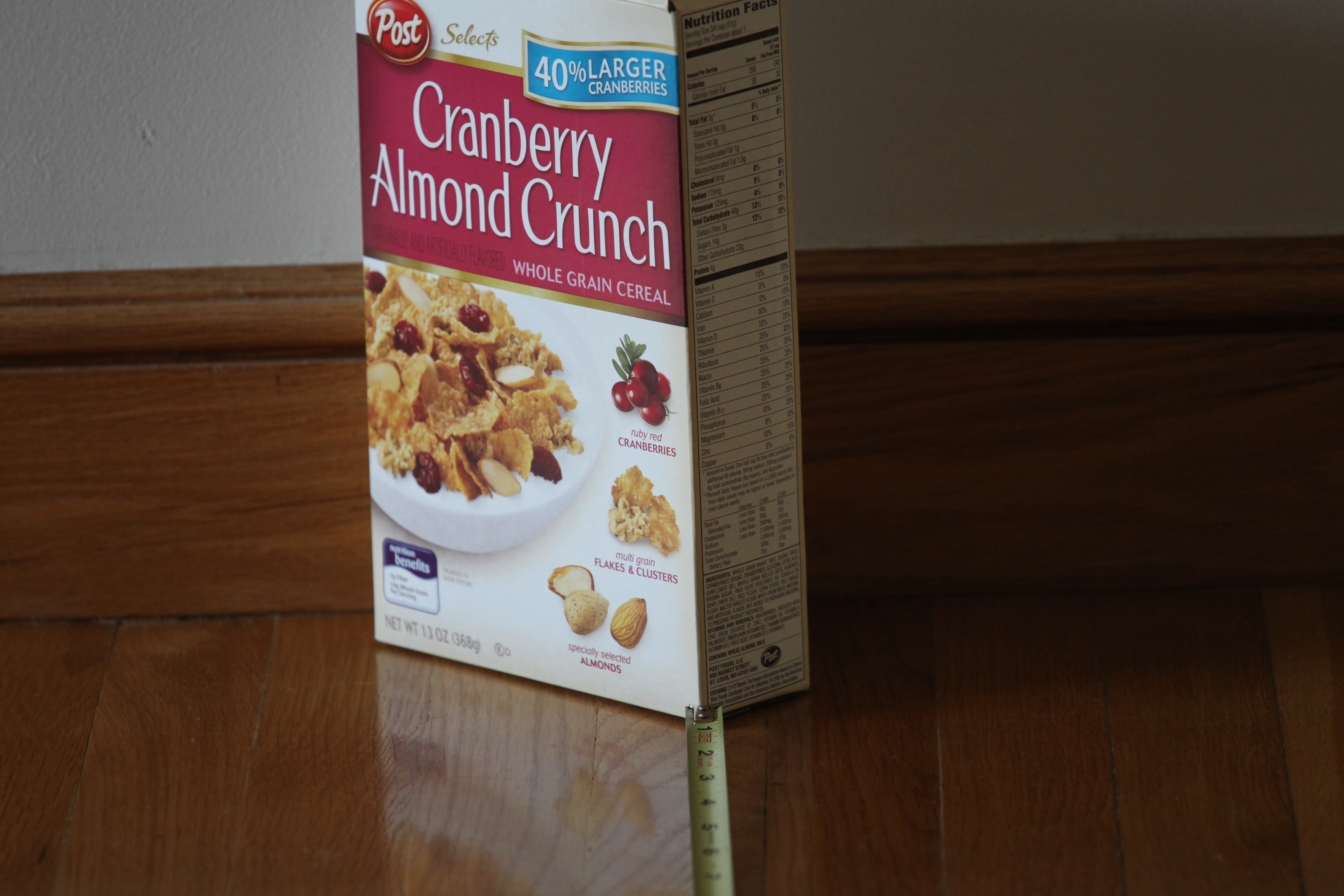

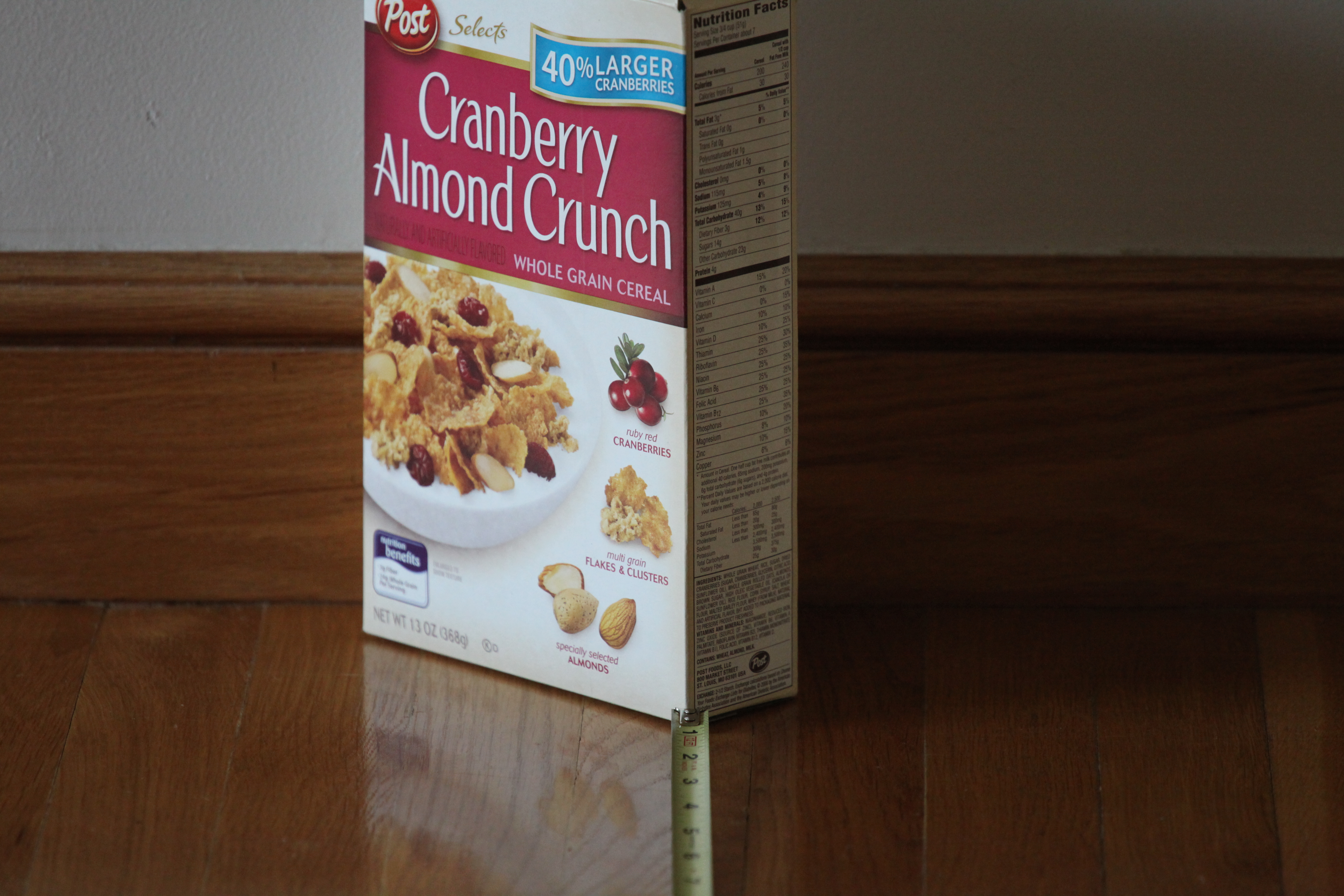

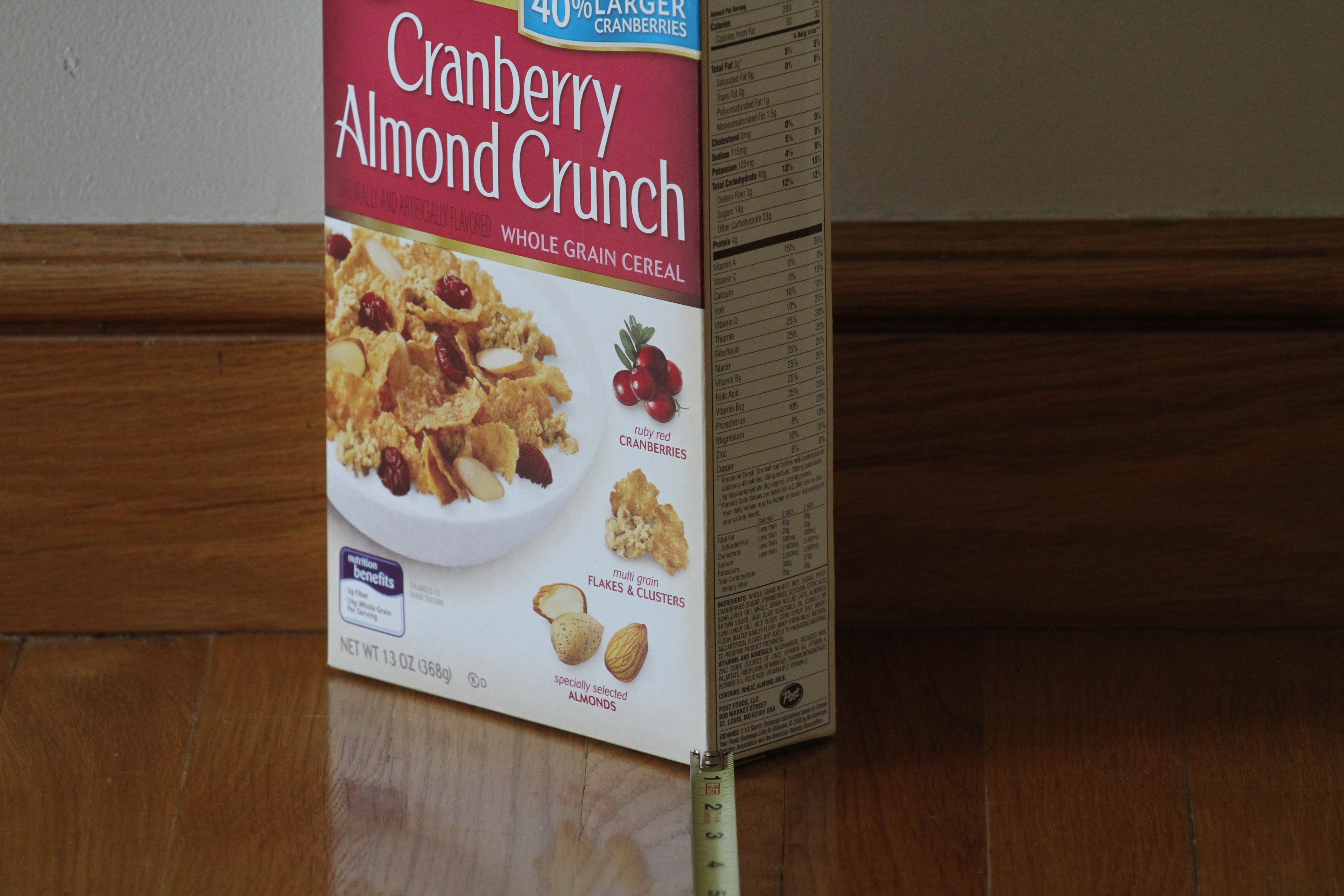

This is inspired by the thread about ISO performance, where the question came up what exactly the extender is doing to all this:
https://photography-on-the.net …/showthread.php​?t=1077251
Assuming you have a 70-200mm lens and you need more reach, is it better to...
  • ... use a camera with a higher density sensor in the crop area, in this case the 7d? This leads to more noise at same ISO.
  • ... use an extender, in this case on a 5d2? This leads to losing an f-stop in aperture, and assorted other to-be-assessed degradations.
This test is assuming you want low shutter speed for a distant object, so the "base" ISO speed for this test is 1600. Since the 5d2 performs better noise-wise I also do this test with iso 3200 on the 5d2.
So this is really two tests:
  • 1) using an aperture both can offer (f/5.6 or smaller), both at same ISO and shutter speed. This mostly tests the optical qualities of the extender.
  • 2) in the 5d2 trade in the better noise performance for the lost f-stop (using f/4 and iso 1600 on the 7D and f/5.6 and iso 3200 on the 5d2)
Keep in mind that although the field of view in the 7D is 1.6x narrower the actual reach (pixels on small subject) is only 1.48 times higher (due to different base resolution). So the 1.4x extender fits quite nicely, with the 5d2 falling just a bit short of the 7D's reach.
Lenses are 70-200 f/4 non-IS and a 1.4x Mk II extender. Against, all pictures taken 3 times and the sharpest picked.

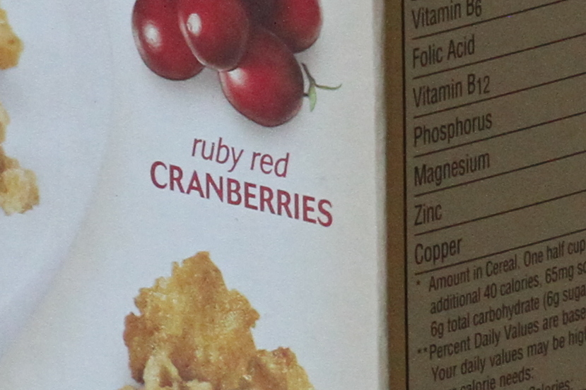

Test1 - all parameters the same (plain lens stopped one down):
7D no extender f/5.6 iso 1600:
http://darmok.dyndns.o​rg ….0mm-250-f5.6-1600iso.jpg (external link)
IMAGE: http://darmok.dyndns.org/cameratests201108/extendertests/test1-allsame/.medpics/img_0387_200.0mm-250-f5.6-1600iso_med.jpg
5d2 with extender f/5.6 iso 1600:
http://darmok.dyndns.o​rg ….0mm-160-f5.6-1600iso.jpg (external link)
IMAGE: http://darmok.dyndns.org/cameratests201108/extendertests/test1-allsame/.medpics/img_0398_280.0mm-160-f5.6-1600iso_med.jpg
IMAGE: http://darmok.dyndns.org/cameratests201108/extendertests/test1-allsame/img_0387_200.0mm-250-f5.6-1600iso_middlecut829x552.jpg
IMAGE: http://darmok.dyndns.org/cameratests201108/extendertests/test1-allsame/img_0398_280.0mm-160-f5.6-1600iso_middlecut898x599.jpg
Test - 7D has the aperture advantage, 5d2 one iso speed higher:
7D no extender f/4, iso 1600
http://darmok.dyndns.o​rg ….0mm-500-f4.0-1600iso.jpg (external link)
IMAGE: http://darmok.dyndns.org/cameratests201108/extendertests/test2-trade-aperture-for-iso/.medpics/img_0385_200.0mm-500-f4.0-1600iso_med.jpg
5d2 with extender f/5.6, iso 3200:
http://darmok.dyndns.o​rg ….0mm-250-f5.6-3200iso.jpg (external link)
IMAGE: http://darmok.dyndns.org/cameratests201108/extendertests/test2-trade-aperture-for-iso/.medpics/img_0399_280.0mm-250-f5.6-3200iso_med.jpg
7D no extender:
IMAGE: http://darmok.dyndns.org/cameratests201108/extendertests/test2-trade-aperture-for-iso/img_0385_200.0mm-500-f4.0-1600iso_middlecut829x552.jpg
5d2 with extender:
IMAGE: http://darmok.dyndns.org/cameratests201108/extendertests/test2-trade-aperture-for-iso/img_0399_280.0mm-250-f5.6-3200iso_middlecut898x599.jpg

Well here is another piece in the puzzle. I think the 5d2 comes out on top in that test. Clearly the extender does less damage to the picture (including from the lost f-stop) than the high-density sensor - but not by much.
But the 7d package without the extender is quite a bit cheaper than the 5d2 package with the extender.

Uhm..i disagree..to my eyes the 7D image is a bit sharper in the 100% Not sure you'd see it in RL usage, but the fact you gain a stop in aperture is worth it...
There is another comparison done here by Juza using a 300mm f/2.8 + 1.4x and 2.0x TCs versus the 1Ds Mark III
http://www.juzaphoto.c​om …icles/canon_7d_​review.htm (external link)
He came up with roughly the same conclusion, its a HAIR better, But that hair is also letting you use an aperture 1 stop wider which sometimes is a bigger difference, IE because you can use ISO800 vs 1600 and etc
