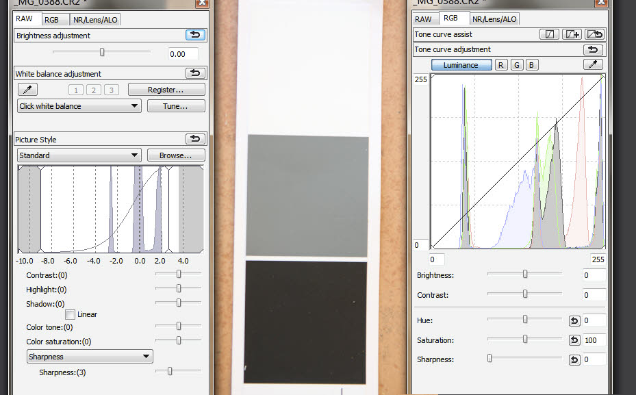

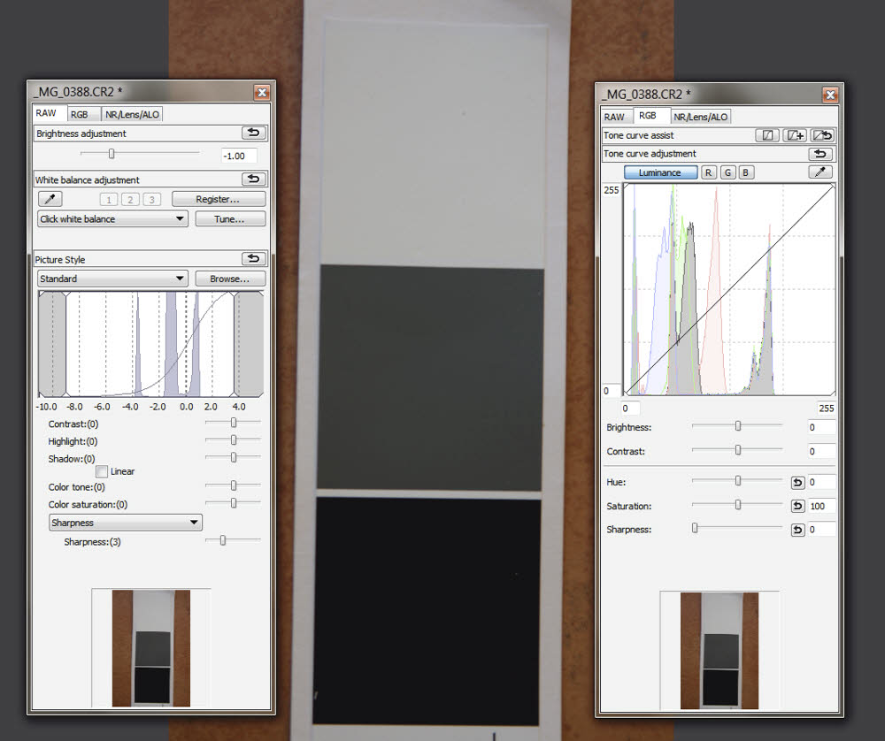

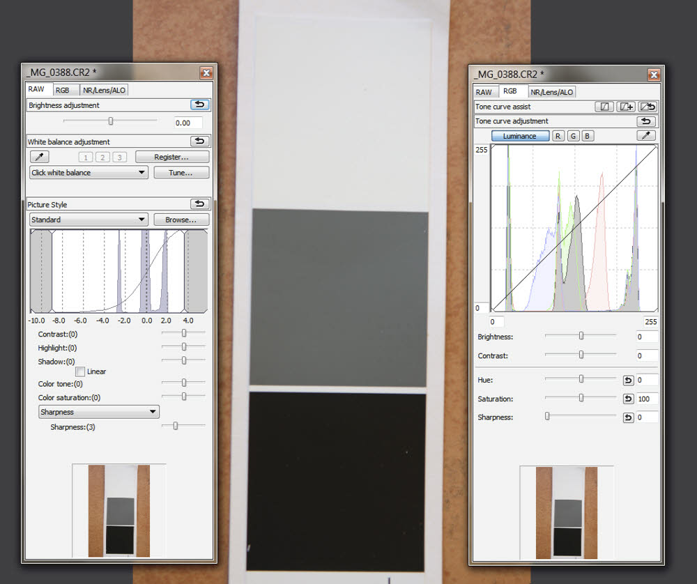

Aug 13, 2011 14:39 |  #10
Below are three screen captures of DPP. In the first RAW Brightness (Exposure) is at default 0, in the second it is raised +1 EV and in the third it is -1 EV. To the left is the RAW tab and to the right the RGB tab with its predictive histogram. As can clearly be seen the adjustment is linear and both the white point and the black point are shifted to the right or the left.
IMAGE: http://photos.imageevent.com/elied/gear/1.jpg
IMAGE: http://photos.imageevent.com/elied/gear/2.jpg
IMAGE: http://photos.imageevent.com/elied/gear/3.jpg

tzalman wrote in post #12929340 (external link)
The transformations you applied are far from linear tzalman, this is the curve that models the +1EV:
HTTP response: NOT FOUND | MIME changed to 'image/jpeg'
And this is the -1EV:
They are typical non-linear brightness curves. In the low range (shadows) they behave close to a linear expoure correction, but the more we go into the highlights the transformation is not linear anymore.
I cannot calculate the curve for the margin dragging method since you didn't post the corresponding original image.
