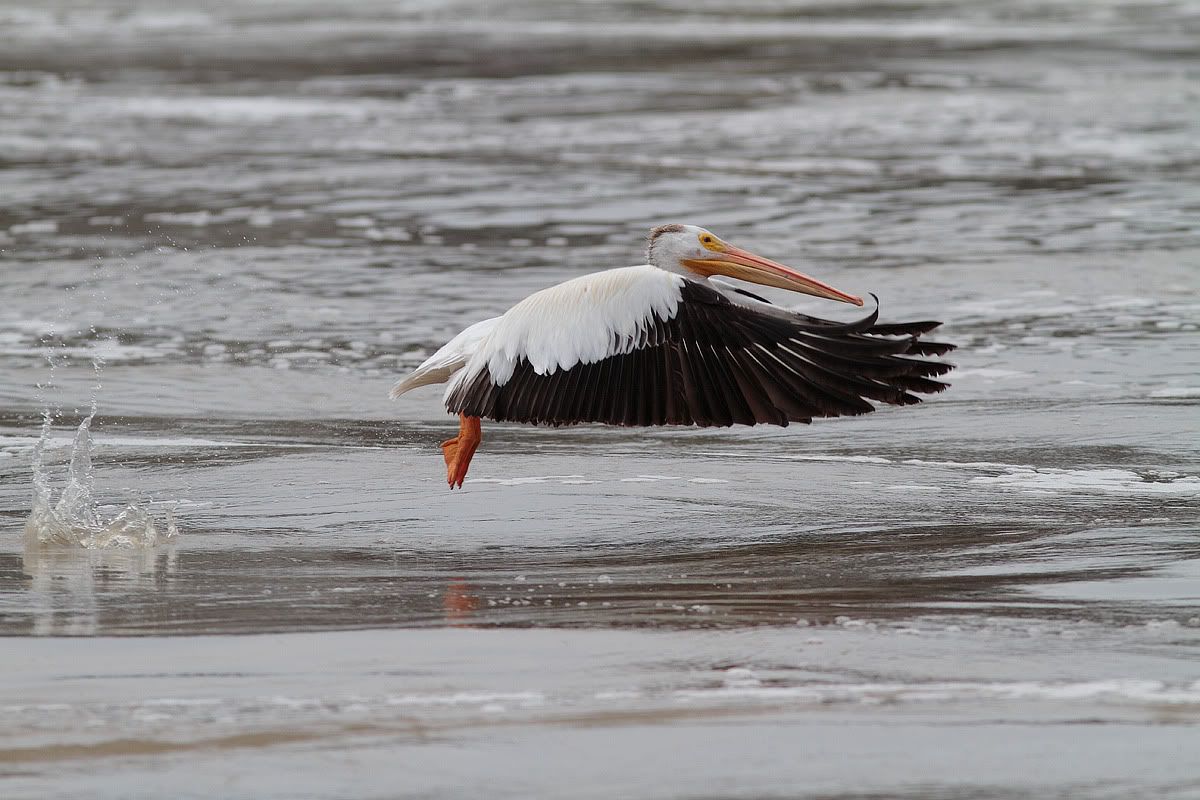

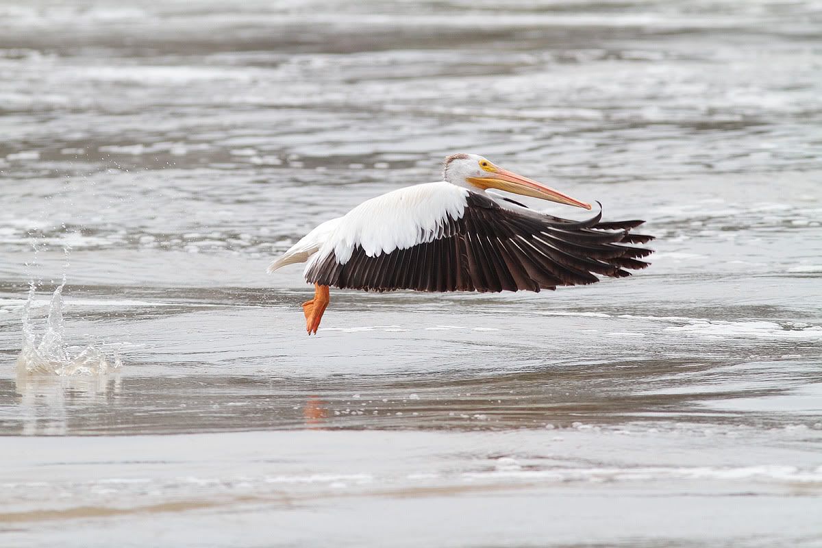

Aug 15, 2011 10:24 |  #35
The only checkbox I could find was the curve and strait in the preferences. I checked the strait box.
http://i33.photobucket​.com/albums/d74/Zenon1​/0-EV.jpg (external link)
+1
http://i33.photobucket​.com/albums/d74/Zenon1​/1-EV.jpg (external link)
-1
http://i33.photobucket​.com/albums/d74/Zenon1​/_1-EV.jpg (external link)

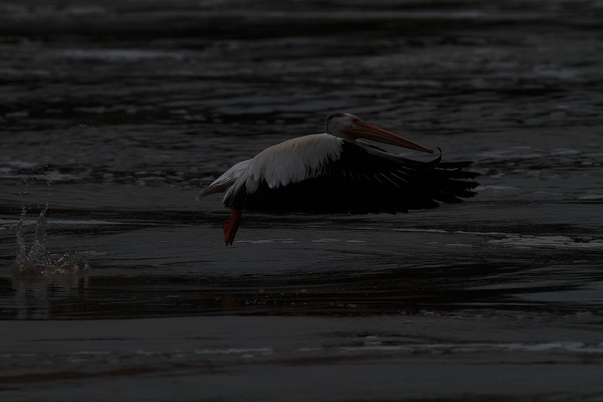

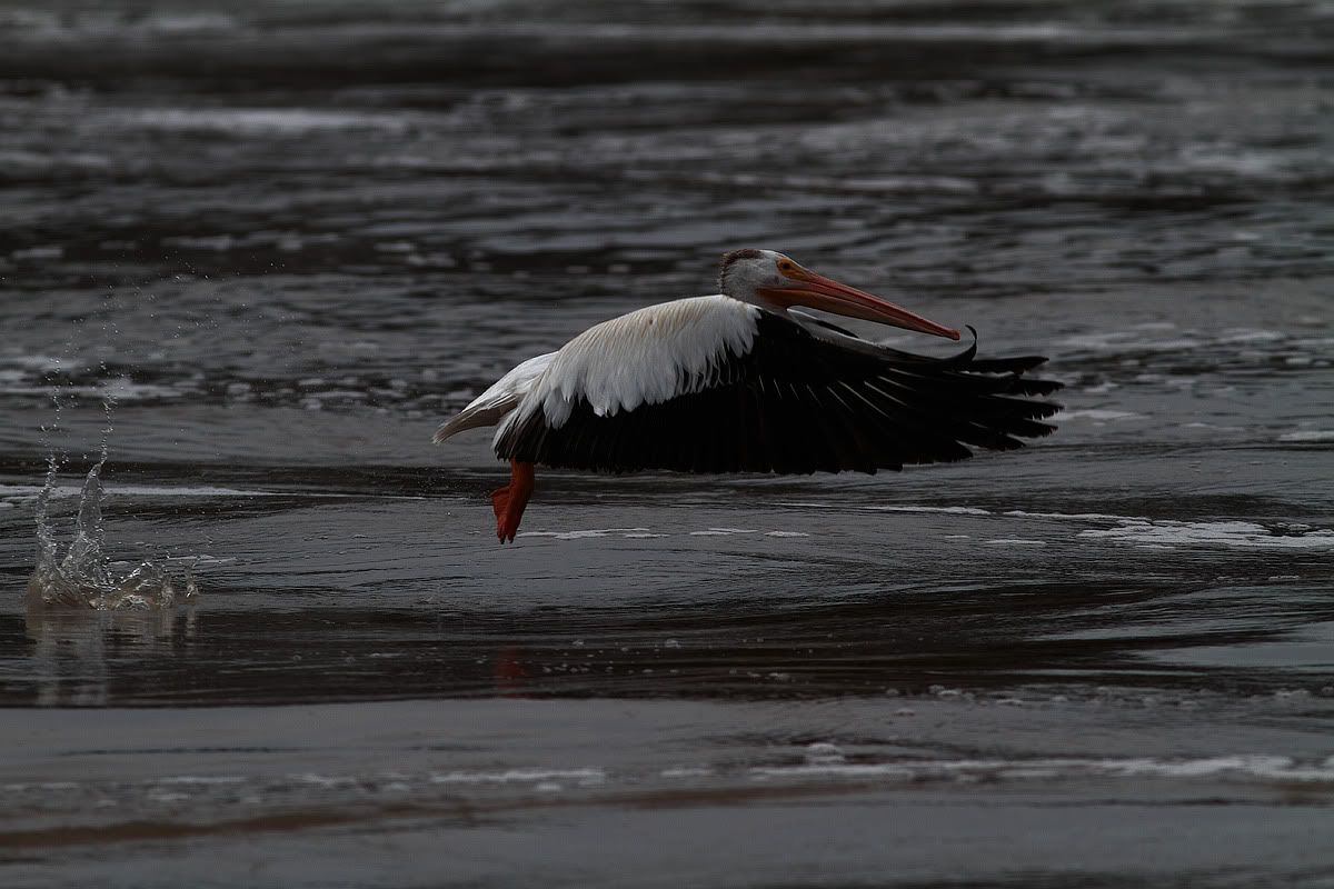

Aug 15, 2011 10:52 |  #38
Well I'm not sure these will be of any use to you. This is what happened when activated linear. I am going to have to the Canon DPP tutorials for the explanation.
http://i33.photobucket​.com …s/d74/Zenon1/0d​e5bf5e.jpg (external link)
+1
http://i33.photobucket​.com/albums/d74/Zenon1​/1-7.jpg (external link)
-1
http://i33.photobucket​.com/albums/d74/Zenon1​/_1.jpg (external link)

Aug 15, 2011 10:59 |  #39
That was interesting. It is sort of a graduated ND filter/HDR feature.
