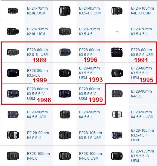

http://en.wikipedia.or​g/wiki/Canon_EF_28-80mm_lens (external link)
Now this was a strange lens take a peek

Copperny wrote in post #13086426 (external link)
Here is another look at the 8 different versions of the EF 28-80mm: http://www.canon.com …ens/ef/standard​_zoom.html (external link)
IMAGE: http://i2.photobucket.com/albums/y17/msowsun/photo%20stuff/Photo7/_1a-2.jpg
