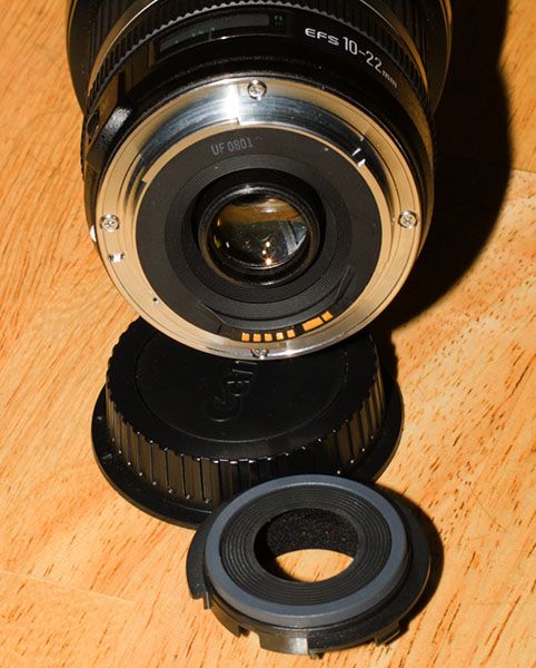

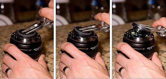

How about ZERO $ ? Pop the rear baffle out of your EF-S 10-22 and you are good to go...
https://photography-on-the.net …php?p=7985482#p​ost7985482
It will hit the mirror at 10-11mm, vignette badly at 12-14mm, works great from 15-22mm.

It's a thought, but would still like to use the 10-22 with my 7D. Would I still be able to?

kenjancef wrote in post #13087265 (external link)
Yes, it will still mount to the 7D, but you will have a larger rear opening. If you want you can substitute a baffle from an EF lens.
IMAGE: http://i2.photobucket.com/albums/y17/msowsun/photo%20stuff/Photo7/_1aa-1.jpg
IMAGE: http://i2.photobucket.com/albums/y17/msowsun/photo%20stuff/Photo7/_1-6.jpg
IMAGE: http://i2.photobucket.com/albums/y17/msowsun/photo%20stuff/Photo7/_1a-3.jpg

Yea, I followed your links and also found a few more. Kinda scared to do that actually. Was looking at the Sigma 12-24, maybe sell the 10-22 and go for that.
