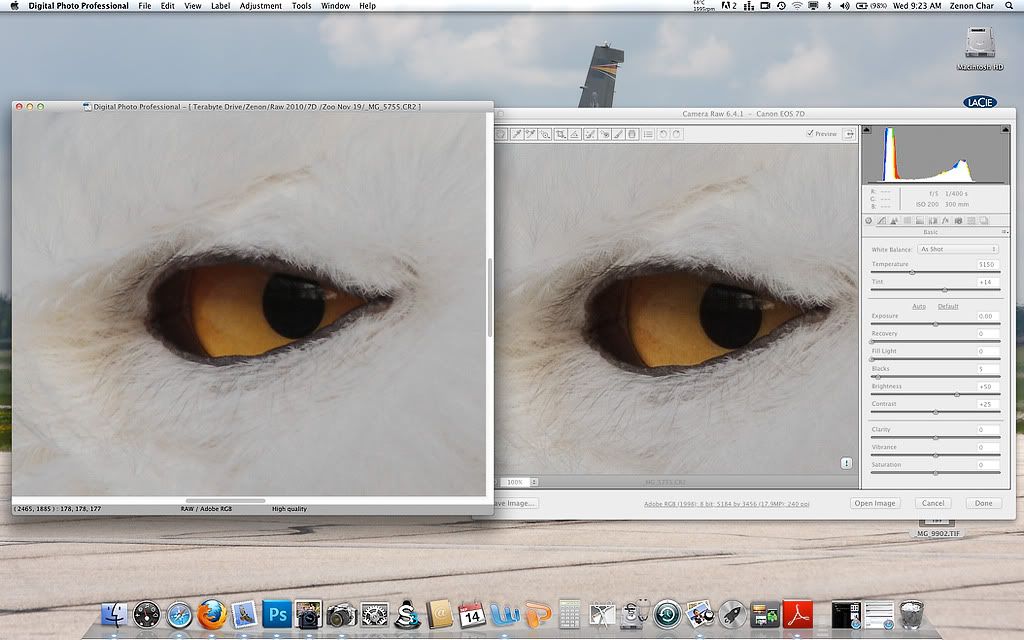

I tried another image. DPP Sharpening at 3 and at 25,1.0, 25 which comes up automatically. In this image ACR brought out more detail.
IMAGE: http://i33.photobucket.com/albums/d74/Zenon1/Screen-Shot-2011-09-14-at-923.jpg

I'm fine with 3. I consider that the capture sharpening phase. I find PS will do a great job when it comes to sharpening. I recently found a new technique that works well. I prefer 3 because if something is over sharpened you can't pull it back after converting to a TIFF So I have to start over. In Photoshop I can.
