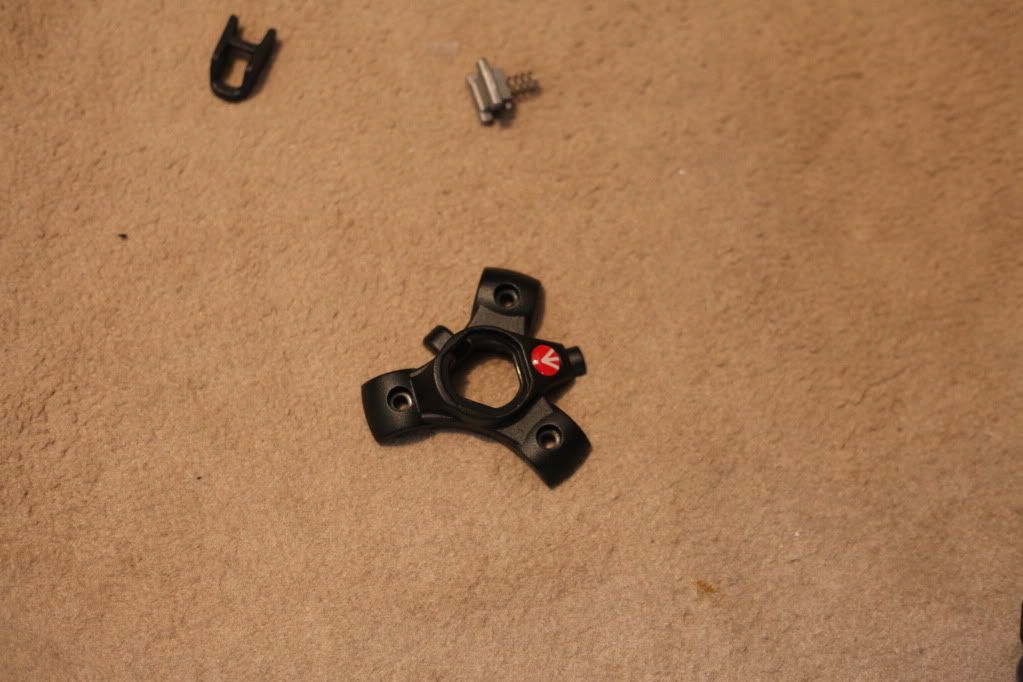

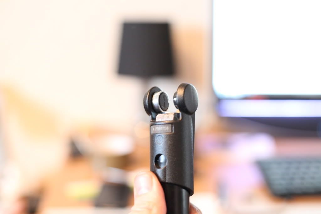

IMAGE: http://img.photobucket.com/albums/v17/opelderek/IMG_2804.jpg
IMAGE: http://img.photobucket.com/albums/v17/opelderek/IMG_2803.jpg
IMAGE: http://img.photobucket.com/albums/v17/opelderek/IMG_2802.jpg
IMAGE: http://img.photobucket.com/albums/v17/opelderek/IMG_2801.jpg
Tightening these screws should tighten or loosen the legs.

rick_reno
44,648 posts
Likes: 155
Sep 22, 2011 11:37 |  #7
Did you give that tripod any anesthesia before doing that chop job?

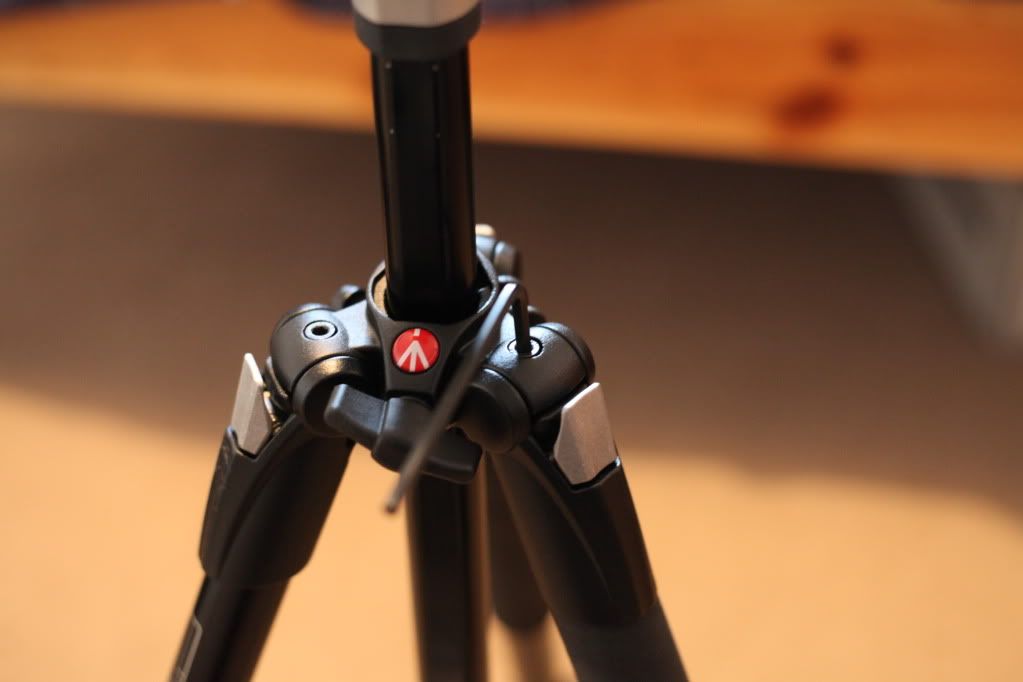

IMAGE: http://img.photobucket.com/albums/v17/opelderek/IMG_2806.jpg
Well after taking my tripod apart and back together i can confirm the tighter you tighten those allen screws the stiffer the legs will become, its squashing the silver ring round the legs and slowing the movement down.
dexy101
2,388 posts
Gallery: 93 photos
Likes: 990
Location: Scotland
Sep 22, 2011 11:43 as a reply to  @ dexy101's post |  #9
Vixen89 wrote in post #13145428 (external link)
that's some serious surgery going on, i like.
rick_reno wrote in post #13145463 (external link)
I like helping people if i can, plus it meant taking something apart and seeing exactly how it works and getting it back together. Works fine again im happy to report and will make a full recovery :D
