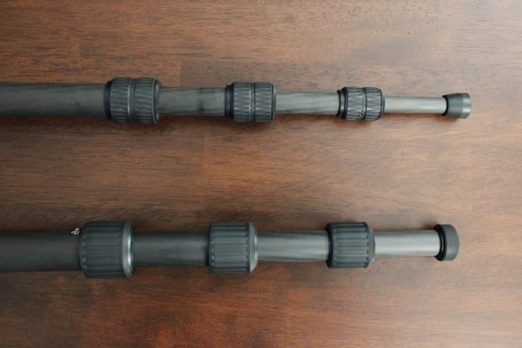

The Benro legs are noticeably thicker diameters at every section. Having owned the Gitzo for longer, the thicker sections on the Benro come off as rather bulky. Both legs are equipped with anti-rotating legs and both work as advertised and well.
IMAGE: http://i144.photobucket.com/albums/r192/ahero4eternity/Benro%20vs%20Gitzo/49068ea6.jpg

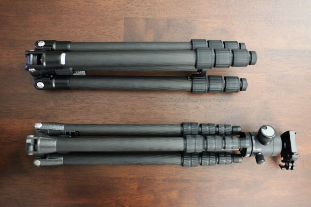

Folded length
The c2680t and gt1542t are neck and neck when folded without ballheads. However, the c2680t v2 attempts to mimic the design of Gitzo’s previous gt1541t and has a shorter center column that allows the ballhead to be recessed and protected between the legs when folded. Gitzo’s newer gt1542t has a longer center column that causes any attached ballheads to be completely exposed when attached.
c2680t v2 vs gt1542t folded w/out ballhead (same length, the Benro looks longer because of the angle of the shot)
IMAGE: http://i144.photobucket.com/albums/r192/ahero4eternity/Benro%20vs%20Gitzo/abcb3680.jpg
Same picture as above, but this time with the Q3T mounted on the Benro. You can see that it does not add any significant length to the folded length.
IMAGE: http://i144.photobucket.com/albums/r192/ahero4eternity/Benro%20vs%20Gitzo/167cd769.jpg
Same picture as above, but reversed (Q3T is now mounted on the Gitzo). You can see that it significantly adds to the folded length (note that I forgot to fold the clamp down in the picture, and by doing so you can reduce a little over an inch – however, it is still considerably longer than the Benro w/ Q3T attached).
IMAGE: http://i144.photobucket.com/albums/r192/ahero4eternity/Benro%20vs%20Gitzo/0dbc75e0.jpg
The advantage of the gt1542t is that it does not limit the size of the ballhead you use. Because the panning base of the ballhead is not confined to the limits of the legs because it sits beyond them, you can virtually use any size ballhead you want. That said, realistically, this probably isn’t much of an advantage. Most people likely do not want to use larger ballheads on these legs, anyway, so as to keep portability at a maximum.

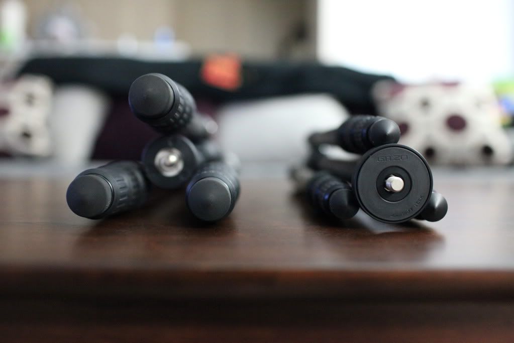

Benro
IMAGE: http://i144.photobucket.com/albums/r192/ahero4eternity/Benro%20vs%20Gitzo/6422576b.jpg
Gitzo
IMAGE: http://i144.photobucket.com/albums/r192/ahero4eternity/Benro%20vs%20Gitzo/7787e80b.jpg
You can see that the Benro is quite a bit bulkier.
