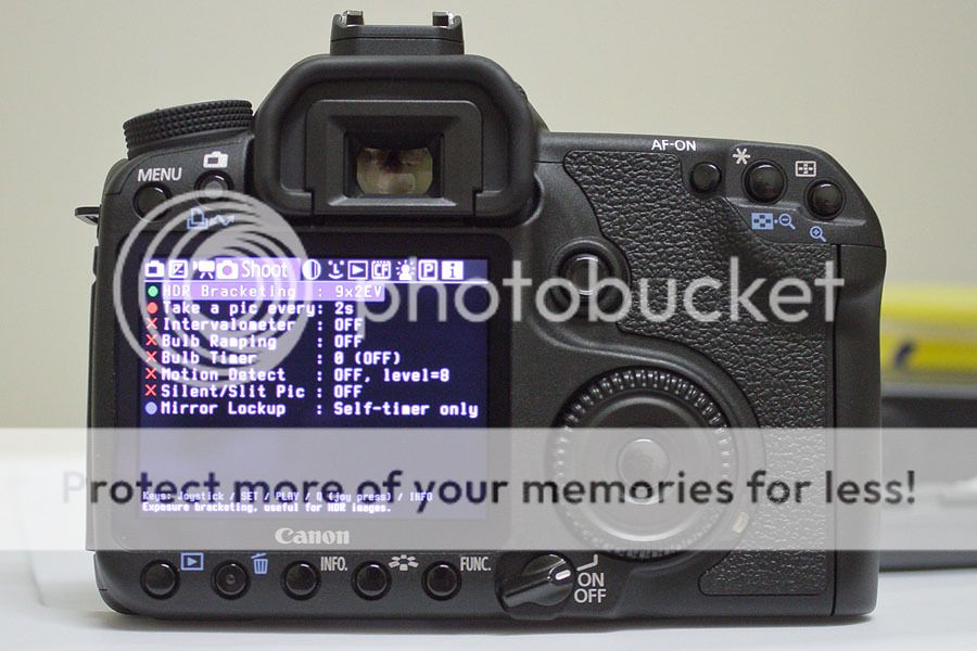

If you're comfortable hacking your camera, Magic Lantern lets you rip off up to 9 exposures at your selected EV interval in just a few seconds with one press of the shutter.

Hmm.... I've been known to tweak a few things in the past. Might have to look at all of this.
Thanks.
