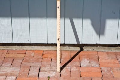

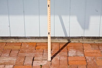

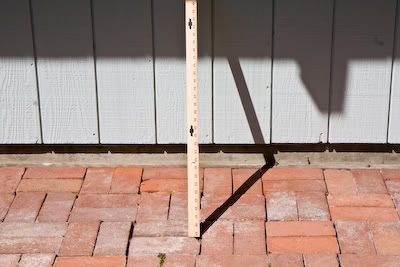

The Stoffen reduces effectiveness of fill flash outdoors, in diminshing the contrast of shadows cast by the sun! This old (2008) test series should prove it to you.
First, sun only

Next, straight fill flash (no modifier)
IMAGE: http://i69.photobucket.com/albums/i63/wiltonw/IMG_1052-3.jpg
Last, a Stoffen-sized 'diffuser'
IMAGE: http://i69.photobucket.com/albums/i63/wiltonw/IMG_1051-2.jpg
It is not larger than native flash lens as seen by subject (so no 'softer' in the shadows it might create); it sends light out in all directions (wasting light); and diminishes its intensity compared to bare flash (reduced its ability to reduce sun shadow contrast)
