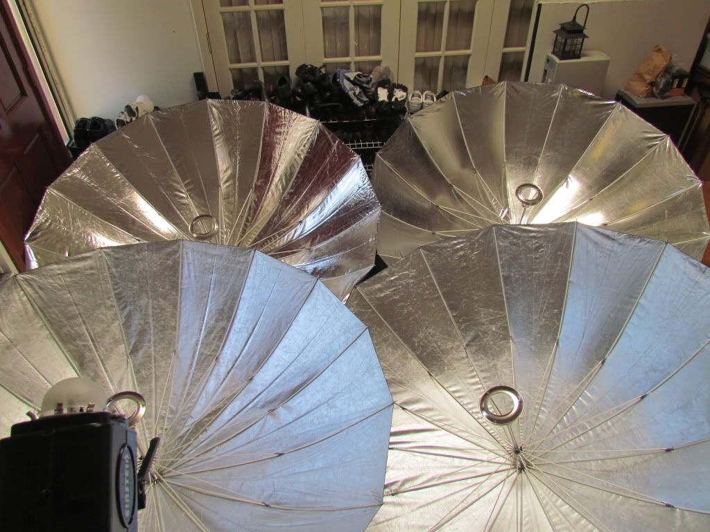

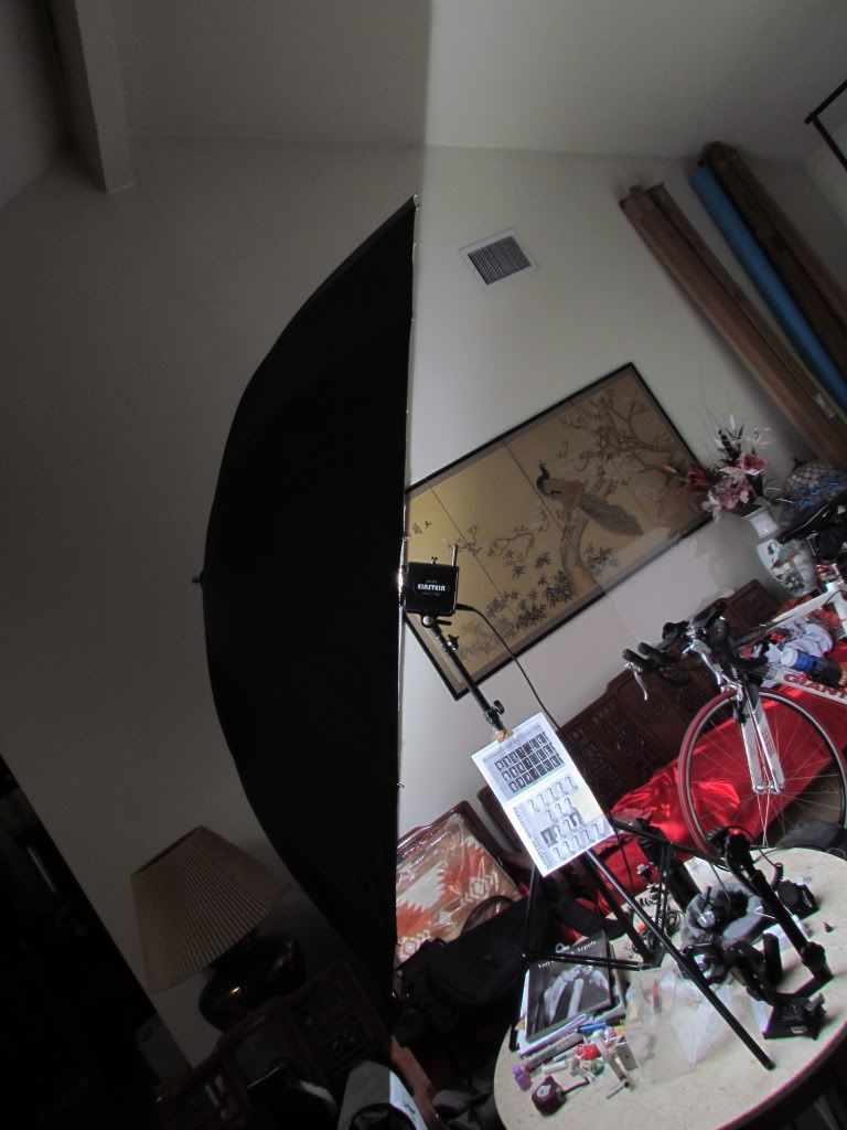

Nov 26, 2011 10:23 |  #13
i own all 3 versions of the plms...
IMAGE: http://i62.photobucket.com/albums/h120/c2thew/PLM%20v2/IMG_0871-3.jpg
IMAGE: http://i62.photobucket.com/albums/h120/c2thew/PLM%20v2/Plm%20soft%20extreme%20and%20v1%2086%20silver%20comparison/IMG_0978-1.jpg
IMAGE: http://i62.photobucket.com/albums/h120/c2thew/PLM%20v2/Plm%20soft%20extreme%20and%20v1%2086%20silver%20comparison/IMG_0938.jpg
soft silver with diffusion fabric
IMAGE: http://i62.photobucket.com/albums/h120/c2thew/PLM%20v2/Plm%20soft%20extreme%20and%20v1%2086%20silver%20comparison/IMG_0873.jpg
Flickr (external link) |Gear|The-Digital-Picture (external link)|The $6 mic | MAGIC LANTERN (external link) | Welding Filter

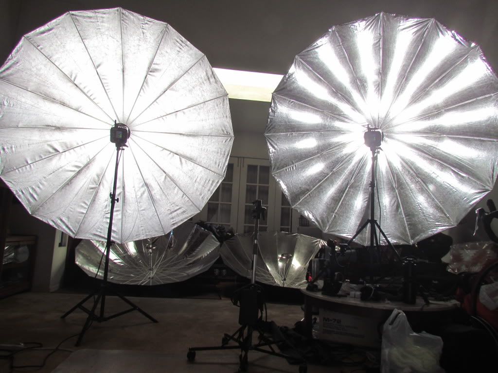

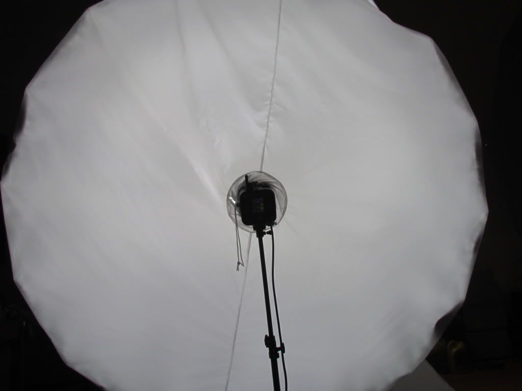

Nov 26, 2011 10:24 |  #14
IMAGE: http://i62.photobucket.com/albums/h120/c2thew/PLM%20v2/Plm%20soft%20extreme%20and%20v1%2086%20silver%20comparison/IMG_0918.jpg
IMAGE: http://i62.photobucket.com/albums/h120/c2thew/PLM%20v2/Plm%20soft%20extreme%20and%20v1%2086%20silver%20comparison/IMG_0946.jpg
need anymore samples?
